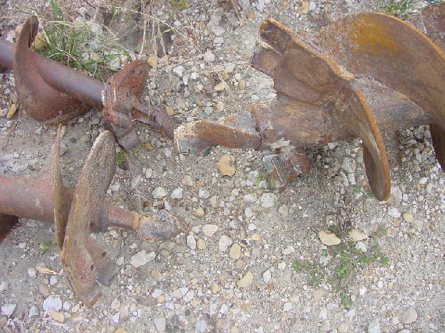

Here is a picture of some augers with the pengo system. The two on the left are my old ones for the Little Beaver Hydraulic. I don't know if you can make it out but both of those fishtails (pilots) are severely worn except for where the carbide chips are. Another thing about those is the teeth have been modified.
I picked up the teeth and found them to not be as aggressive in attitude as I like when the clay is dry and harder than a bad girl's heart. So I put them in the forge and when they were plenty warm I gently curved them down. I was very lucky in the first attempt was successful and made a big difference. They now have attitude.
The auger on the right is my weld up and with one of those special fishtails I mentioned. I use this auger for post holes and some piers for brick columns. It will dig in the limestone but it's slow. In wet clay I have to hold it up or it will bite off more than any of us can chew.
When I was a young man working with my dad fencing I learned a very important lesson about power diggers. Then we used two man Groundhogs, similar to the two man Generals you can rent. I noticed that when the ground was dry we could have two men pushing down on the handles and a third man standing on top of the handles for down pressure and the smoke would just boil out of the hole. But it wouldn't dig much. We could pull the auger out of the hole and look at the fishtail and see just about a quarter on an inch wore off the corners. Change out the fishtail for a new one and it would dig like it should.
I've been working around farmers or such and they have a PTO post hole digger with a man hanging on to a piece of pipe out off to one side to get it to dig. I've stopped them. Cut a piece of bucket edge or grader blade. Weld it to the business end of their auger and watch it dig like it should. Most folks just don't seem to get it that the auger is like a drill bit. A sharp one will make it easy. A dull one will make you wanna get a divorce even if you're not even married or even thinking about it.

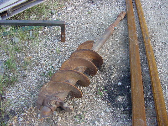

Here's another picture of the twelve inch auger. The kit gave me a thirty inch long piece of pipe. I tossed it and replaced it with one sixty inches long.
If you can see it I've got a piece of two inch hex that fits inside the pipe so I can shorten or lengthen the auger as required.
It's a simple modification but I feel an important one.
The same extension goes into the sixteen inch auger.
That allows me to go twelve feet deep when I bury the auger motor into the hole until the frame of the quick attach stops us.
