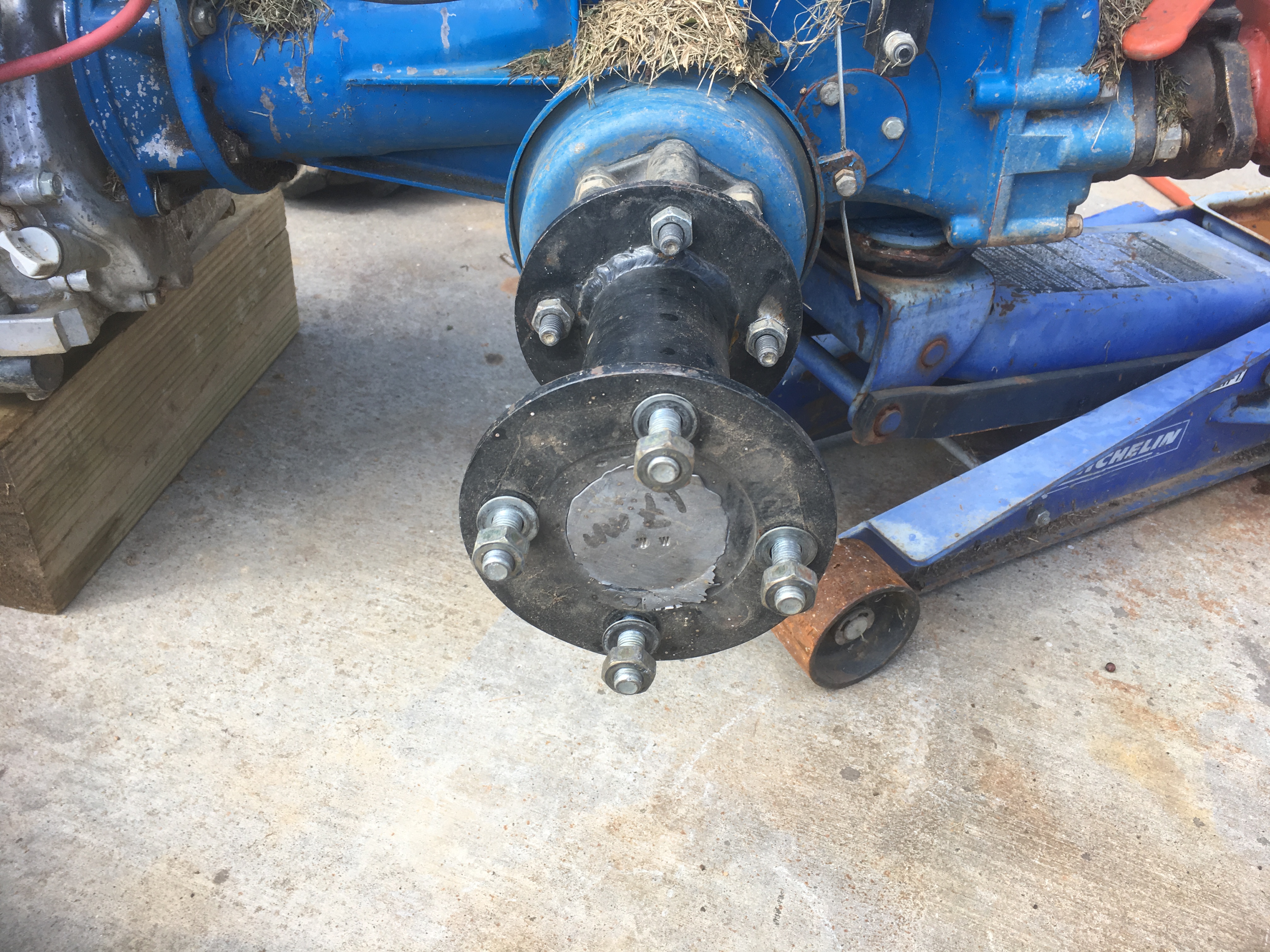

Dug a few potatoes just before Irma's rain. BCS 850, potato/root crop plow. Spread the wheels out with a 2 1/2" and 6" extension on each side. Used 40lbs of barbell weight each side, tires are foam filled, 25 lbs each, and the 6" extensions are filled with 8 lbs of lead each. Did a great job, but probably needed all the weight, digging deep with a fairly heavy weed load.

I like those wheel extensions!

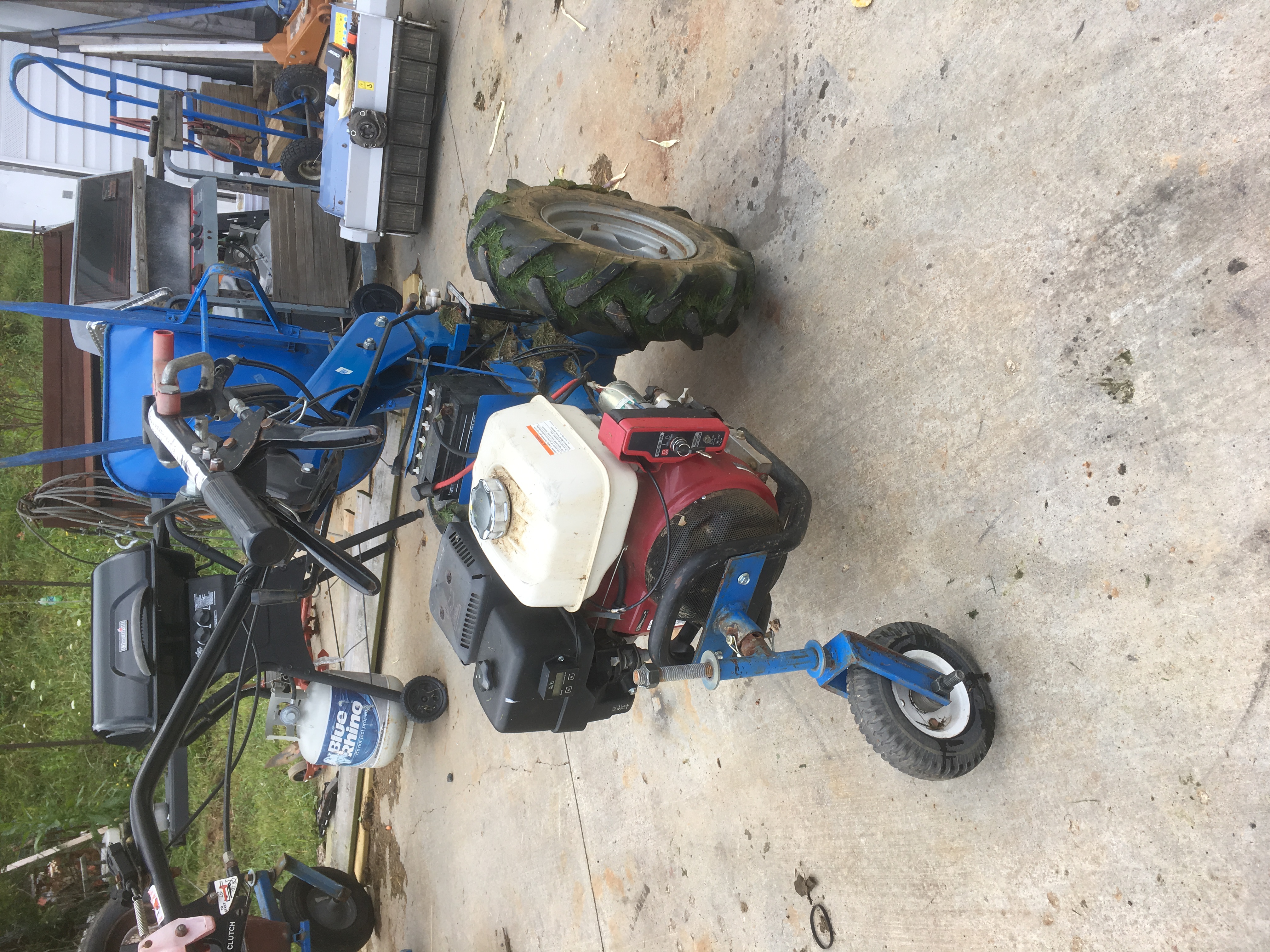

Totally off topic but what do you use the 'quick hitch' on the front for? (if that's what it is).

The quick hitch on front is for a caster wheel to help when moving the tractor with no implement.I'll try to get a picture. I also use it to attach about 30 lbs of barbell weights to offset the double rotary plow.

IMG_0627.JPG Here is my version of a front caster, copied the idea from some else here. I need to make some corrections,I have too much slop in the connection, the wheel doesn't track like I want, tends to catch on the motor guard. but it really does help transport and hooking up implements. Adjustment will be a winter project. Not real sure why BCS doesn't make it as an accessory, but I would probably try to build it anyway.
