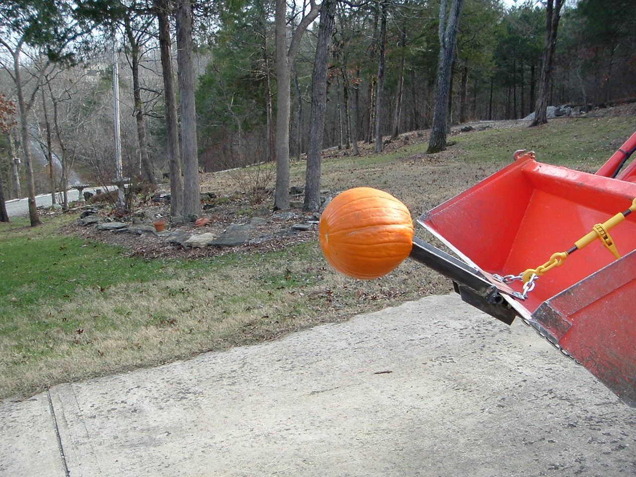

I built my own. It will easily dig a foot deep even in rocky soil.
https://www.tractorbynet.com/forums...vel-ready-project.html?highlight=shovel+ready
This thread goes thru the development and improvement of my shovel. I have used it for several years now.
