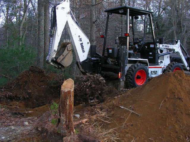

I am a newbie an this is my first post.

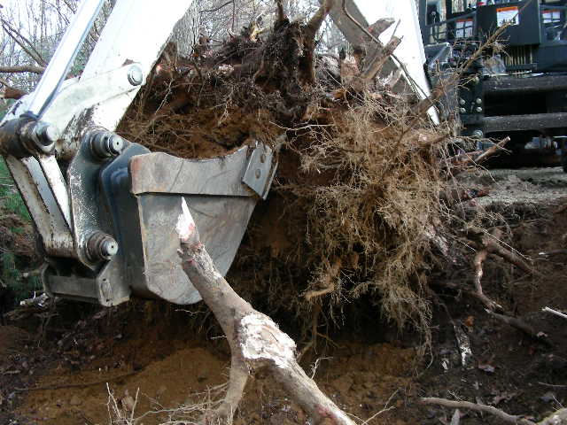

I have a Bobcat B250 and did some stump digging today. Let me see if I can post a pic:

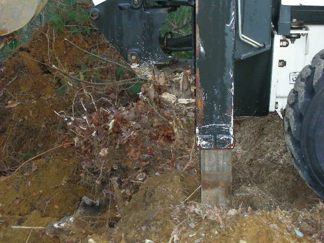

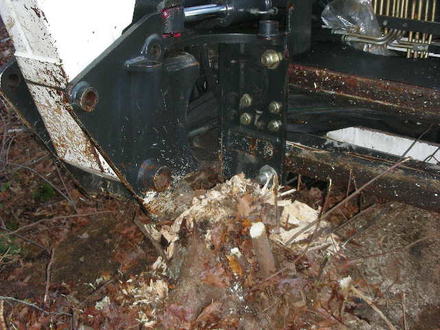

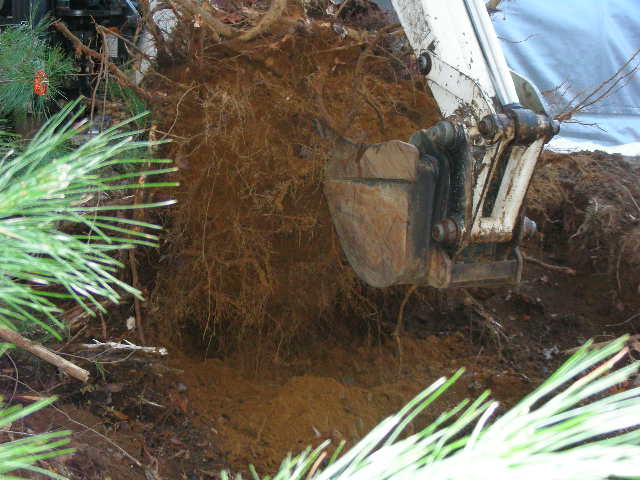

I think that worked. I high centered the backhoe on the stump, maybe a pic:

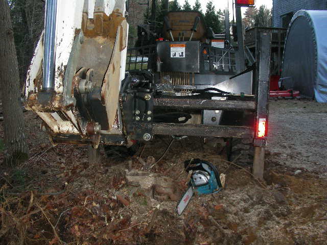

Cut the stump down

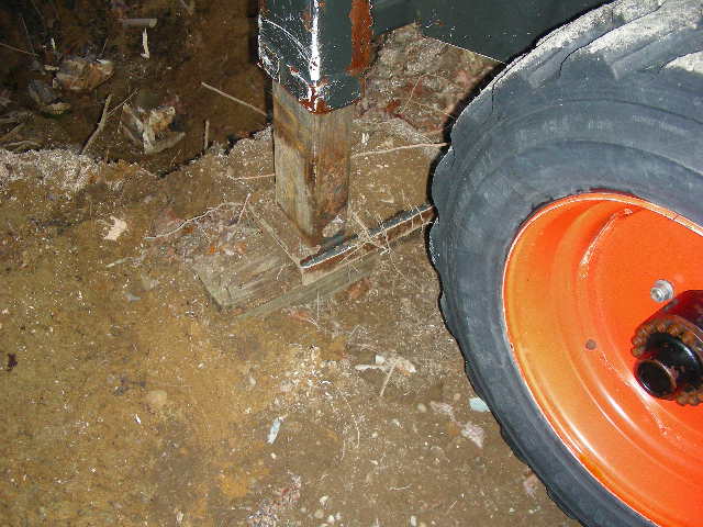

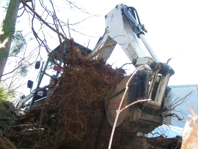

Still high centered on stump:
Put some timber under the stabilizers and some 2X12's under the back wheels and we were good to go.

What is the purpose of getting over the stump? I usually reach over the stump with the hoe itself.

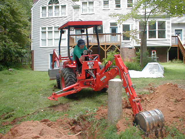

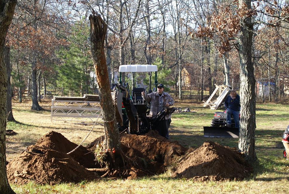

Welcome! Yeah, stump removal is a little trial and error depending on the size of the stump, tree type, machine size, and most importantly skill and experiance. Here I am taking one out with me B21 (21 hp frame mount TLB). My avatar pix came from this same day.

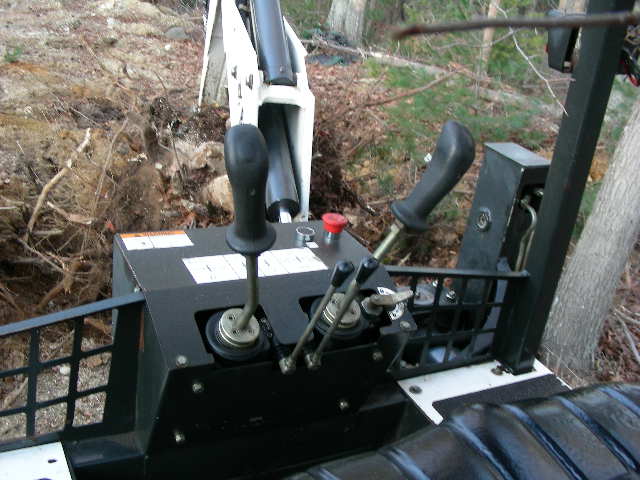

Ok, lets try the pix this time... deleting seems to be odd, if you delete and then re-post with the same text it doesn't always work. Anyway, here's the pix.

If I had been stuck on the stump like you were I would have raised my loader a few inches and used the backhoe to lift and push the tractor forward off the stump. It is a pretty common move for inching forward while digging ditches. You may want to try it on safe ground and see how it works with your tractor.
