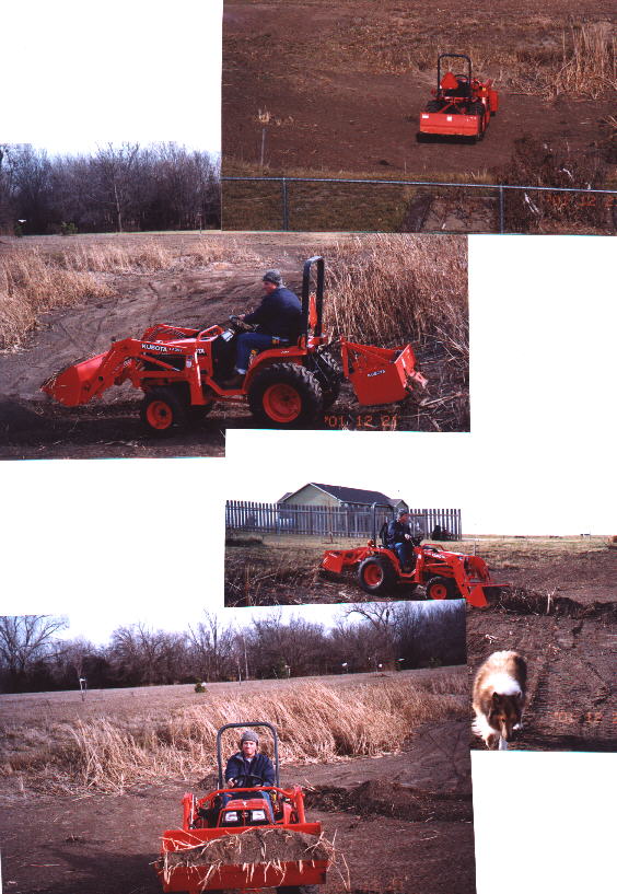

   / digging with FEL? #9
Roy, that is what I do--remove the MMM for dirt work. I have found that sometimes I use my boxblade with rippers down to tear and loosen the ground--then I go at it with the FEL. I will tear up a section and then bulldoze a pile with the boxblade in reverse. When I have several piles---I push them together in a line and then I start scooping with the FEL. The attached photos show the tractor sitting beside a line of dirt pushed up with the boxblade, then I turn around and scoop them in the following photos and the voila'---a full bucket everytime. A tractor without a box is like a one legged man---a cripple (excuse me--numerically appendage challenged). The Box rocks!
J
