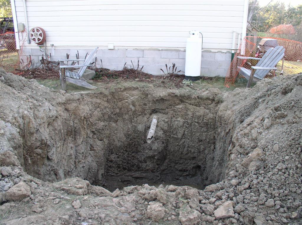

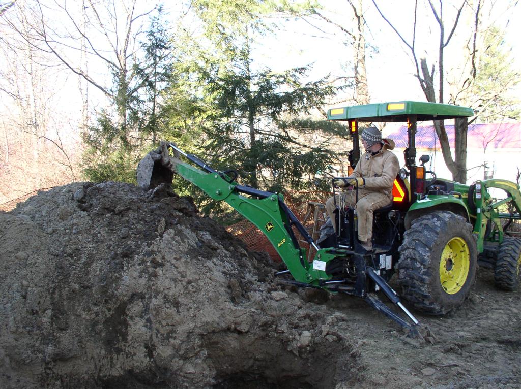

My son found the septic tank by parking the car above it.
It looked to be about 300 gallons, and not in the best of shape.
Here's a couple of images of excavating for the new tank with my 4120/448.
The excavation is about 6 1/2 feet deep.
I had to reposition a few times due to the depth of the hole, but had no other isssues to contend with. Now I'm off to get some stone and order the tank.

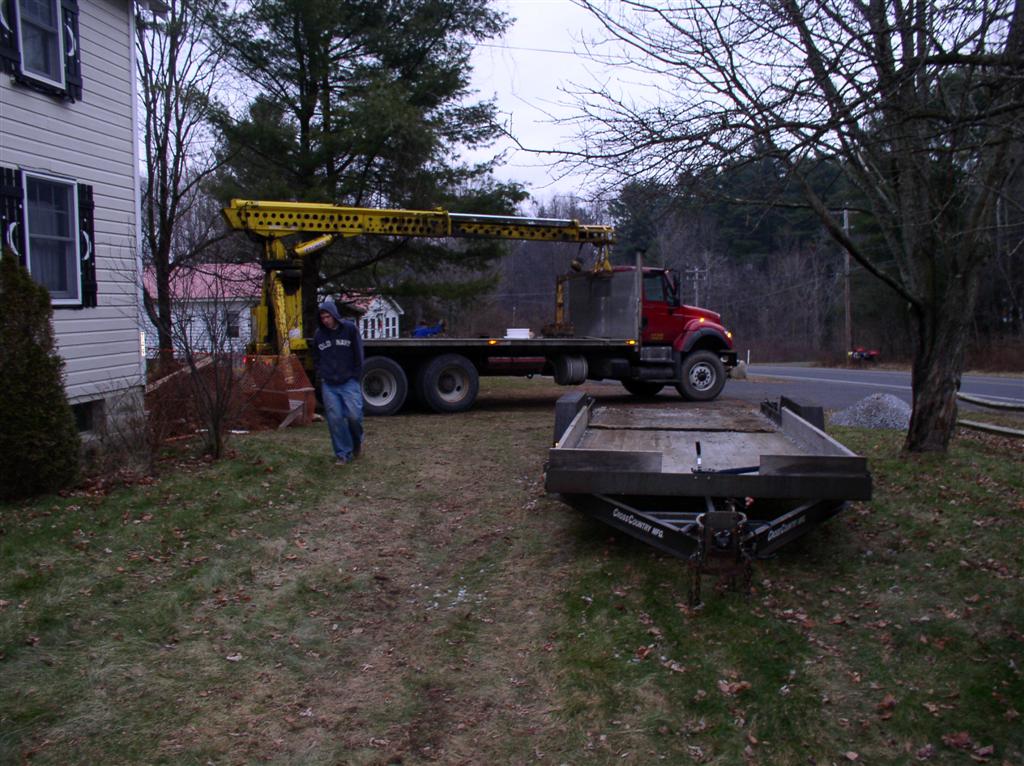

   / Digging with my 448 backhoe- Pics
#9

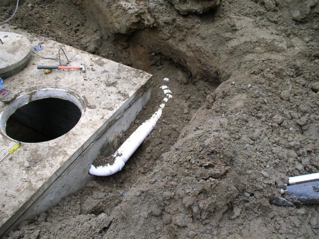

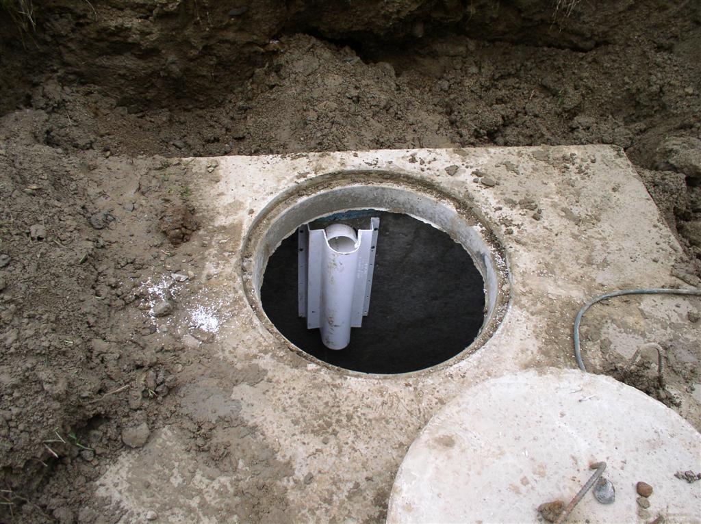

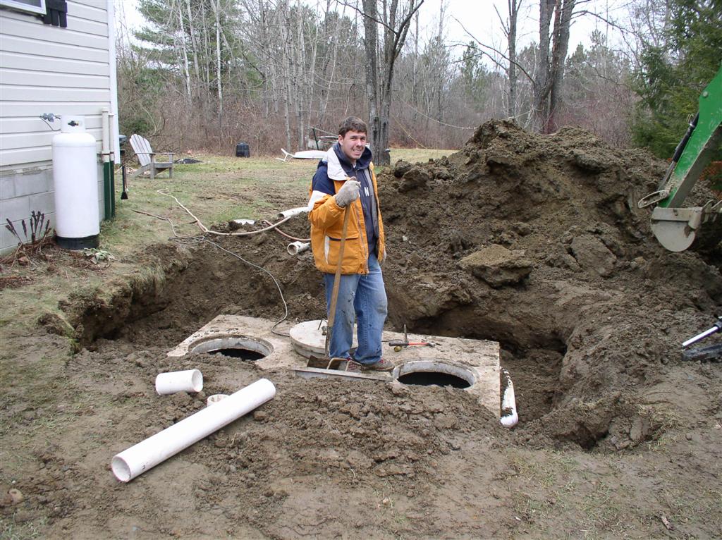

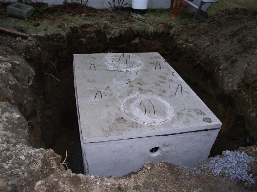

A few more pictures.
Setting of the tank, hookup and backfill.
The supplier drops the tank in the prepared excavation via the truck mounted crane. He was in and out in under a half hour.
Nice job said he. Told us that most guys won't bring in either sand or gravel, they level out whatever soil is there- rocks, boulders, whatever. Also said that he's set tanks in holes with three feet of water in them and thet have to pump water in the tanks just to sink them!
Jon
