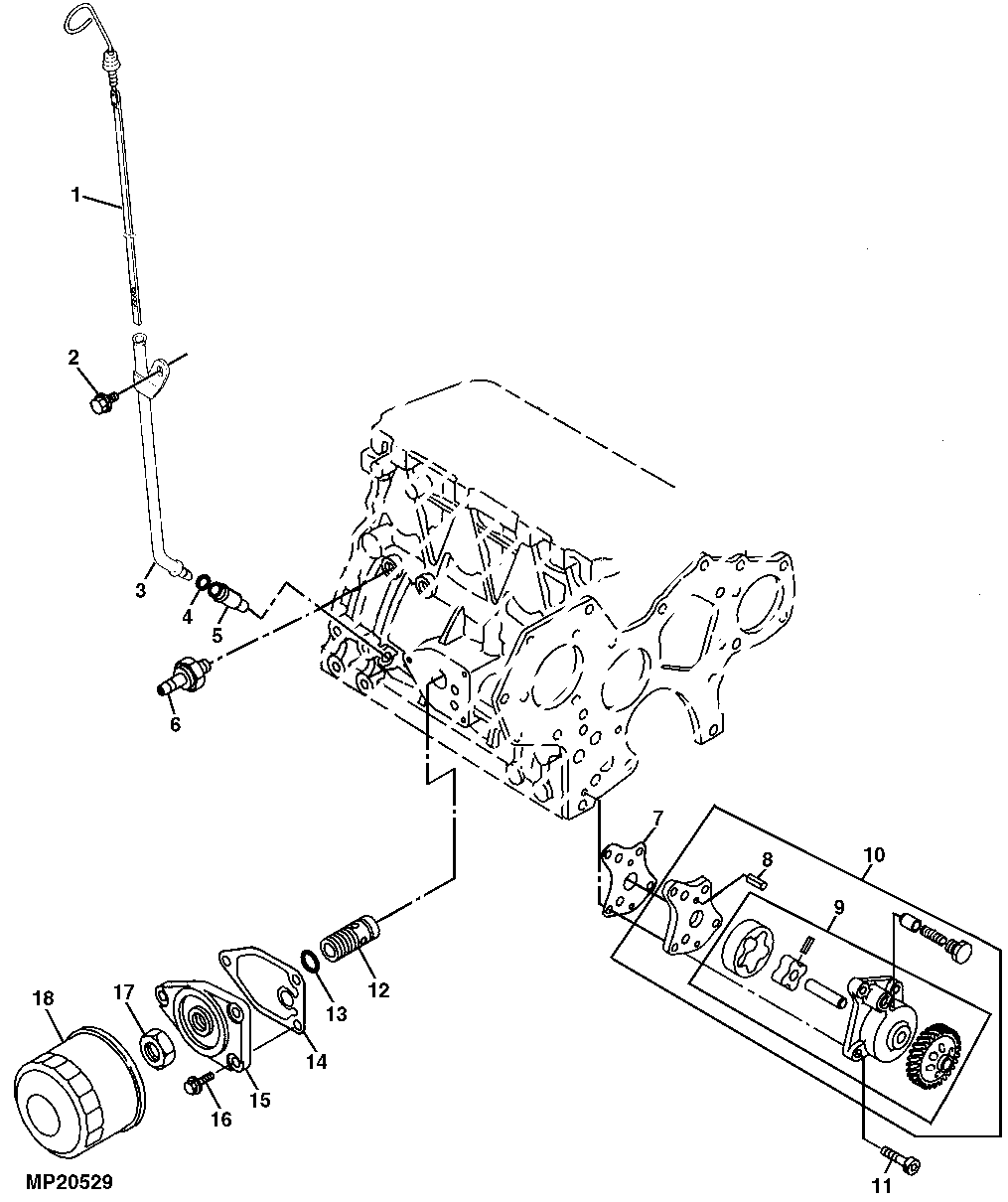

I recentlybought a used JD790 with the 82 Cu Inch Diesel, for the life of me I cannot locate the dip stick. I have a manual and it shows on the side of the engine oposite the exhaust manual protruding up alongside the engine side cowling but it is not there? Any ideas??:confused:
   / Dip Stick location on 05 JD790 #2
Should be just to the left of the oil filter...
   / Dip Stick location on 05 JD790 #3
It's a bugger to see no doubt, just wait till you have to reinsert it.
I can get a pic if ya need.
