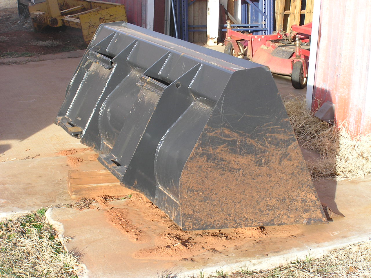

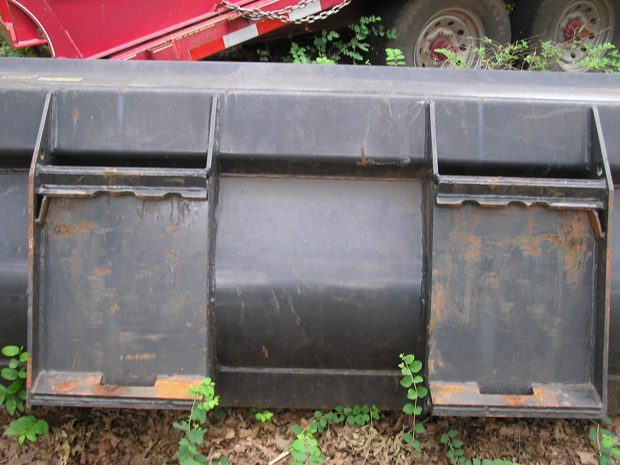

Do you have the specifications for the bucket that comes with it? If you can get the part number, you can do a search for availability.
Bobcat made a special bucket (PN A85M000130) for the smaller V417, 1 cubic yard, but only 72 inches wide:

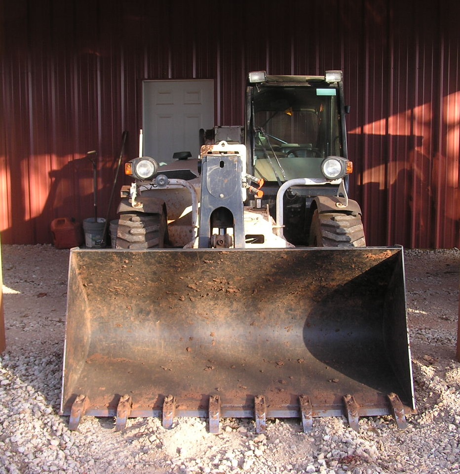

Thank you for putting me onto this. I went to the web site and looked under "telehandler buckets". They have two, the 72" one you mentioned and another 80" one. Interestingly, they are listed as being the same capacity... which makes absolutely zero sense, since the 80" one is larger in every dimension... By my calculation it should be 10% higher capacity.
Anyhow, given the higher capacity, I was thinking about getting the 80" one instead of the 84" inch HD I was looking at. It's actually 80.8 inches wide, which makes it about 1 inch narrower than the wheel width on the v519. Thoughts?
   / Dirt bucket and a land-leveler, vs 4 in 1 bucket... #10
I think the capacity being about the same is due to the difference in the shape of the buckets.

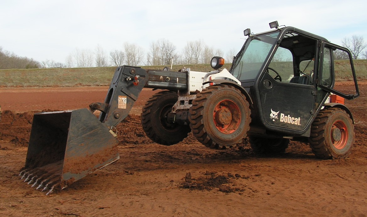

Here is what I think is the 80" on a V519:

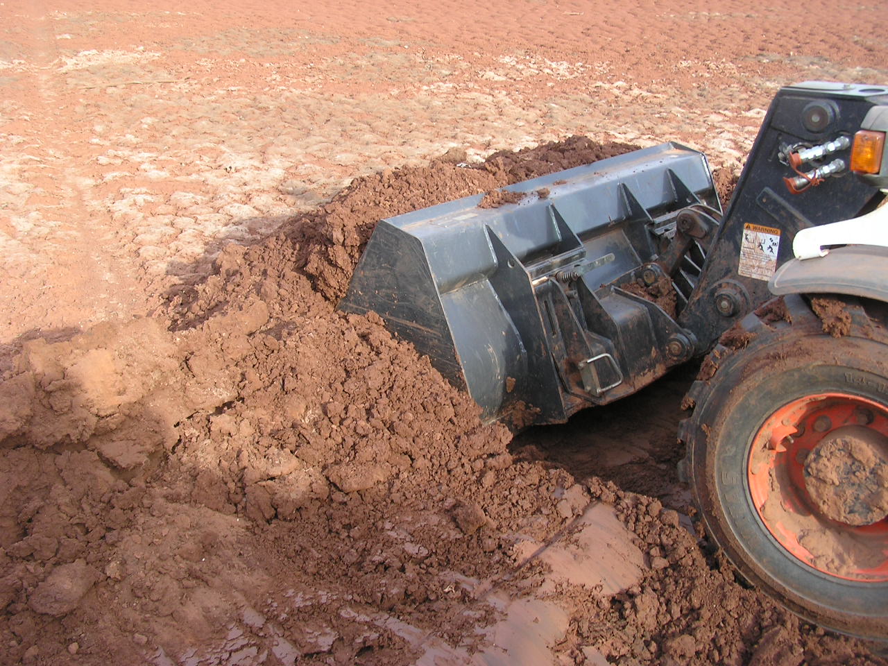

And the 72" on my V417:
I recommend the 80", my 72" is slightly narrower than the tires, but it hasn't caused any problems filling the bucket:
