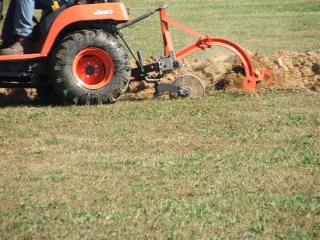

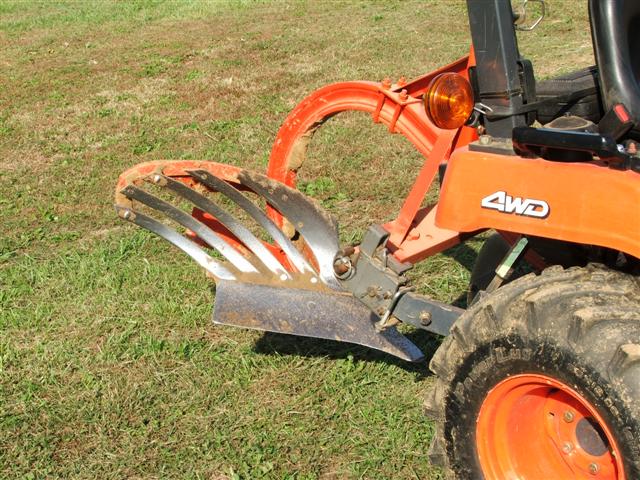

I use a single 12" plow, but I have filled ag tires and I get along just fine, does work good with a depth wheel. I have a disc, but I like the 4' tiller better to finish it with.

Milkman that's a nice looking plow, What kind is it? Is a an old one painted or can I get one like that today. I know the plows at tractor supply aren't like that.
I was thinking of getting a plow instead of a tiller. We just have a small 30x50
garden.

Waxman, it's from an Allis Chalmers B and I cut the beam and added the TPH, I'll find a link to some other thread and post it here so Stonycreek can see it too if he's interested.
Here's the first thread if it will still work.
http://www.tractorbynet.com/forums/attachments/66147-plow.html
Nice job Milkman, You did and excellent job. You really have a nice classic plow there, I new it was too good to be something you can buy today. Looks like it works well too!

I have since the earlier thread put a depth wheel on the plow and it is easier to regulate the depth since I don't have position control. When I plow the garden this spring, I'll try to get some video and post on youtube and link it here.
