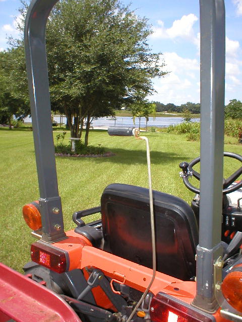

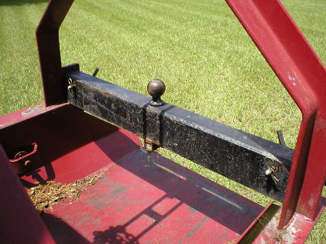

Bought a digital camera yesterday. Thought I would post a few pics of a TSC dirt scoop with a couple of additions.
The dirt scoop is my default 3pt implement. I am always in need of moving a trailer around my property. I designed a simple hitch that utilizes the rear facing pins on the scoop.
I also quickly tired of the "rope to dump" arrangement and fabricated a dump lever that I can reach from my seat.

Another angle

Mike, is the "dump lever" truly work like a lever??? ie. do you push or pull it forward or backwards, or do you, like the old tire rope, pull it up?
   / Dirt Scoop Customization
I push it backwards. With a heavy load I will lower the scoop first to take the pressure off the trip arm.
I found a steel rod laying around the barn and put it in the vise to create the proper bends. The handle is off a fence for a table saw I use infrequently.
