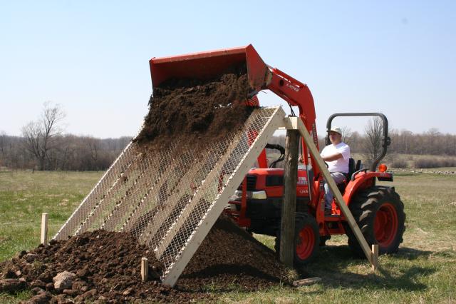

Here is a photo of a screen I built a few years ago. I have screened a few hundred yards of top soil. It will not screen smaller rocks under 1" in size. I did break one of the 2x6's but other than that it has held up well. The only problem is I must clean the debris in front of screen often. Took only an hour or so to build. I attached the screen to the frame with fencing staples. I used heavy duty chain link fence for the screen.

I think you will find that chicken wire flexes too much and will hold too much trash due to the large holes.

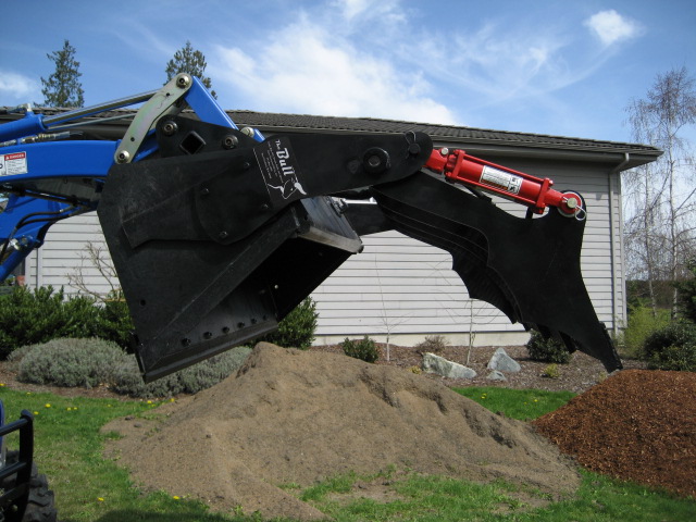

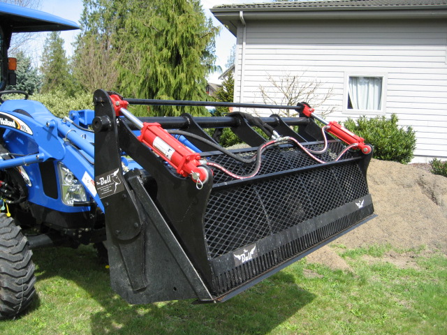

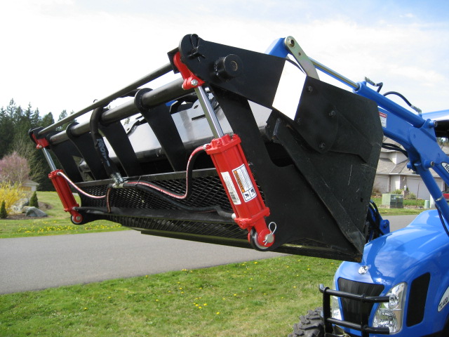

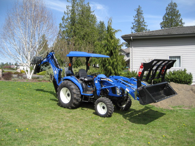

I have a screen that's part of my grapple and keeps rocks/stones bigger than about 3/4" in the bucket when dumping with the grapple closed. I've found it useful for just keeping a lid on the bucket with a mouthful and not worrying about spillage if I have to travel any distance with the load. The only down side to it is if you take a full bucket of moist dirt or clay, then you don't have enough space for the flow to start separating the rocks. A couple of times using it and you get it just right and it's quick. There's several other uses for it as well, but for your purposes, it'd work great for screening/sifting.
Of course, a setup like Luremaker's is much more economical.
