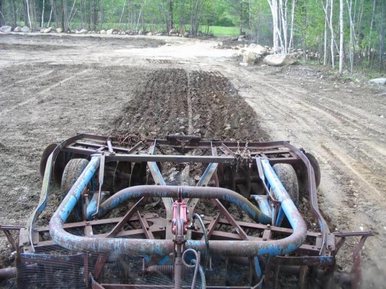

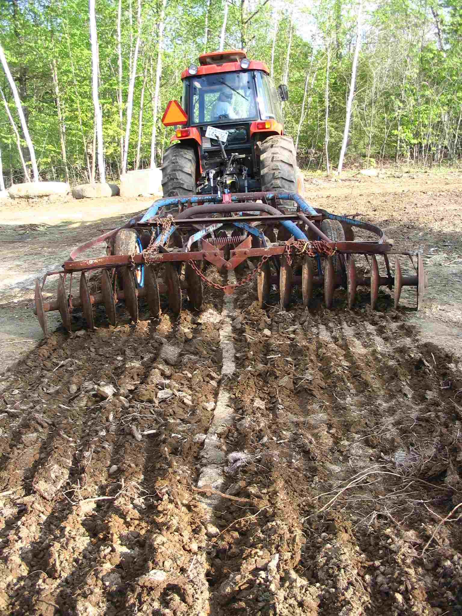

i don't think you're going to have any trouble with either a 7/8' harrow. like TwinWillows said, soil condition will determine what you can pull. i've attached a pic of my DK55 pulling a transport harrow (think it's 10'.. never measured it).
pf
