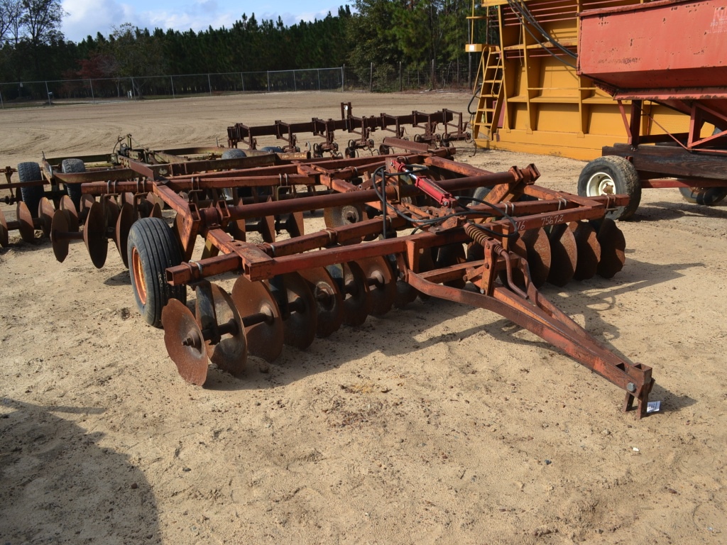

New Holland TN85A
Can anyone help me identify the make and model of this disc harrow? Additionally, I have clay soil and need some scrapers for this harrow. Should I sell it and get one with scrapers on it or do you have suggestions for scrapers or for something that will take its place?
Thanks!

Don't know that disc but large wire tied loose in a loop around the frame and axle works almost as good as a scraper, but remember don't work clay soil wet or you will deal with clods all year.

It looks to be a Bush hog, but not sure. I have a Bush hog parts book and will look it up.

Looks a lot like my Minneapolis Moline KS-1300 wheel disc that actually was made by Krause. The square tube frame and hydraulics look nearly identical to my disc, but the hitch is a little different. Krause made discs for many tractor manufacturers who slapped their names and model numbers onto the units.
