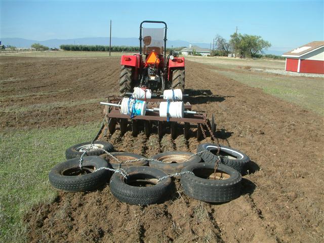

Add weight.
I use four weights about 120 lb each with my 7-ft offset disc behind my Mahindra 5525.
An offset disc (two axles in a V-configuration) is a primary tillage implement for use on unplowed ground.
A tandem disc (4 axles in an X-configuration) is a secondary tillage implement for use on plowed ground to break up the clods.
Good luck

his 3616 wont have the weight to the ground like that 25series to pull an offset... like the rig though :thumbsup:

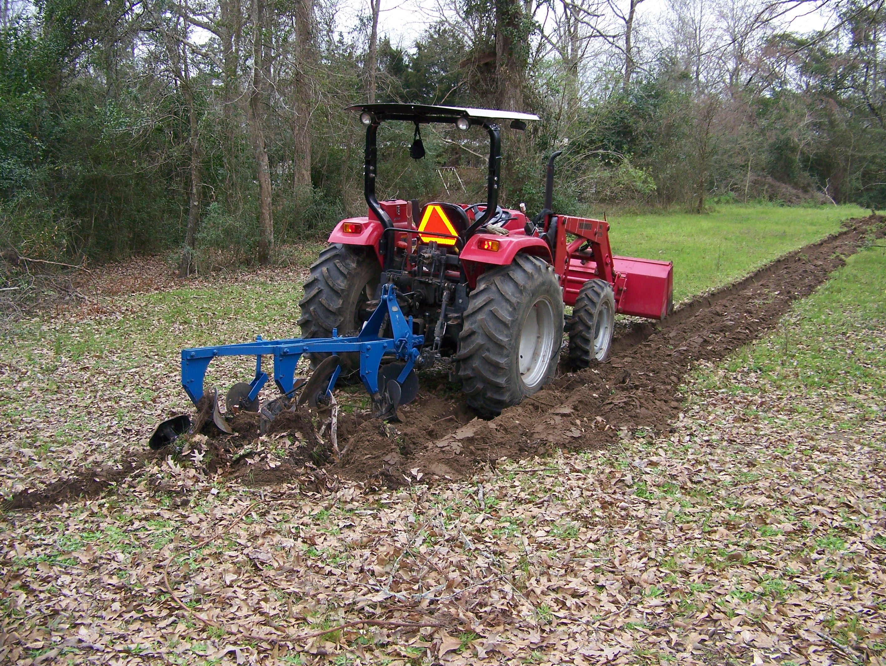

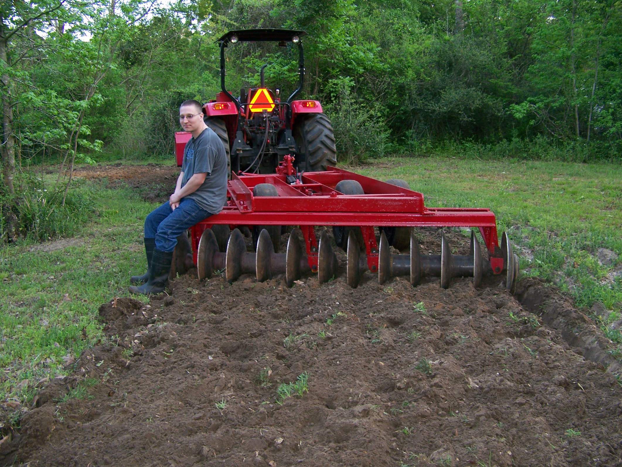

I found that out after I bought my 3 bottom Ford 101 turning plow.Ford Plow Pretty.jpg I didn't need it with my 3,000 pound 9 foot offset Amco disc.4-6-13 Luke and Disc in Dirt.jpg
