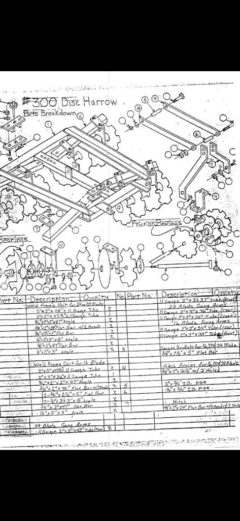

I recently purchased an Atlas 300 disc Harrow ( Photo attachd) to help install winter food plots for the winter. I paid $500, I hope thats a fair price. This is probably a supid question but I would rather be safe than sorry. My main question is regarding maintinance. This harrow has probably set for awhile and I do not see any grease zerts. I looked up the parts catilague and is does say there are friction bearings. Do I need to do anything to these before I hook up the disc?

That looks to be an exact duplicate of my Land Pride 1048. Mine has sealed bearings. I've never had to do any maintenance on the unit.
I guess - if one of the disks quit turning - tear it down and free up or replace a bearing. I've had my disk harrow for over 35 years.

I am not sure what is a friction bearings, but unless they are sealed bearings they need grease, sometime they have a cap where the grease fitting should be you need to remove the cap and screw in the grease fitting. If they are sealed then only oil the adjustment screws on top and moving joints and that's it.

Friction bearings require lubrication. Just find out what is the recommended oil.
They are very durable if you keep the dirt knocked of after using your implement.
That would be the time to lubricate, so the oil has time to do its work. You stated that there are no zerks.

According to the diagram, it looks like the bearings are probably 3 piece, 2 stamped bearing holders, and the actual bearing itself. You should be able to take one of them apart, assuming it's two half shells bolted together, and look at the bearing itself. It very well maybe a sealed bearing,
