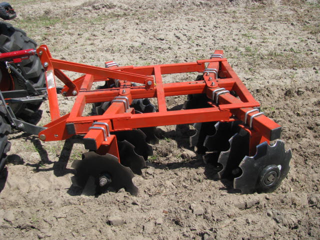

Howse DLHT is a box frame 16/18 disc harrow, meaning 16 discs, each 18" in diameter. It cuts a swath nominally 5'6" in width, adjustable by moving the disc hangers. Howse, Land Pride, ETA and Tufline box frame discs referenced in this post are spec'ed as 16/18, 5 to 5'6" wide for consistency. Most manufactures also offer a 20/18 option.
Howse conservatively describes the DLHT series as MEDIUM DUTY. The Howse DLHT16822B weighs 587 pounds. It has a 1" axle on sealed flange bearings. I paid $950 delivered. (No sales tax in Florida on ag or forestry equipment.)

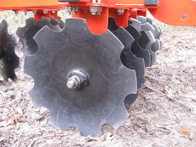

Disc harrows come with two types of discs: notched and smooth. Notched discs cut pasture grass and crop stubble better; in open soil notched blades jerk out trash, meaning vines and tree roots, which often stick in the notches. If you have a load of rocks in your soil, bear in mind notched discs deform easier than solid/smooth discs. The Howse DLHT ships with notched discs front and rear, good for my conditions and objectives.
Discs for compact tractor harrows come in 16"-18"-20" diameter. The issues with diameter are concavity, wear and lift. Smaller diameter discs have less concavity (less "float") than larger discs, so they cut deeper. Larger diameter discs will wear longer before needing replacement and, with greater concavity, move more soil laterally. Discs of larger diameter require more lift from the three point hitch. A disc harrow heavier than the Howse DLHT may have thicker, heavier discs.

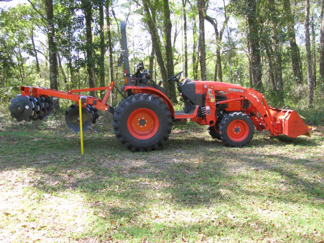

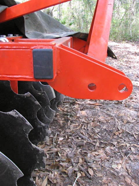

The Howse has a dropped double clevis to receive the draw pins. On a compact tractor a dropped clevis is nice; it allows the 3-Pt. to lift the harrow sooner. Note pictures showing harrow in the air. Minimum disc height above ground is 14-1/2". I prefer a wide double clevis to accept draw pins. The TSC Countyline has "open" draw pins attached to the harrow frame; in a "normal", undropped position. The Land Pride DH1560 has dropped "open" draw pins. The Howse, with its wide, dropped, double clevis is the easiest implement I own to mount in the 3-Pt.

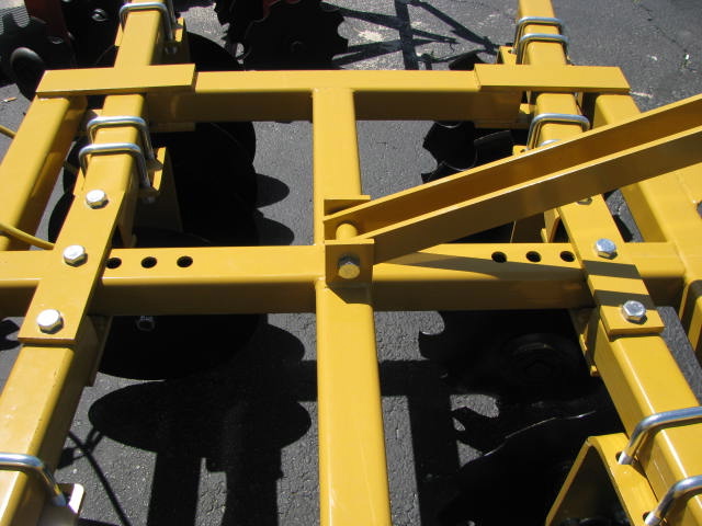

The local Tractor Supply Company (TSC) sells a seven foot wide, box frame 20/18 Countyline disc, manufactured by Tarter, of similar design to the Howse, as HEAVY DUTY. Tarter's Heavy Duty description is perhaps "trade puffery". (Tarter/TSC disc in three photos is 7' width.)

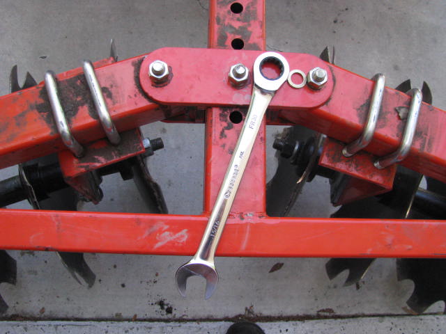

The Howse and TSC Countyline/Tarter harrows have same system of gang adjustments, but the Howse has five adjustment holes, the TSC four. Both have three through bolts/nuts clamping upper and lower adjustment plates, which have two rib guides on the top plate mirrored by two rib guides on the bottom plate. To adjust the gang angles, the two outer bolts/nuts are loosened, the center bolt removed, then the gang is pulled and jiggled to line up holes in sliding adjustment plates with fixed holes in harrow frame, using gang lenghth for leverage. The center bolt is replaced and all three bolts/nuts tightened. {Loosening/replacing bolts/nuts is a time consuming process.} I have applied wax lube to the harrow frame over which the adjustment plates slide. Right now, new, it adjusts pretty easily. I understand with use, rust, dust, deformity, etc., gang adjustment becomes harder. However, I expect to settle on a 'default' setting soon and only change the gang angles infrequently thereafter. Photo #5: Currently the front gang is set one hold forward from "flat", the rear gang is set all the way back, as "flat" as allowed but still at a shallow angle.
Some TBN threads suggest substituting a 5" pin as a pivot in lieu of the center bolt. With only a center pin, it seems possible the center support could "jump" the guides; stay with the center bolt and nut.
Relative to the TSC, the Howse is a slightly simplified/KISS design, its parts more precisely cut, welded and finished.

I pull the Howse behind a Kubota B3300SU tractor/loader ( 33-hp / 1,900 pounds / 4-WD / 58" tire width ) Tractor and DLHT disc are a good match.
It is important to tighten the four axle nuts regularly on a new disc harrow; they loosen. My Howse vender told me that if the axle nuts are tightened regularly the entire gang assembly settles in eventually and thereafter axle nuts require tightening infrequently. As an experiment I have replaced OEM split ring lock washers on left side with Swedish Nord-Lock anti-virbration lock washers. (See Photo #4) The right side is OEM stock. I will report results. A secondary test for tightness involves "ringing" the discs with a mallet when the harrow is elevated above soil. A loose disc will give off a flat tone.
If axle bolt is not kept tight, disc hubs and axle will work each other, ruining one or both.
After around 20 hours pulling the Howse its ground engagement has been completely satisfactory.
