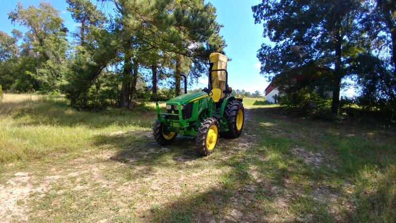

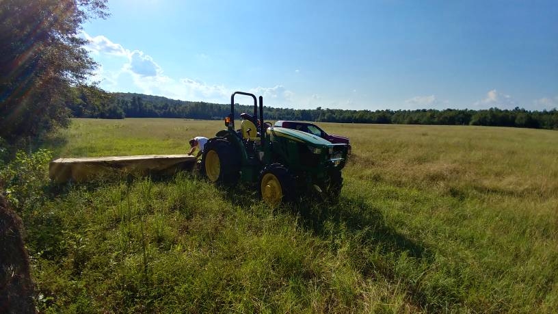

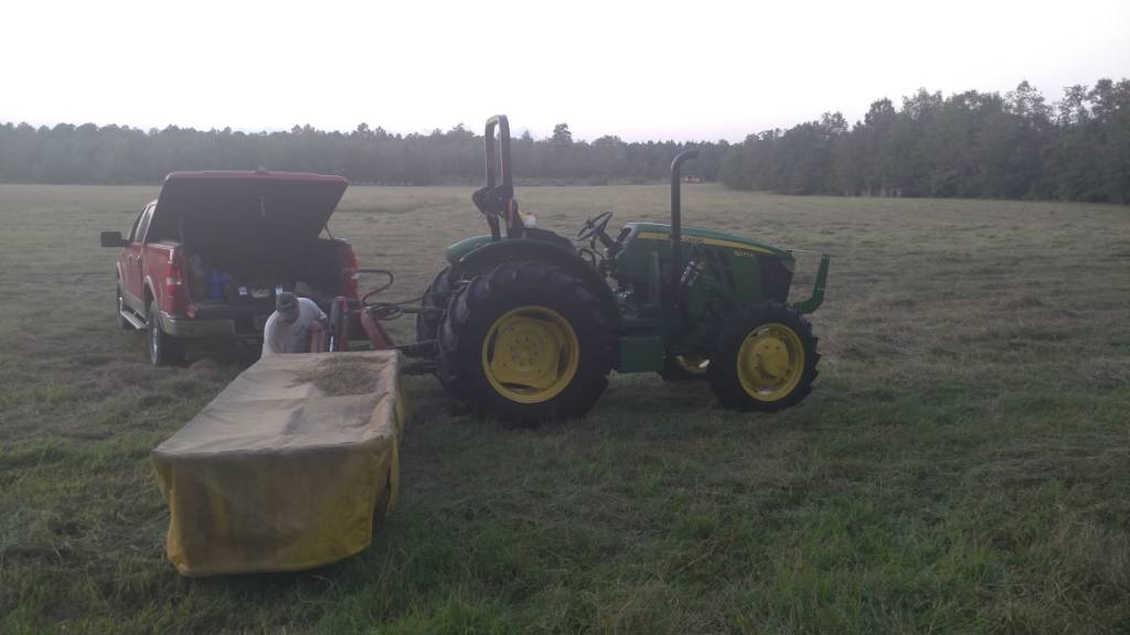

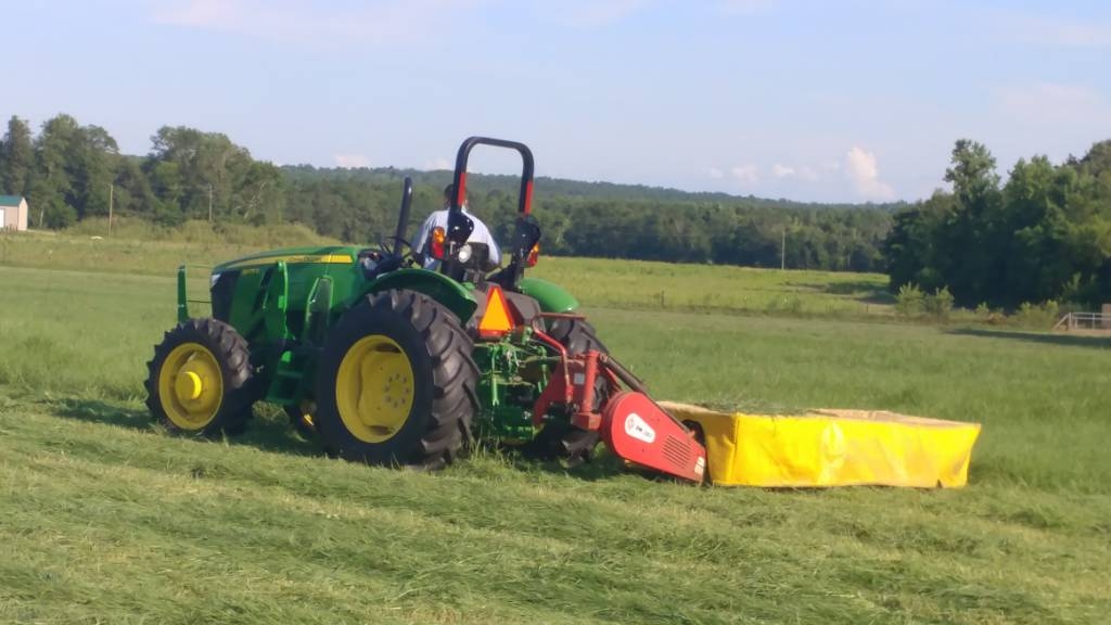

We used 60 HP Farmtrac 665's to operate a Gribaldi & Salvia DM207 for years. This is a 9.5' disc mower. My 5075E had 0 issues with it. I would even take the FEL off for an easier to maneuver, and less bounce ride in the bumpy fields. Unless you just get reckless l, hauling butt on bumpy ground, the mower's weight wasn't too much for the chassis to safely manage. A M7060 should have no problem with the typical 9' disc mower. Allow me to picture hwore for you.
We now use a drum mower as that disc mower got old and worn, we don't farm grass as much as we used to, disc mowers are expensive to buy and up keep in comparison to drum mowers. They are more complex than drum mowers, require more maintenance than a drum mower, are easier to damage than drum mowers, and while disc mowers usually cut a wider swath, generally speaking you have to run them in a lower gear, at lower speeds, so even at an extra 3.5' over the drum mower, the disc mower only saves around 30 minutes cutting 20+ acres.
