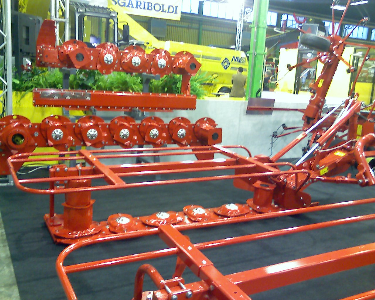

Seems to be some news that First Choice is changing disc mower manufacturers. Look for them to use the lighter Galfre' design pictured in the attachment. What will this mean about parts for the older Fort mowers? Will FC still carry the Fort machines?
