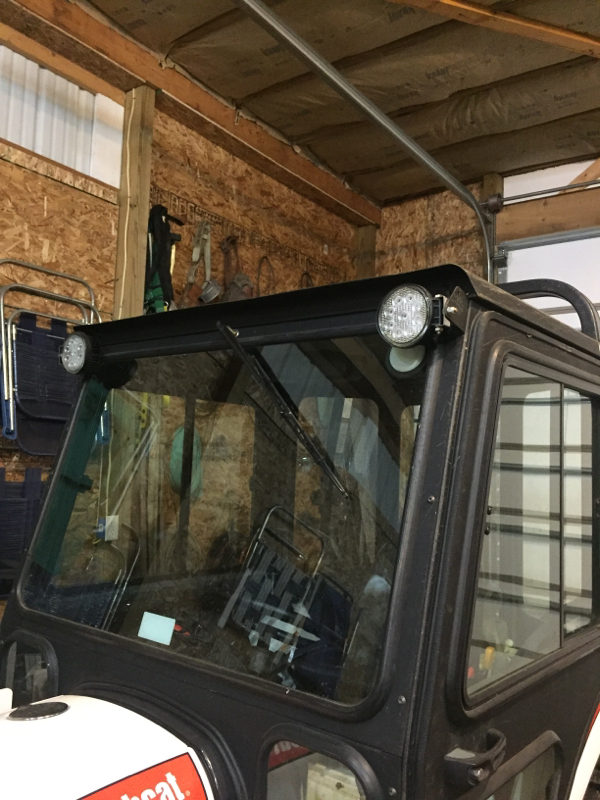

Well first off the cab is basically a steel cab with normal size pieces of glass for windows. I really like this design and it makes the cab very durable and easy to replace a piece of glass if you break one. "Haven't done that yet but knock on wood" I think that is important for someone like me that is always getting too close to low hanging branches. Factory cab glass with its curvature is crazy expensive if you break a door or something. The mirrors that I had protrude out from the sides of the cab with metal brackets. The first time you get too close to something the mirrors the first thing to get hit. I don't think they lasted more than a month for me.

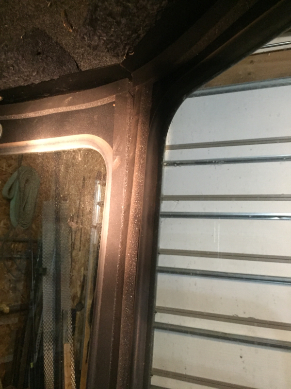

For soundproofing I did many things. Firstly I under coded inside the of the wheel wells and added some of that rubberized stick on flashing tape underneath the seat in any area I could get to under there. I also put a whole bunch of approximately three-quarter inch thick by three-quarter inch wide foam weatherstripping. I ran it up the metal on the inside around The windows anywhere I could. This really seem to help quite a bit for me. And it's black also so if I didn't show you it was there you never even notice it. I cut a piece of carpet for the floor I stuffed a bunch of foam pieces in any openings in the cab toward the engine compartment and up under the dash. And I added a bunch of 12" x 12" denim soundproof panels in places like behind the seat under the seat folded some and stuck them up in the top area of the cab close to my head that also seemed to help a bit. But honestly the thing that I think would help the very most that I have not done yet would be to lay indoor outdoor carpet over the fenders. I think that's where the majority of the sound is entering from.
I bought a decibel meter app for my phone and would try different things using that meter. But installing the carpet before you install the cab or undercoat would be the easiest and I think it would really help so do consider it. I remove the foam,floor carpet, and denim panels when I remove the doors in the summer.

Snapped A couple of pictures of my cab for you. First one is of the weatherstripping I was talking about.

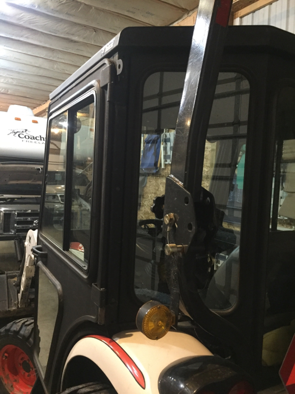

Second one is turn signal mount. I decided to leave mine in the stock location. I'm sure I would've ripped them off if I would've melted them higher up where they recommend.
And finally I use the brackets that came with the exterior mirrors to mount these LED lights
