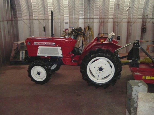

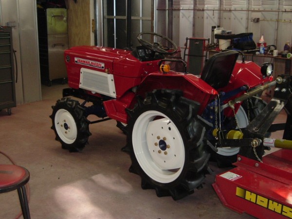

On my 1601D that I just completed, I found that the new 48" Howse brushhog was a little heavy. Even with short lift arms you could stand on the back and bounce the front end off the ground. I did not want to hang weight on the front end.
I pulled the four 3/4" bolts off the tower (to the center link), reversed the tower and brought the pins in 6" closer to the tractor. Man what a difference. Just by moving the center of gravity, 3 of us can jump on it and it will not budge (off the ground).
Maybe, many have already discovered this, and maybe I should have posted it somewhere else.....But this is a Yanmar improvement I couldn't resist sharing here.

Here are Mark's pics
   / Discovered Neat Trick #9
Pic#2
(lightened)
I edited it to show Mark a 3rd trick
