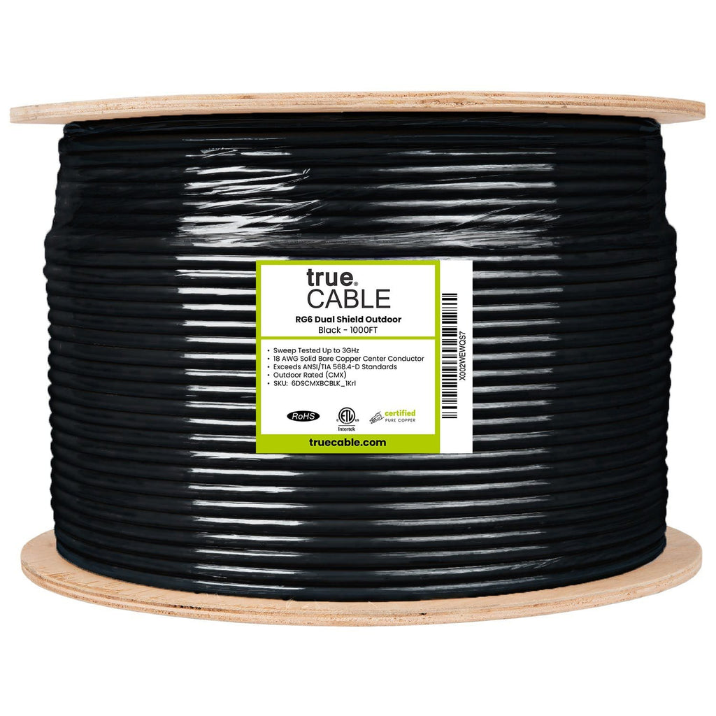

Hi folks, I want to get my Dish TV signal from my house to my shop, about 500 ft. I don't want to have to get another account with another dish. Is there a wireless way to get the signal out there, or am I going to need to run 500+ ft of RG6? Any other suggestions? I have tried using the Dish Anywhere app, but it is a bit cumbersome and doesn't offer DVR capabilities. Thank you.

If you run the cable, you better get the outdoor dual shielding THICK type.
For $120+shipping, it's not a bad deal overall vs. a low power wifi band re-broadcasting device to go 500FT with all kinds of weather interruptions.
Cable is the best for nearly no signal loss and most reliable 24/7/365 use.

Good advise. Conduit will eventually get water in it. I'm getting ready to re-pull 500 ft of ethernet cable to my solar panels, direct burial rated this time. I thought it would be fine being in conduit but moisture/water finally got to it after only 2 years.

An electrician friend once said to me "there are two kinds of buried conduit; those that have water in them, and those that will have water in them".:LOL: In my experience, Ethernet cable is particularly sensitive cable.
Good luck on the pull.

Will have to wait a few weeks. We're in northern Missouri. When trying to pull the existing line it wouldn't move an inch. I was scratching my head when my wife says "didn't you mention you thought the line died due to water? If so it's probably frozen." Well duh. Why did that not cross my mind?
