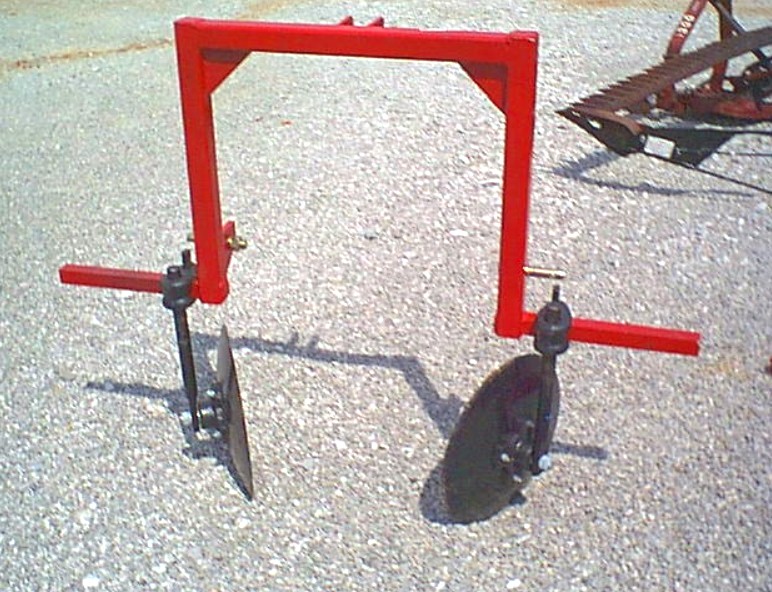

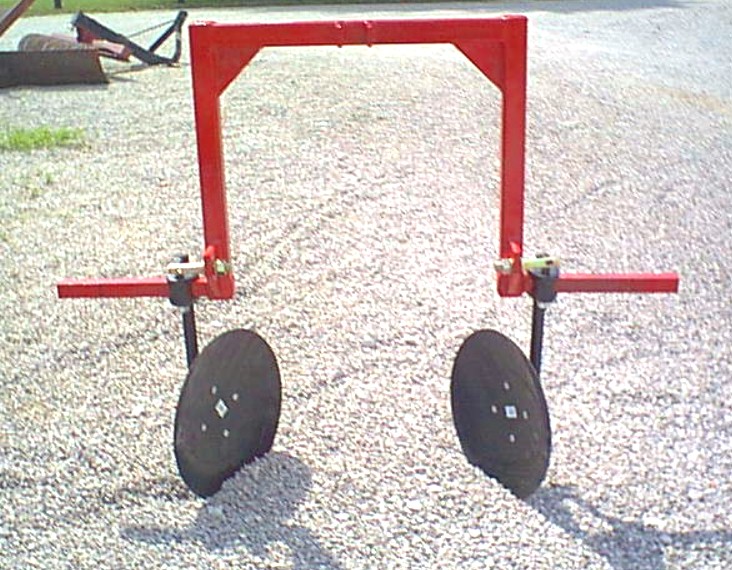

Here is a picture of the one we sell. Ken Sweet

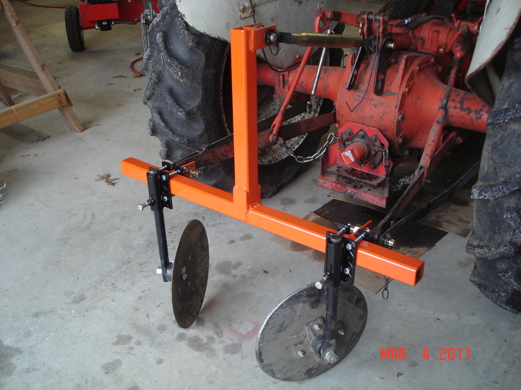

/ disk bedder #7
I assume you made that clamp assembly rather than bought it. I like it. The 'T' frame is the simplest I've seen yet in my TBN search this evening.

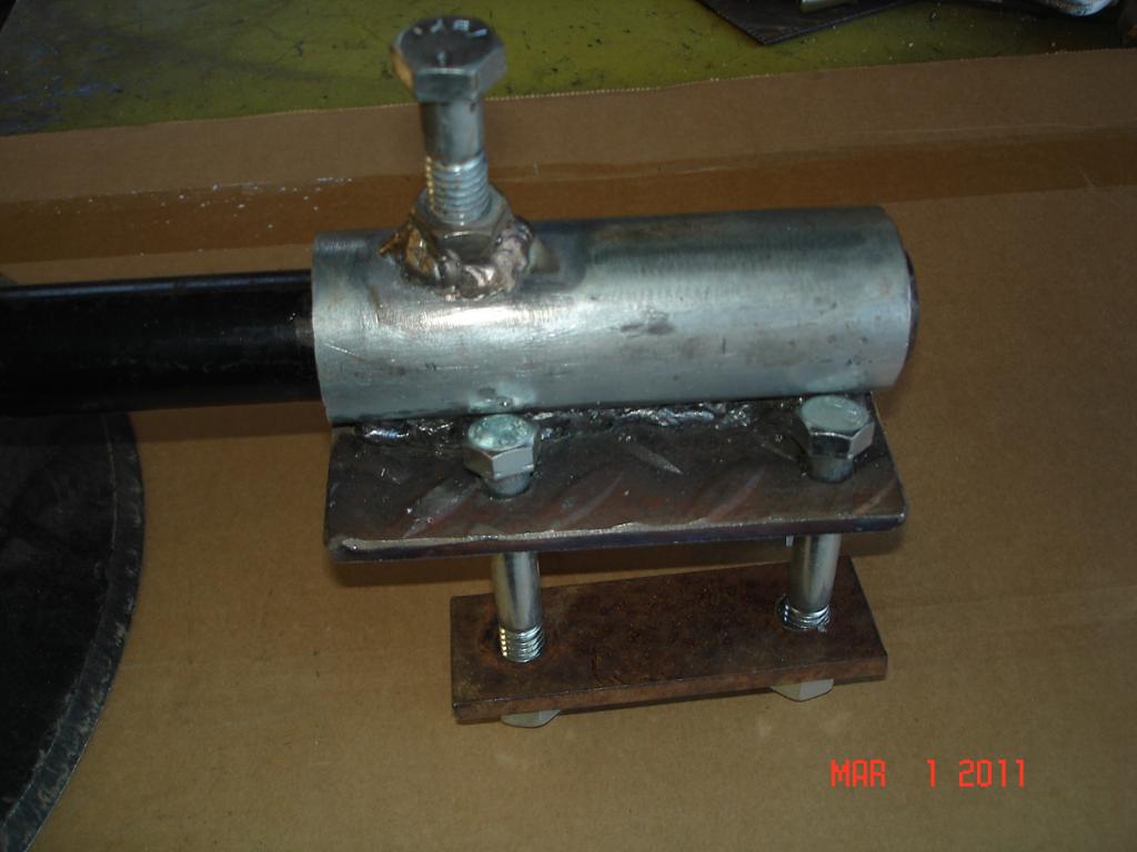

Yes, I made the clamps from 1 1/4" pipe, and some scrap tread plate. I'd made the same set up last year, using u-bolts as clamps. I couldn't get it tight enough to keep the discs from turning a little in the clamps. The 3 point frame tube is 2", 1/4" wall.

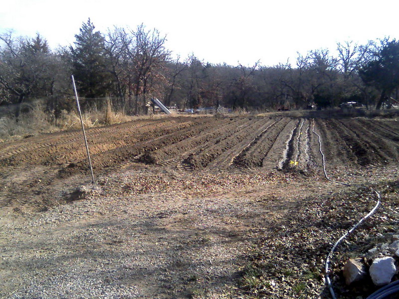

Jim, I'd love to see a picture of your hiller mounted on your cultivator. I put mine on my cultivator and left a middle sweep to lay out a planting furrow on top of the bed. The shafts on the hillers from AgriSupply were just a bit smaller than my sweeps, so I had to shim around them so the cultivator feet would tighten down. My hillers and a photo of my bedded garden are below.

Row Hillers are still not used in Ky. We lay off our rows with a wide point or a middle buster 1-2-3 rows at a time. They are used a lot in the south and on the East coast states. I never knew why. We do sell the Keluvator with 16 inch discs for $495. My Grandad had the first Bush Hog in Hart County in 1958 and I was told to cut anything I could ride over with the 70 HP Case tractor. And I did. He mounted a 6 inch well casing across the front of the tractor (Tire to Tire) I would ride a lot of saplings down that were 6 inches in diameter and mulched them. Direct drive from the 6 ft Brush Hog to the tractor (no slip clutch and no shearpin) Ken Sweet
