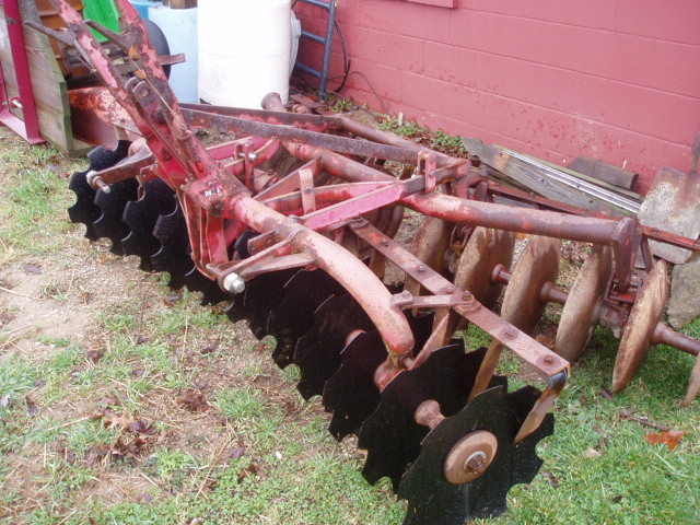

I recently bought an old 5foot 3pt disk harrow.
The front and rear gangs are both notched disks.
The front disks are wore out bad. Notches are almost worn off.
The rear disks look to be in good shape. But what size are they.
I measured one today and this is what I got.
So what size disk is it? I need 8 disks for the front.
Still working on finding out what brand it is.
Can't read the tag very well.
Thanks.

You want 18" disc blades. TSC will (should) have them. What size axles? (They'll probably have 2 choices) Square or round? I just bought a few. Got 'em through Agri-Supply. They shipped 'em right to my door for less than I could buy locally.

get the disks the same size as the not worn backs...
   / Disk Harrow Disk Size
The "not worn" back disks are what I measured.
I believe the center hole is square, not round like I drew.
It was just easier to draw a round hole.

You'll find there are several axle hole sizes. One is sort of a "star of David" (only with 8 points instead of 6) shape that fits 7/8" round or 1" square. Also, you'll find 1-1/4" square holes. (And some bigger sized holes too) They do need to fit the axle fairly close, even when tightened, the disc blade will move some. Too big of an axle hole allows them to "wallow" around, wearing into the axle.
