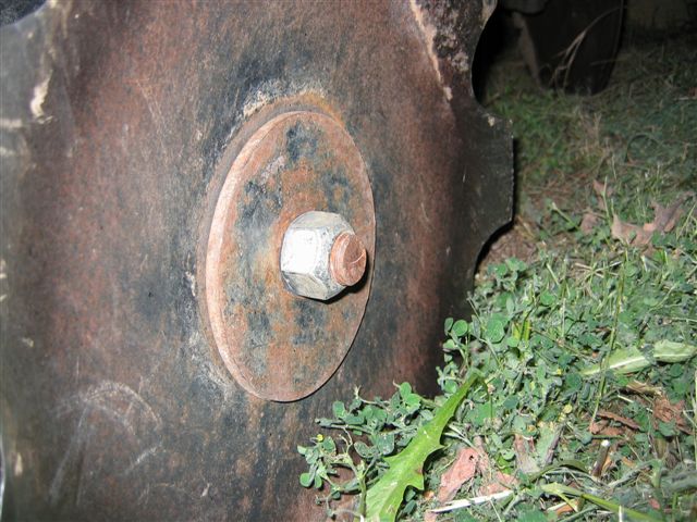

You are wrong, you just need a bigger tiller and tractor /forums/images/graemlins/grin.gif As for your disc, make sure the disc is in the air some when you try to tighten it. If it is in the ground and you have a lot of play the disc will shift and bind making it impossible to tighten. If they are in the air then you have a chance. You might have to put a pipe wrench on one end of the shaft to keep it from turning though (otherwise you will be there for a while /forums/images/graemlins/crazy.gif) Later.

/ Disks loose on tandem disk #26
I got the same socket set, same case at Menards for $39 a couple years ago. Good enough.

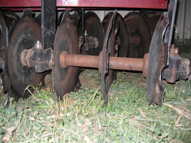

However, a disk needs some real power. A 3/4" air ratchet, or 2 big pipe wrenches with cheater bars.
Once the disk blades spread they get packed with dirt inside between the cones (spacers) and shaft, and you can't ever get them tight. Need to take all apart & clean up. Takes some work to pull apart too.
Letting it go as is will shear the axle off as the loose disk blade wobbles on it. Not good. I would not run it that way, the damage will mount up rapidly.

Robert, I guess I need a bigger pipe wrench, Sounds like taking it apart is the way to go, if I can get it apart. In addition to dirt, since I was disking heavily vegitated soil there are weeds and grass wrapped up in it. That could be a factor.

Wrap a chain around your disks and frame to keep it from turning. Putting it in the dirt will keep the disc and spacers from chinching up.

I've got a 6' J-Bar with 20" pans that has a similar problem and it's always the left front gang. It bent the lock tabs and spun the nut off once and bent the axle. I got a new axle and it still has a problem. I used a nylock nut instead and it won't come off completely, but still gets loose. The hardened pans also wear into the axle and I 've had to tear it down and build (weld) axle back up twice in two years. Only this gang! What gives?

Generally disk axles are hardened. Welding it took the temper out. now it can't get enough torq to keep it tight, the soft steel will stretch on you. They need a _lot_ of omph on the end nut to tighten up. They have a locking tab that hammers down, you need to use that to hold the nut tight.
This is how big ag field disks operate. It may or may not relate to smaller 3pt models.
A loose disk is a bad thing. The disk slowly decomposes when you allow it to operate loose, and it is then difficult to make it good again - loose parts wear sloppy, and you can't get the sloppy parts tight again. The edges of the collars between blades get worn out of shape & do not contact & clamp the blade properly any more - we are talking thousandth's of an inch is all. If your blade holes wore bigger or the shaft itself wore smaller, then the blade will want to move 'up & down' on the shaft while in operation. Not very much, but that tiny little force is enough to rattle the whole shaft, and the end nut will want to work loose. Always. Evermore.
To overcome that, you need to _tighten_ the nut. Tighter thany you will believe. This makes the hardened axle stretch, clamp everything in place through all the vibrations & rocks. If you heated the axle, it's soft & it will stretch too much, you can't get enough ft-lbs of torq on it. Any rock it hits will stretch the shaft, everything moves a bit, dirt works in, things continue to move & shift & wear. The end nut wants to fall off.....
For ag disks, Shoup (shoupparts.com or some such) sells a lot of disk parts, axles, & nuts, nut lockers for all brands.
Loose blades is a bad thing - keeps reappearing once it happens, as you are discovering. Sorry.
