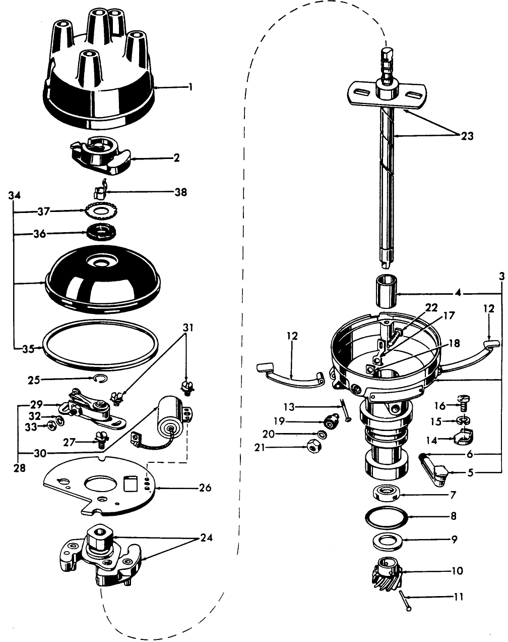

I replaced my oil pump in my 1954 naa started it up it ran for 15 seconds then quit found no spark and the rotor not turning. What did I do wrong and what will it take to fix it ????

Did you notice whether there was oil pressure while it was running? I would make sure the drive shaft between the distributor and oil pump is completely seated in the oil pump, otherwise, the distributor cannot be positioned properly. Additionally, with the distributor removed, check to make sure the oil pump can be turned.......I suppose it would be possible for something to jam the pump, causing the pin attaching the distributor drive gear to shear.

You are correct, the pump runs off of the distributor shaft........I am wondering whether something caused the gear pin (#11 in the diagram below) to shear.

I do not know what engine you have, but on most engines the cam drives the distributor, and the distributor drives the oil pump.
If it fired, and ran and now the rotor does not turn while cranking, the distributor shaft could of broken 5% chance, the cam could have broken, the timing chain could be broken if it has one.
Very few engines have the crank drive the distributor if yours does please give me the make and model, I have a few old manuals.
   / Distributor not turning after new oil pump #9
If the distributor pin shears it will still drive the oil pump, it will not keep the distributor, in time it may turn.

I guess I will pull the distributor out to see what happened to it. I tried to turn it by hand ... no luck
