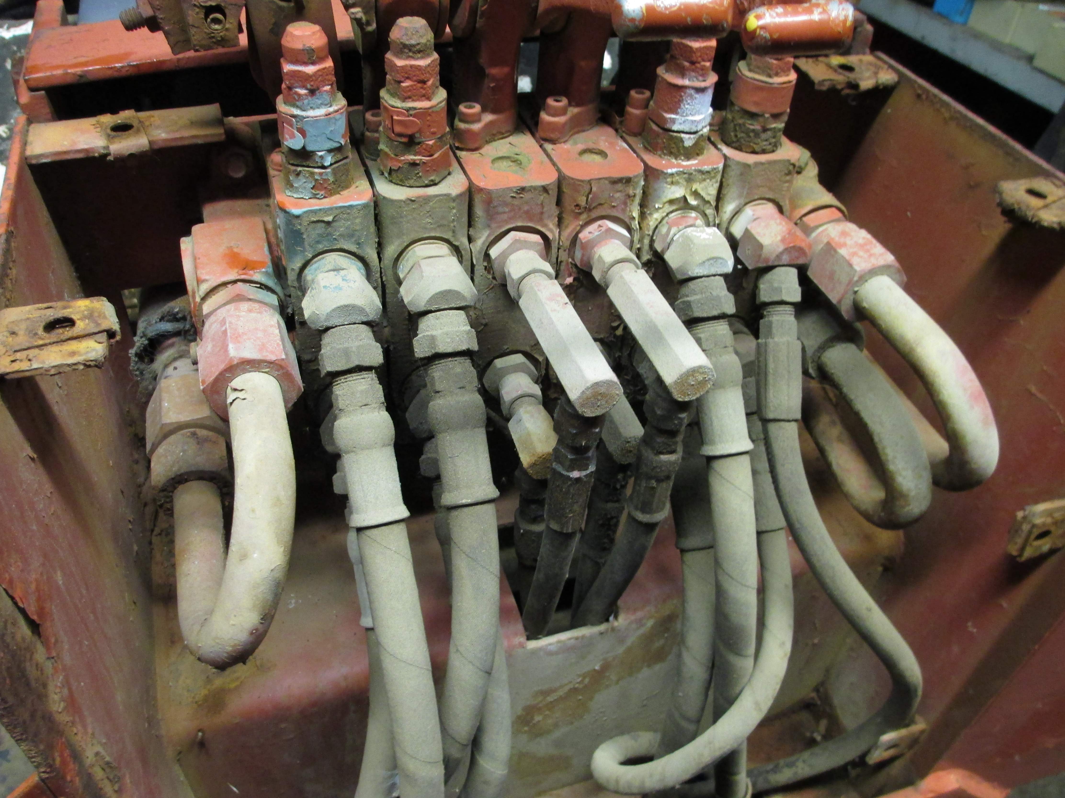

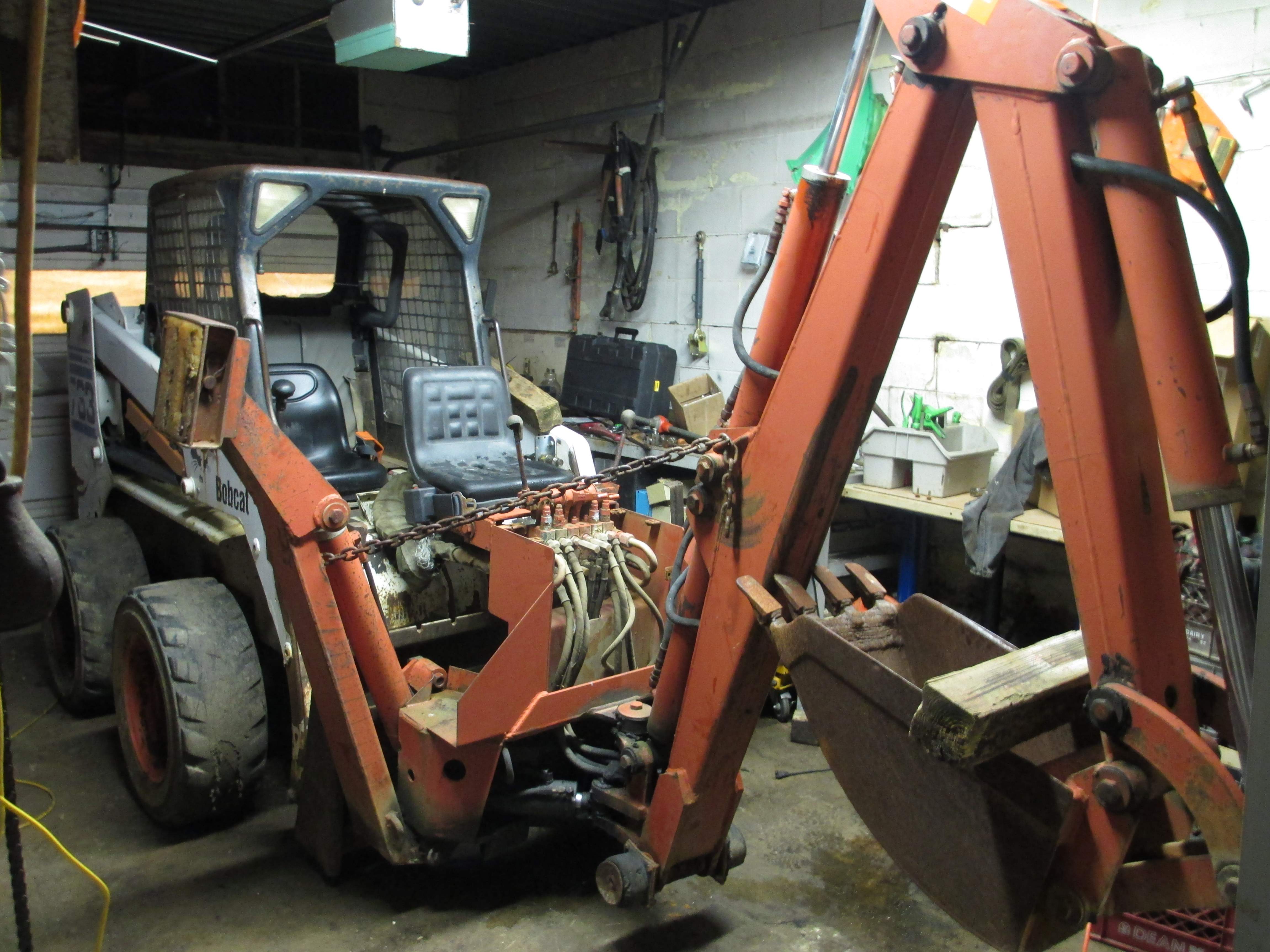

I have a Ditch Witch 140 Backhoe that I mounted to a Bobcat 763 Skid Steer.There are 3 Hoses coming off the Ditch Witch.I am guessing that 2 hoses are a return line and can be connected together however I am not sure what line is the pressure line and which are the returns.I have included a photo of the hydraulic manifold on the Ditch Witch.Also I do not know what is the high pressure connection on the Bobcat.Top or Bottom.
Thanks

I answered your Ditch Witch connection question in the Hydraulics Thread.
I think you need a manual for the skid steer also.
The connections should be like my V417, they are both pressure or return depending which way the constant flow valve is activated.
