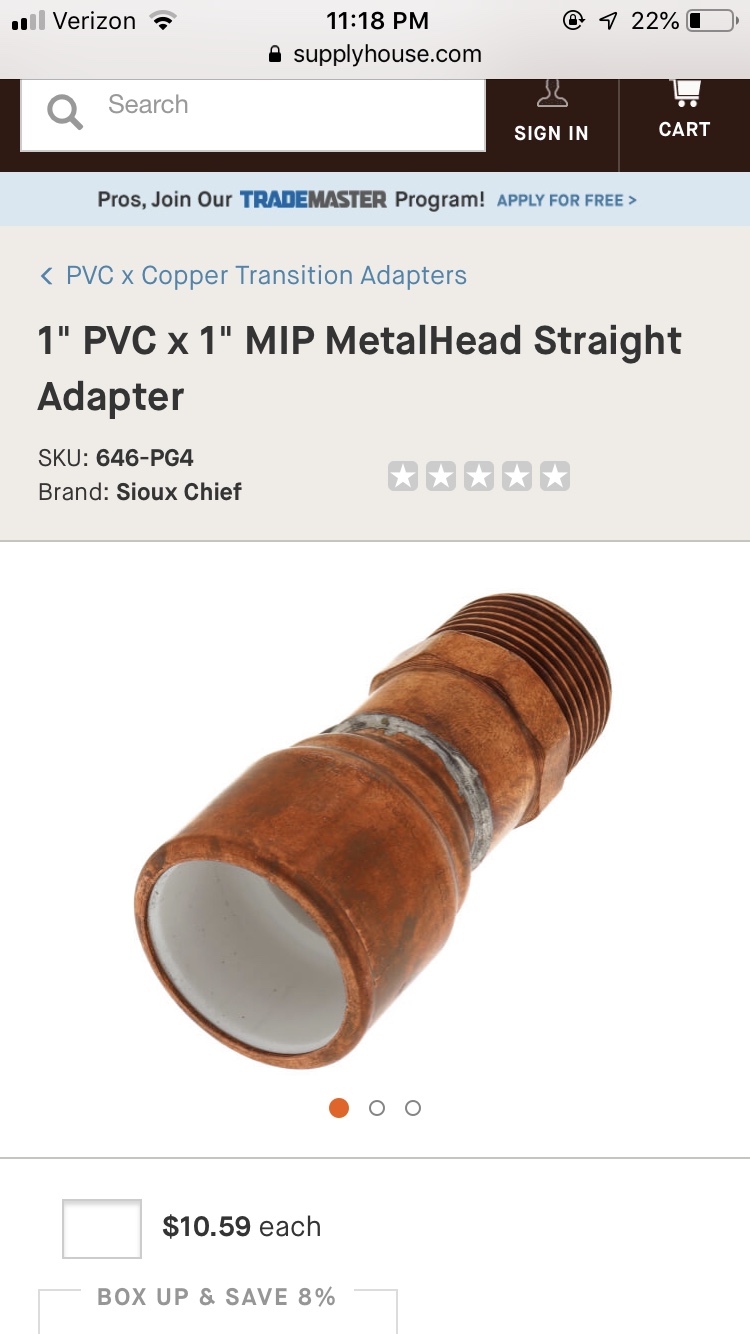

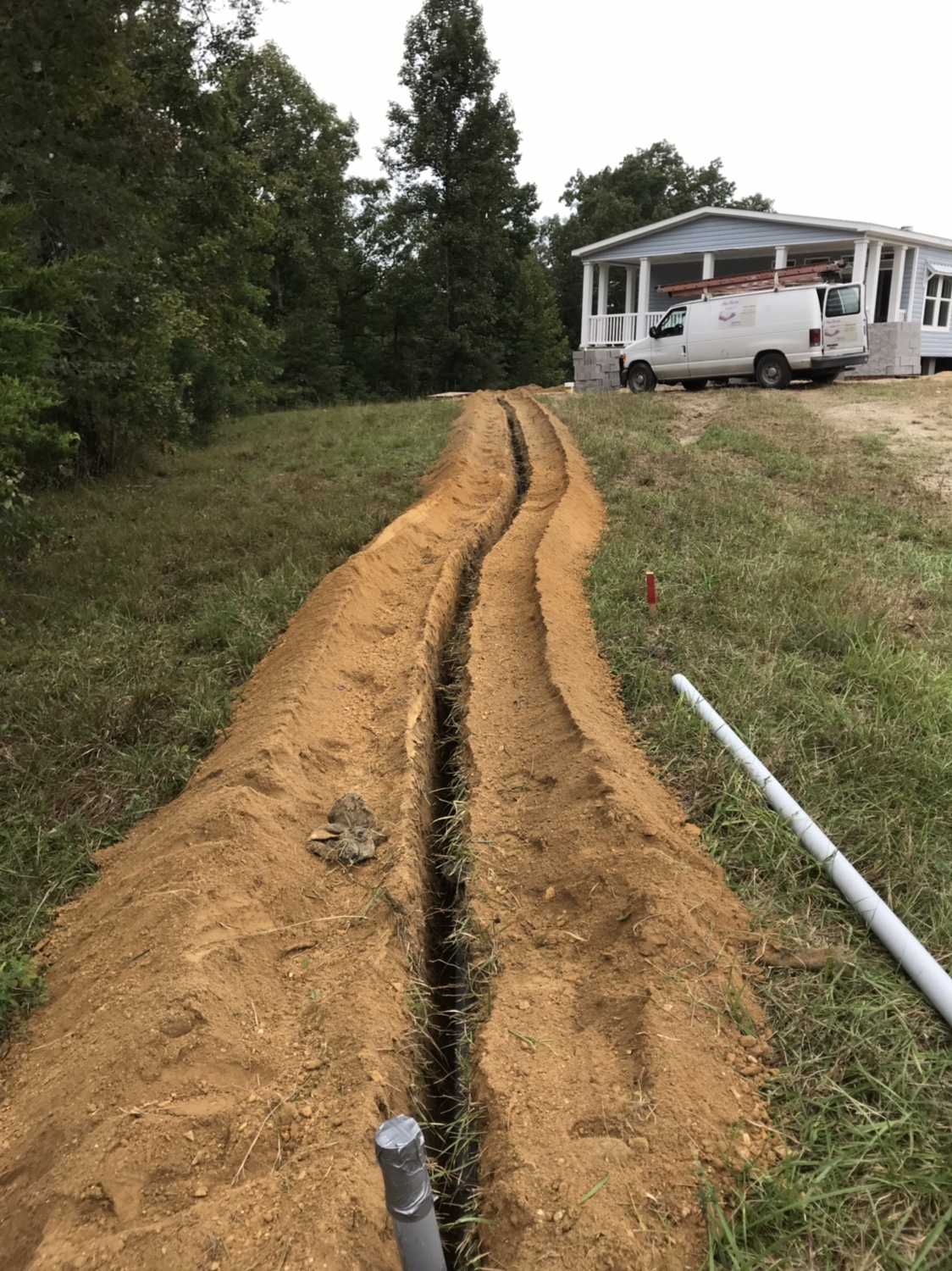

You could probably hire someone and have the job done for $300, they’re probably going to charge tax and delivery on top of that. I’d be happy to do one for that if it was local. I usually charge $2 a foot for digging/cover up but 50’ wouldn’t be above the minimum. Do yourself a favor and don’t use black poly. Use 3/4 PVC. Don’t use a plastic thread fitting in the meter box either. IMG_9178.JPG

My neighbor is getting some quotes. The first one came back with $1900 which is what led her to start looking at other options. I gave her the number of the guy that does well work for me, he should be much more reasonable than that. Either way the advice that 4570Man has given has been of great benefit. Nice pic BTW. We'll see what they come back with.
