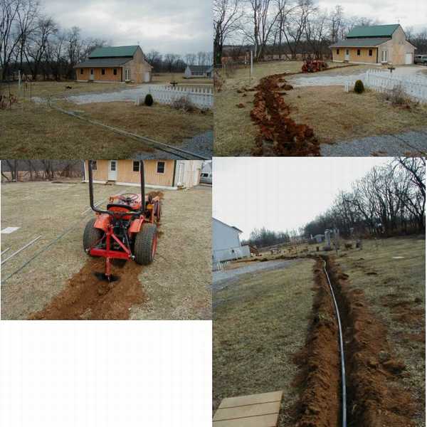

Sold my Kubota B6100 when I moved to WA
I needed to run electricity from my house out to the new barn I built and since I have the tractor, I didn't want to go rent a ditch-witch.
So I bought an $80 middle buster and used it to dig the ditch for the electric conduit.
It's 135 feet from the house to the barn.
After about four passes with the middle buster I had cleared the trench maybe 14" deep. Because of its narrow wheel base, the tractor was riding on the hills of removed dirt so the plow was as deep as it would go. I don't think you can go deeper than the length of the plow's moldboard without alot of hand cleaning of the ditch anyway.
The little 14HP Kubota pulled the plow thru the damp clay without strain.
The National electric code says 18" deep for conduit but my county has not adopted any building codes so I'm "legal" at 14"
I plan to use the same technique to run PVC water lines out to my garden area.

I forgot to mention the pictures in the attachment to my first post.
In the upper left is an overview of the area with the conduit laid out along the path of the ditch.
The upper right and lower left photos were taken during the second pass with the plow.
The lower right photo is after I placed the conduit in the ditch.

I like what you've done to the place, fresh winrow of dirt! If you need to get deeper, get the welder out and put another set of lower pins about 6 to 8" above the factory ones (just make sure the moldboard does not drag the ground when in raised. just a though!

Looks great Bill. Any traction problems while you were working?

Paul: No traction problems at all. I just dropped the 3ph all the way down and let the plow pull as deep as it could. With the combo of the ags on front and those wide turfs on back and 4wd I seem to be getting "the best of both worlds".

Mark: I have a woodshop in the barn so I wanted 60 amps. I ran #4 Guage (red, black, white) with a #6 ground. I just tossed a phone wire in the ditch along with the conduit (not in a separate conduit or anything). I figure that's good enough because the incoming wire to the house is just laying in the ditch along with the electric company's feeders... I'm going to half-fill the ditch then lay in some yellow caution tape before the final fill just in case I forget sometime down the road where I put this line.
