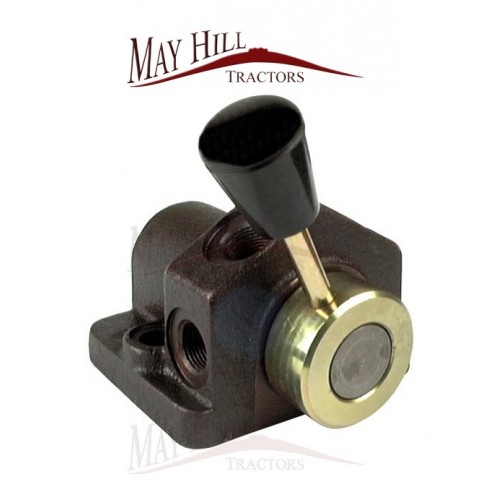

Hi Just joined tractor by net and for a specific need. I have a new after market May Hill diverter valve with three ports and a handle that conveniently indicate which port you have open because the handle seems to match the hydraulic oil diverter hole on the interior shaft. That to me means each of these three locations are supplies to auxillary implements. That also tells me that the return from a loader for example should be piped to one of the plugs that are in the upper part of the transmission housing on my MF 135. Would anyone be willing to weigh in on my thinking on this? Thank you.
   / diverter valve #2
Do you have a model number for the valve?
Maybe this one? 3 Port Hydraulic Isolator Diverter Valve - Massey Ferguson 35, 135, 148, 165, 24

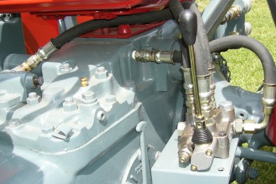

The plug is on the left side under the seat.
   / diverter valve #7
Pic from link
   / diverter valve
Agvg
Beautiful tractor; hope I can some day get mine that clean. Once I get it operating clean I will endeavor to do the same. Your picture shows good detail on where I thought the return must be, thank you. My controller is a Nimco valve that mounts above the loader. I like the way you have fed hydraulics to the rear.
   / diverter valve #9
The picture is borrowed from a thread here, so it's not mine.
