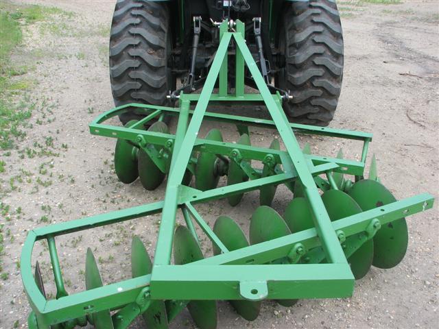

Here is a Disc I put together from another older larger disc that I picked up from a Farm Auction.

Where will the outer right disk of the front shaft, put its soil ? Have you tried if it plugs up yet ? I wonder ;)
   / DIY 3pt 5' Disc with Scrapers #3
what he said. Im going to bet that ther isnt enough space between the close ends and it will plug quickly especially if its not just clean dirt your trying to disc
   / DIY 3pt 5' Disc with Scrapers #4
yeah, lots of offset. But it looks like it's all welded...did it come that way?

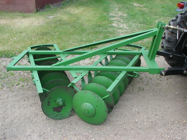

Nope doesn't plug at all it has scrapers too!
It did not come that way, I made it that way and yes it is welded no adjustment.
I took these pictures before I put it in the dirt.
