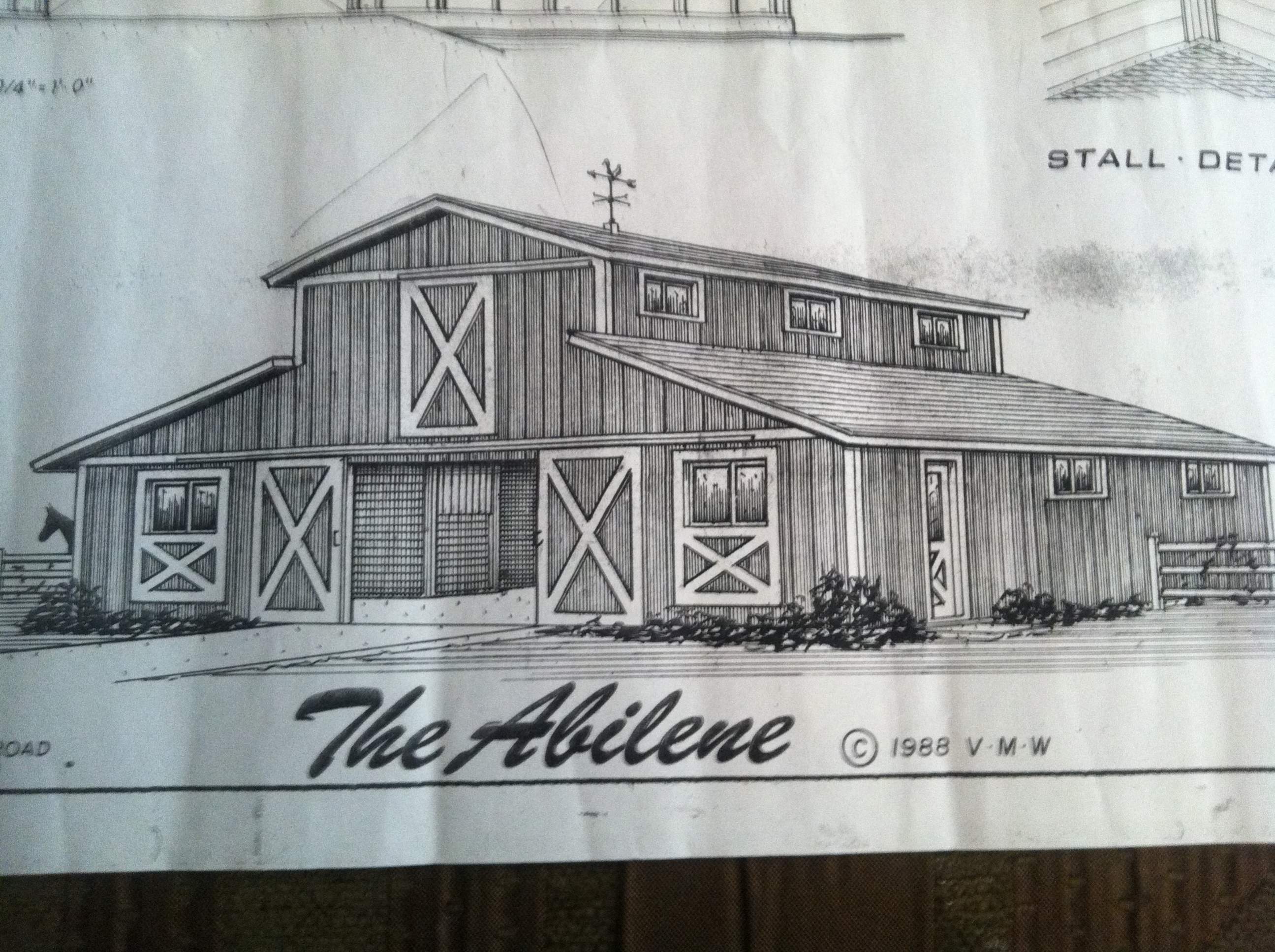

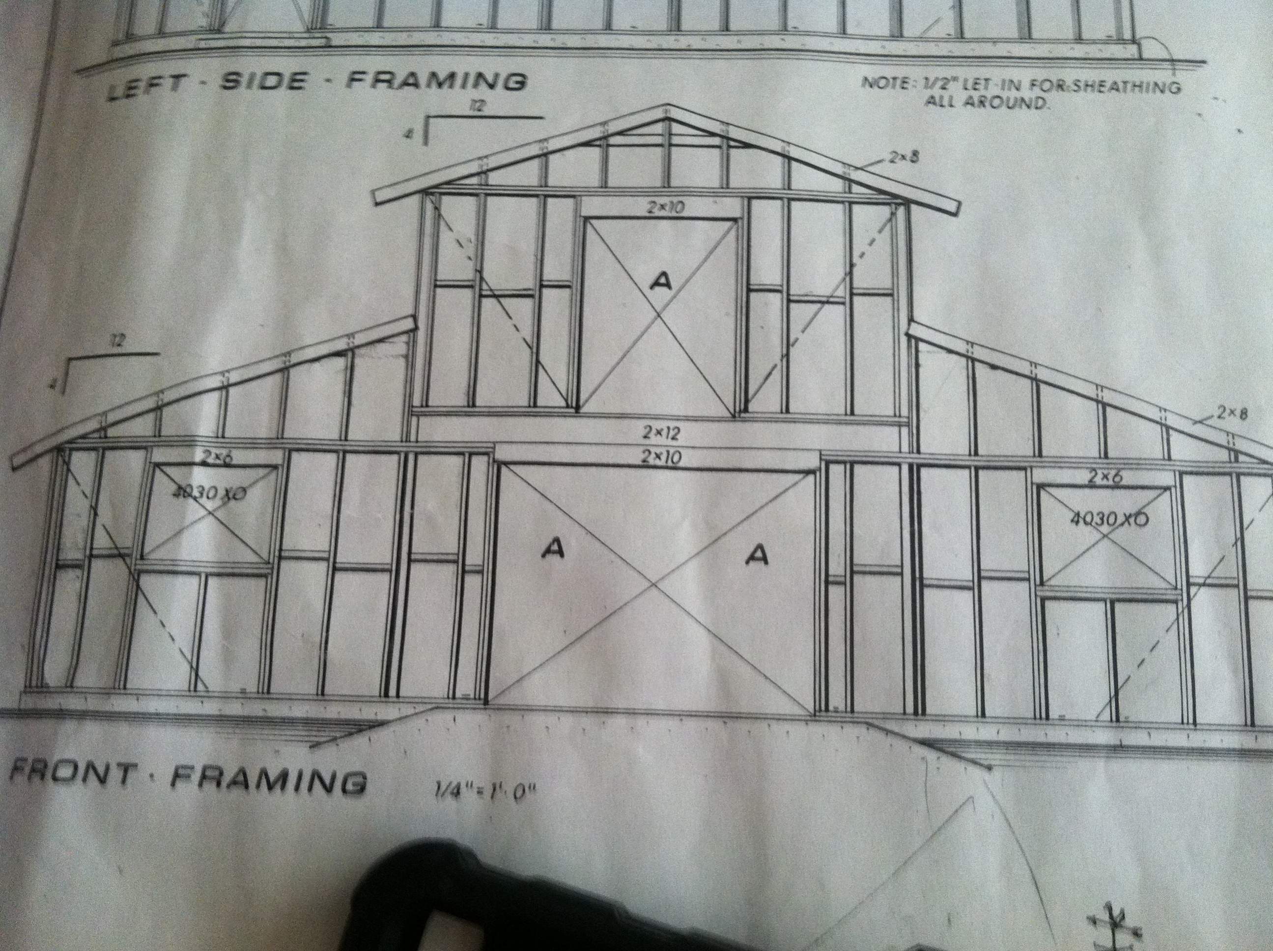

   / DIY barn/shed kits...any suggestions? #9
Did you look at the fast framer kit at norther tool.com
   / DIY barn/shed kits...any suggestions? #10
Thanks for the input. I think I will just come up with my own design and go that route. Probably be a bit more fun to do it that way!
take a look at this , 005.jpg006.jpg:thumbsup:
