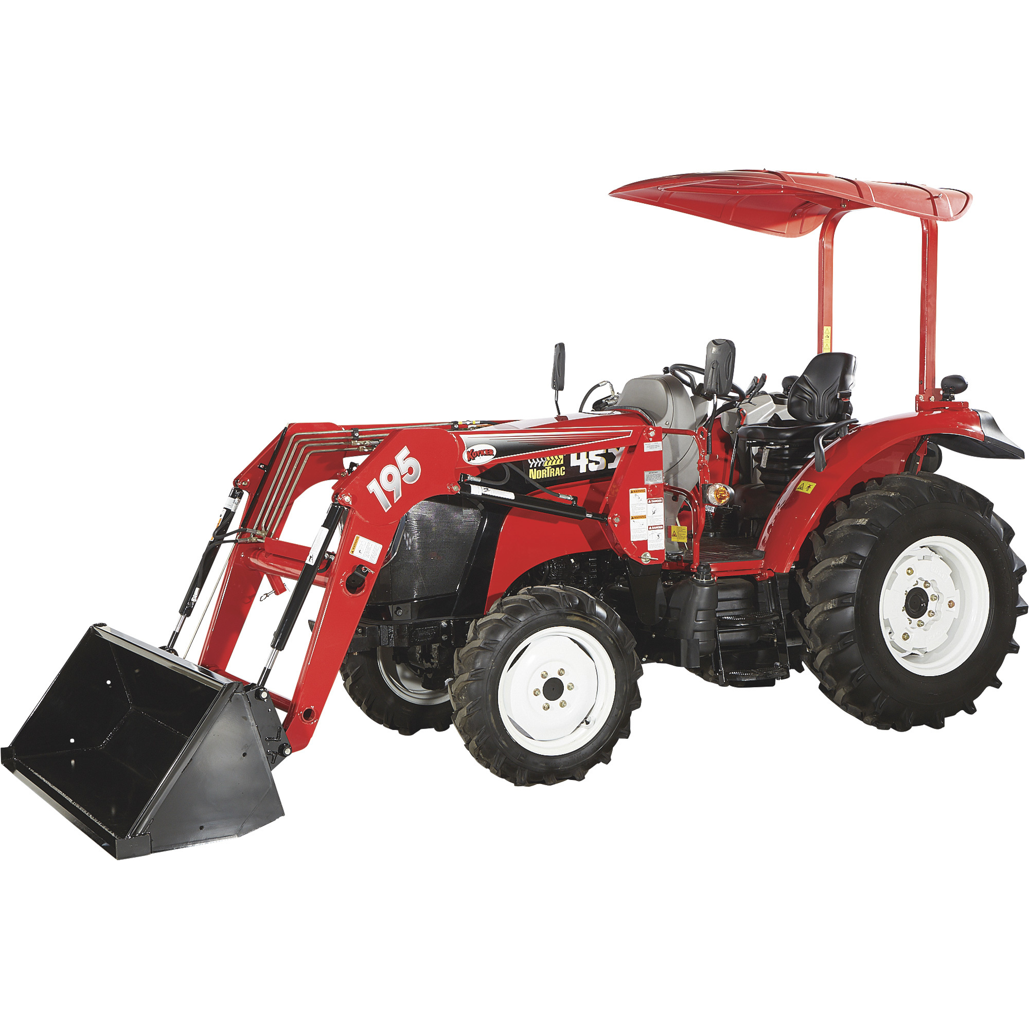

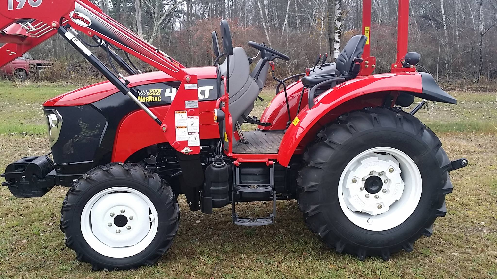

this a photo of my tractor I bought it from northern tool they have a web site that has a lot of info on it. Its a model 45XT 4wd.I am in northern PA.

Ok. Your snow falls can run the gambit of wet to dry. Your tractor looks like a nice unit and do I see wheel weights on your rears?
At any rate, I still like my idea of building a 6' box blade and designing it so you can add additional metal for snow drops to increase its capacity.
The guy in the video I attached stated that if he didn't have chains, he couldn't man handle that 8' box he has on and this was with a 12,000lb tractor.
If you're clever enough to fabricate a box blade, you should be clever enough to allow for it to be expanded for snow work.
An 8' box blade I feel is going to be tough to handle as an all arounder. It'll do an 8" deep dry snow with no problem. Make that 8" of wet stuff and it's a whole nuther ball game. Add dirt to the equation and I don't think you're gonna be pleased.
I also bet you can make a 2' extension to bolt up to one side if you think it can handle ditching.
