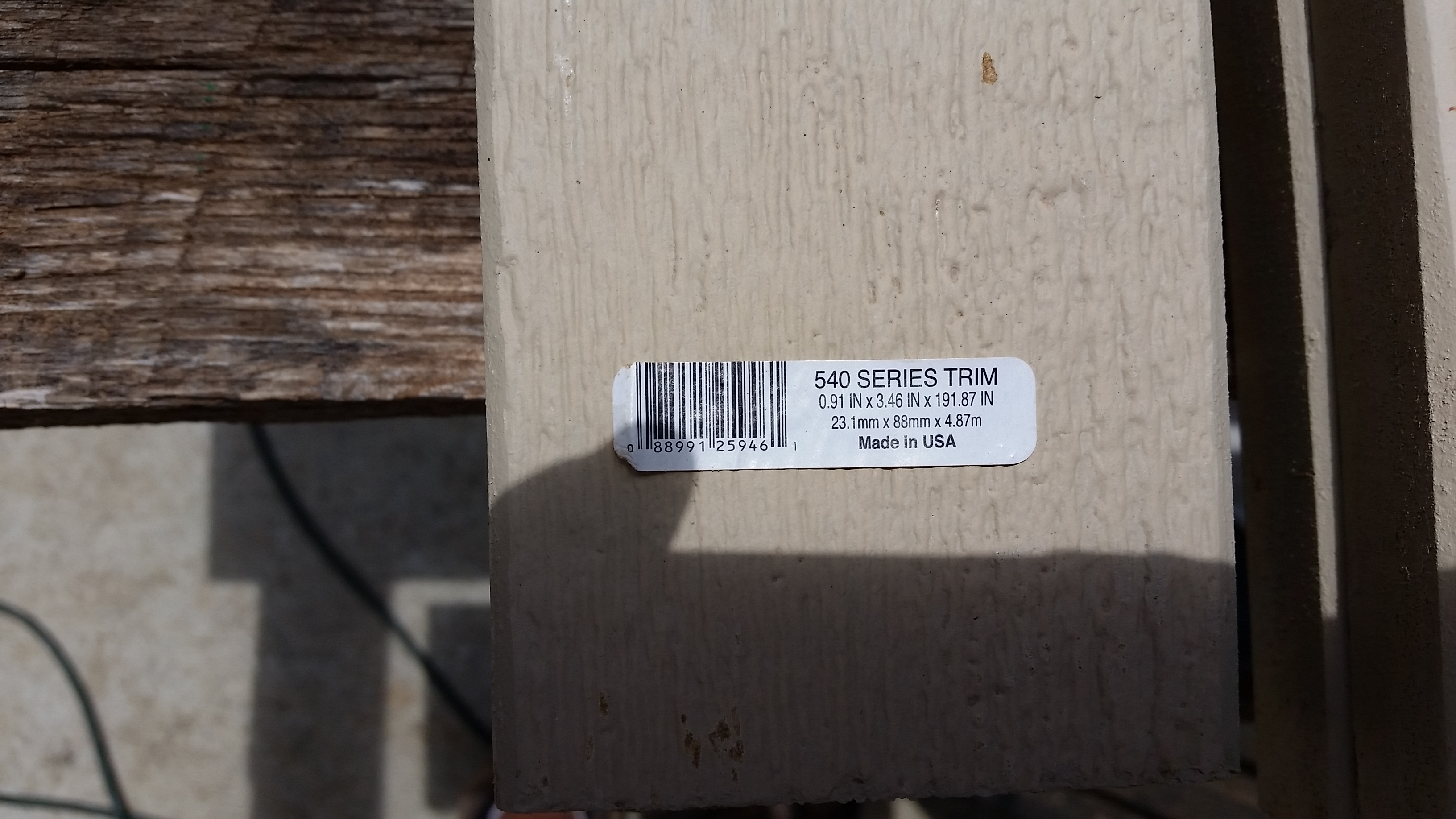

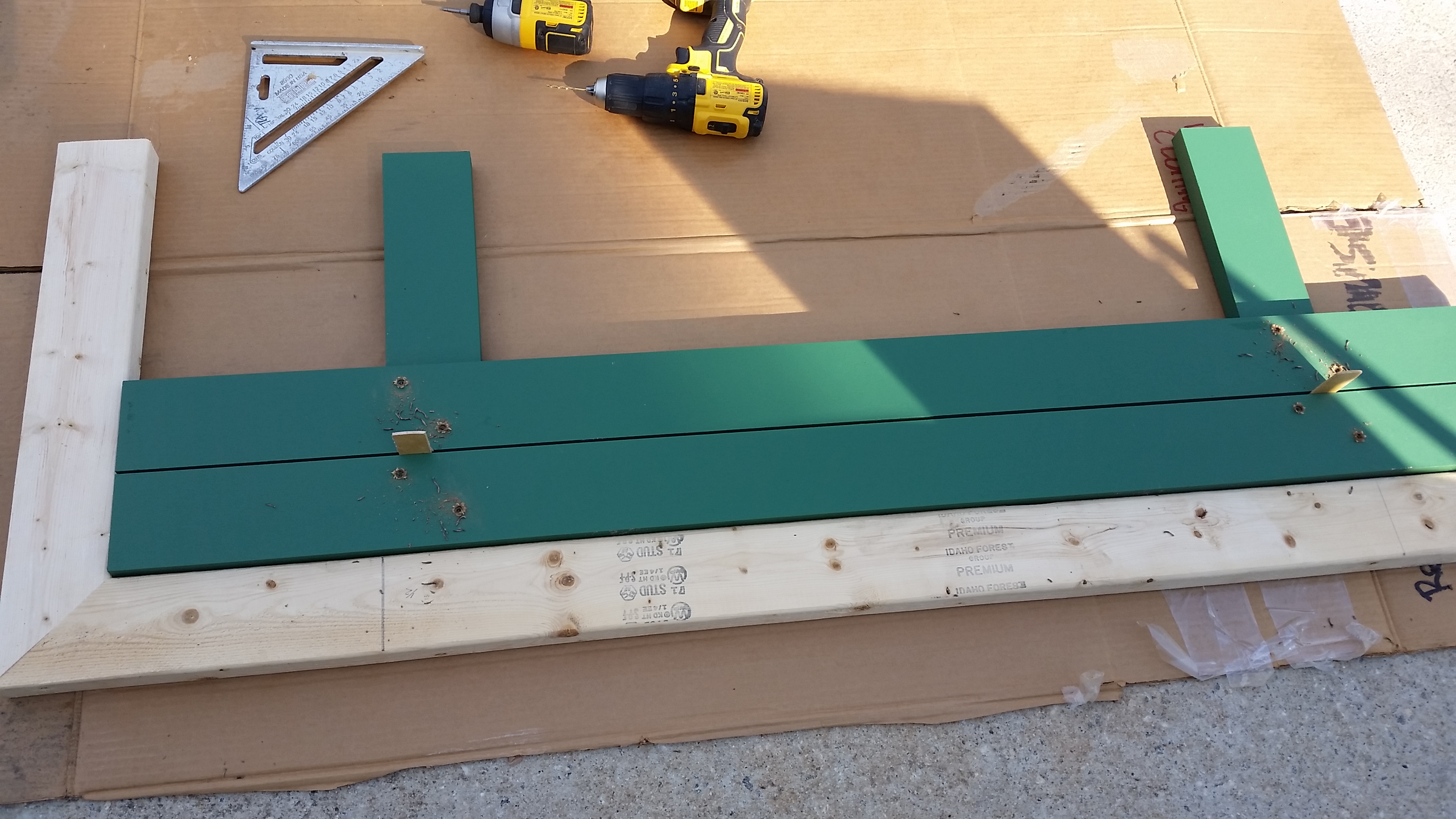

With the advice of several members and Eddie Walker specifically I went with Smartside trim boards Shop SmartSide 54 Series Primed Engineered Treated Wood Siding Panel (Common: 1.25-in x 4-in x 192-in; Actual: .91-in x 3.469-in x 191.875-in) at Lowes.com
I found a local lumber yard that had a much better deal than Lowes and their delivery fee was only $15.00
I bought a great little miter saw for $109.00

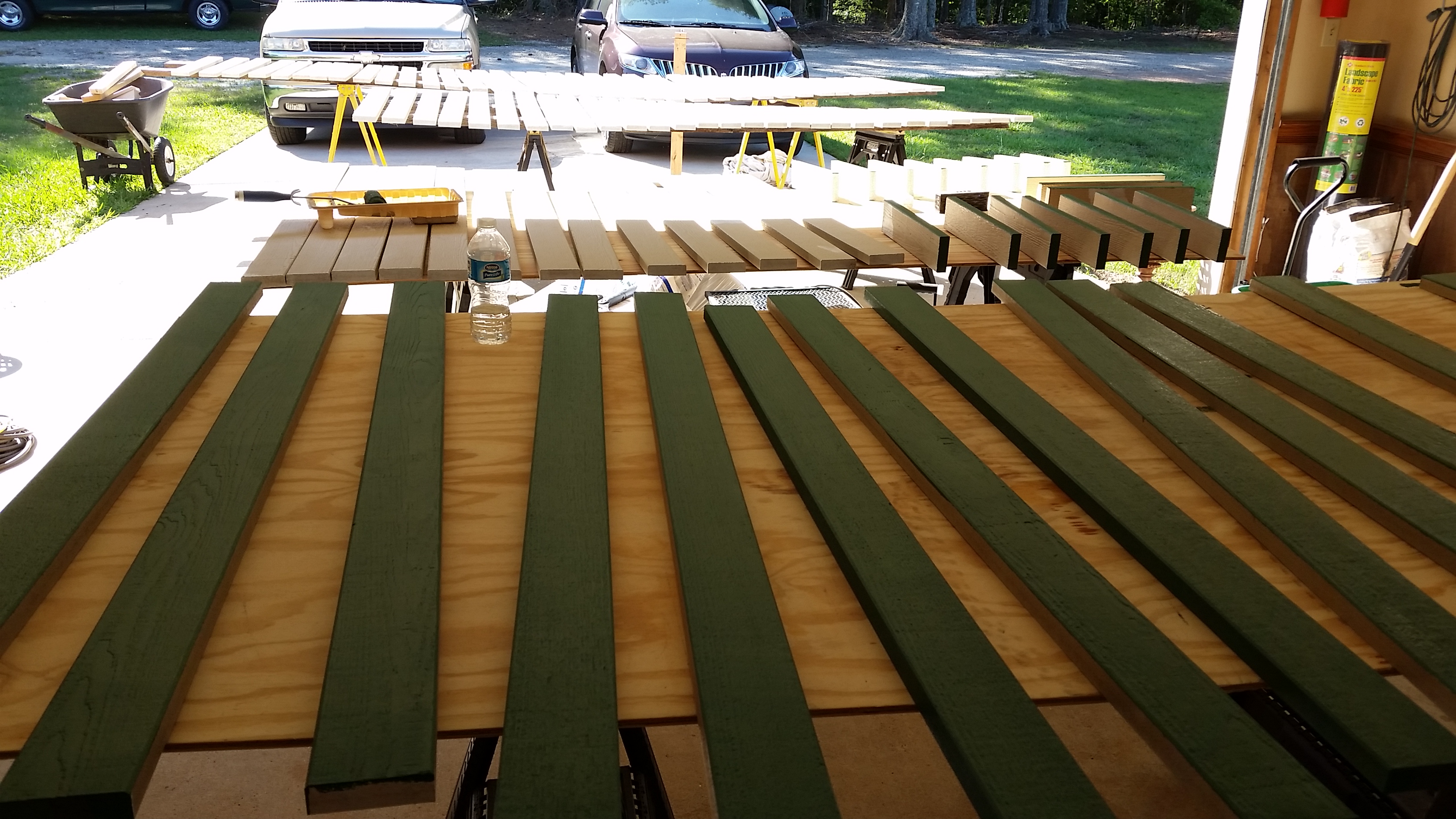

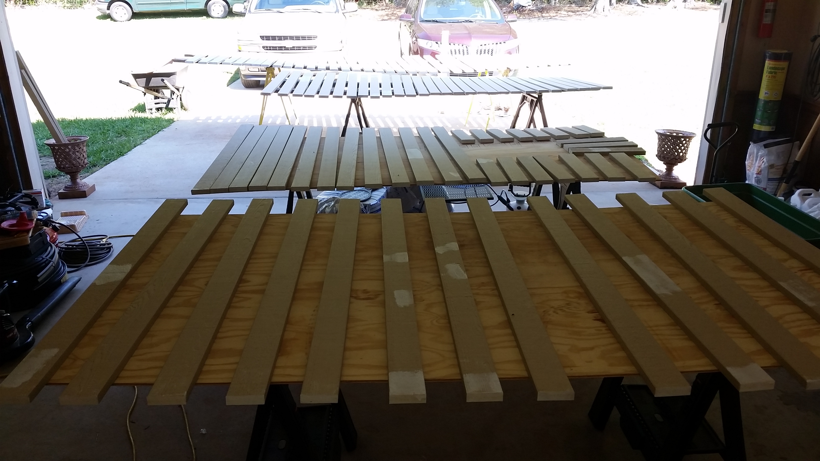

Next I setup sawhorses and primed all the cut edges and blemishes. Then I put a couple coats of paint to the boards and battens.

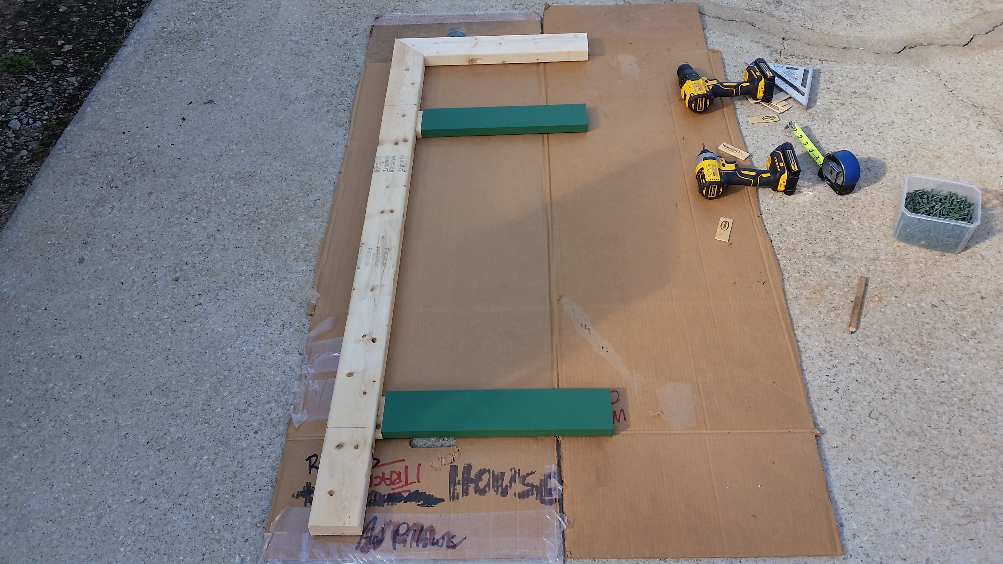

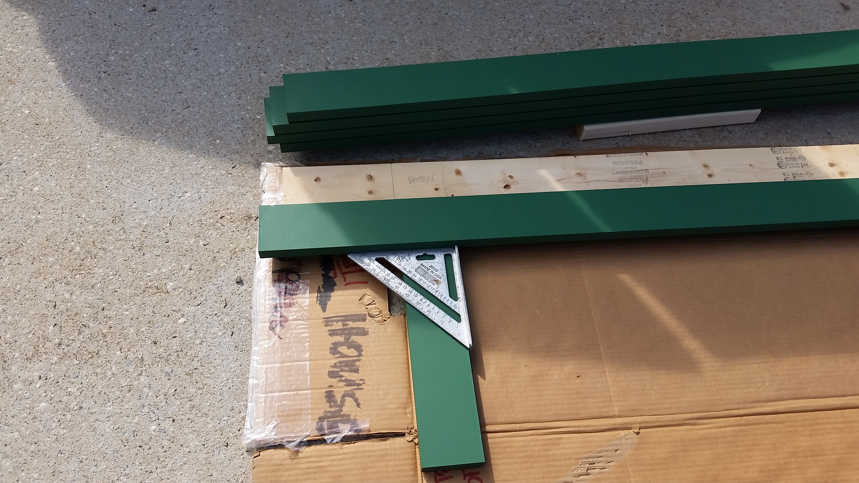

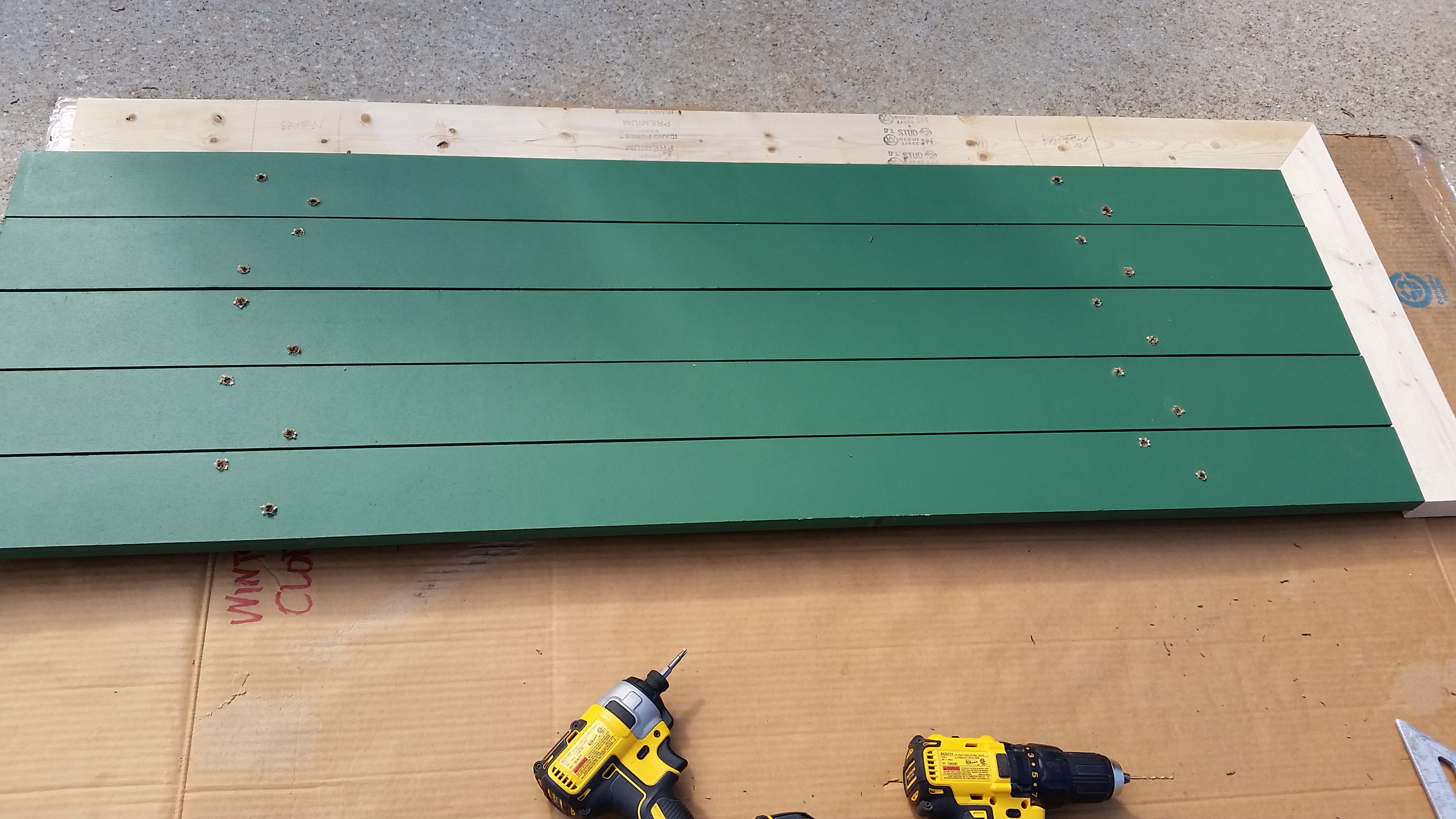

I wanted an 1/2' offset on the battens so I cut some 1/2' wedges to lay in the jig. I used paint stir sticks to give a slight separation between the vertical boards.
I used 1 5/8 x 8 deck screws with torx heads to screw these together. I found that a pilot hole was needed for these boards to draw up properly. I made sure everything was true with a speed square.

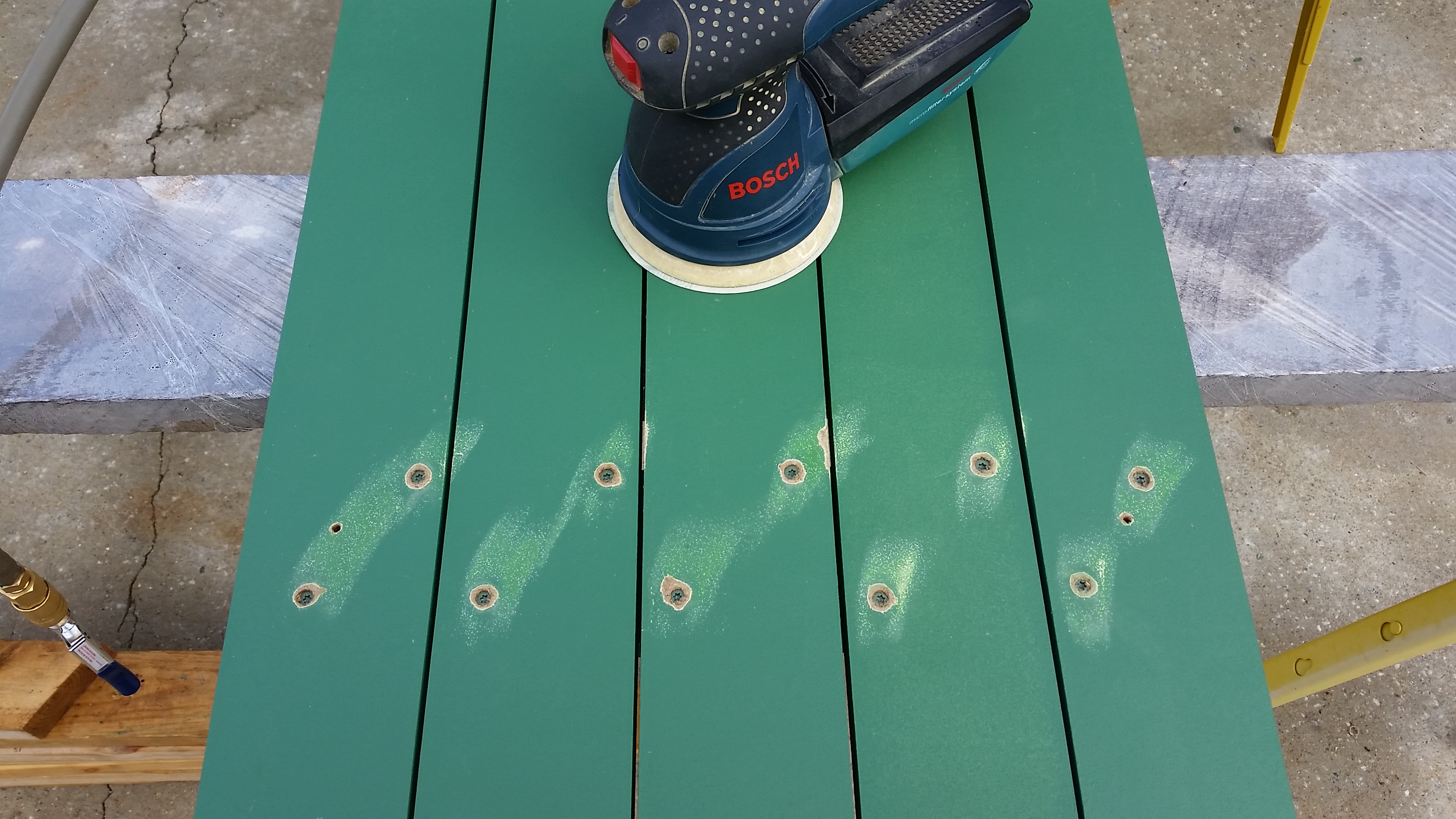

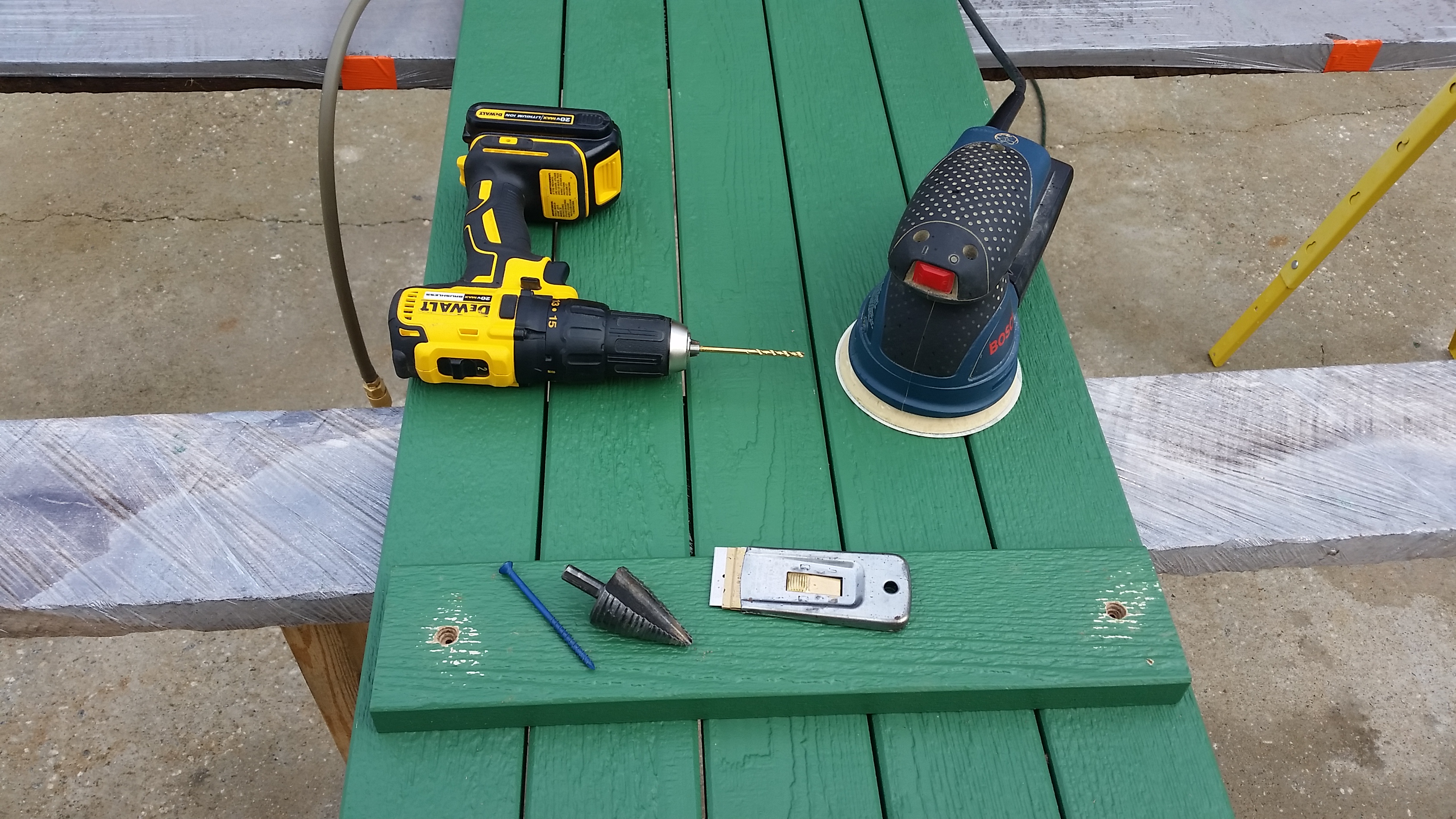

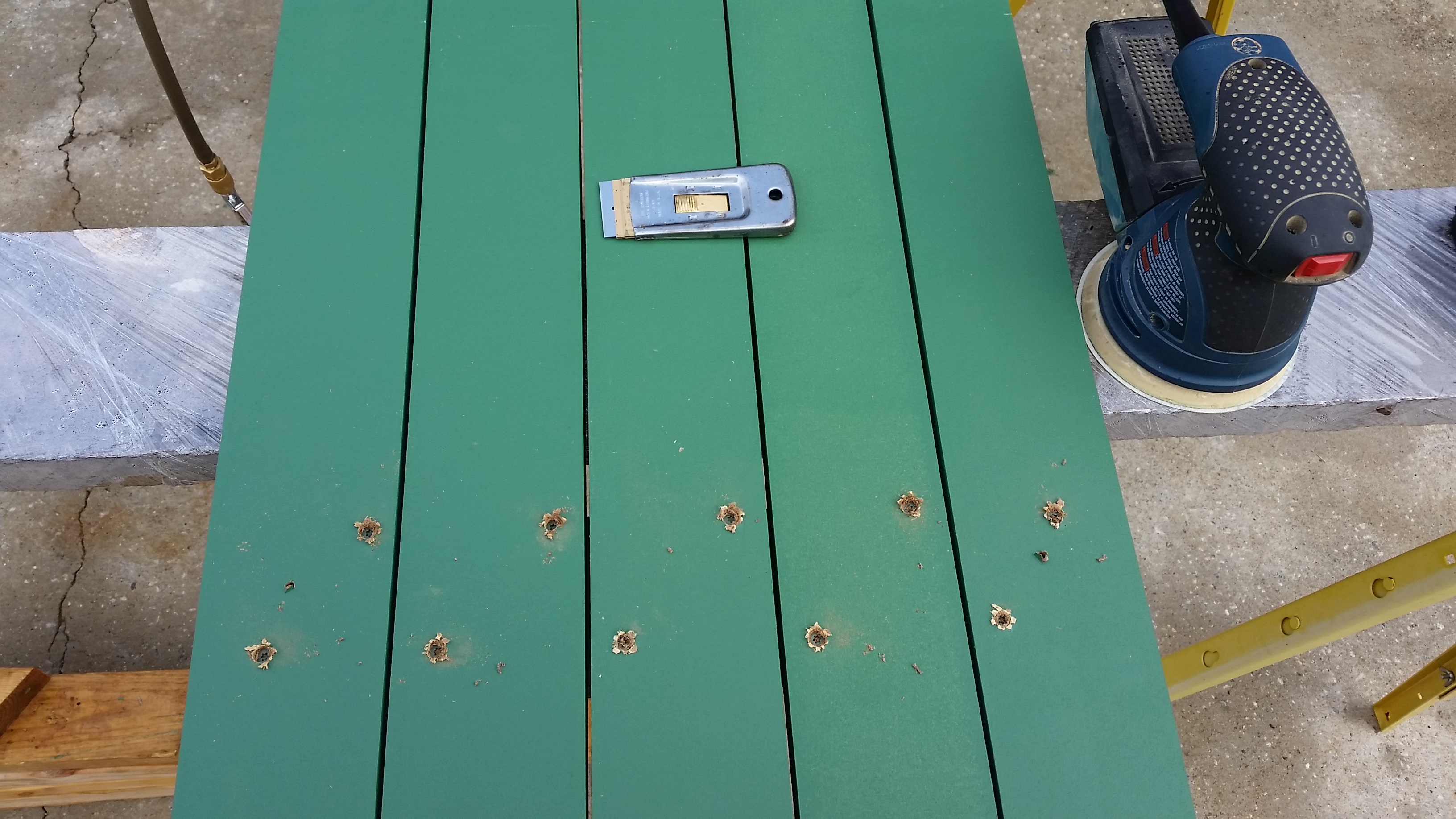

Next I used a window scraper and the orbital sander to remove burrs. Then I primed and painted, again!
Next I drilled a pilot hole and countersink holes through the shutters with a step bit. I went ahead and primed over that, the final coat of paint would go on after installation.

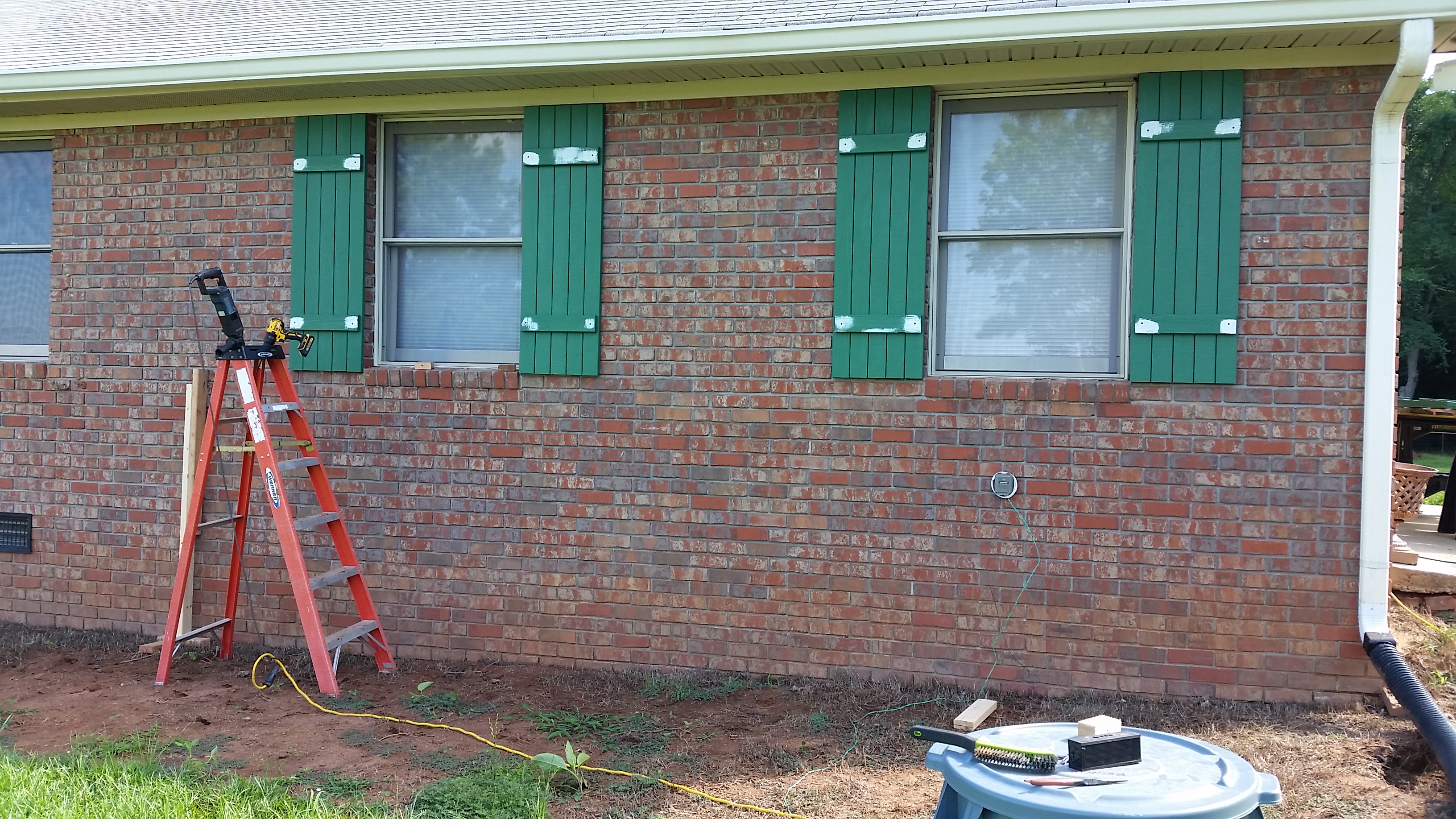

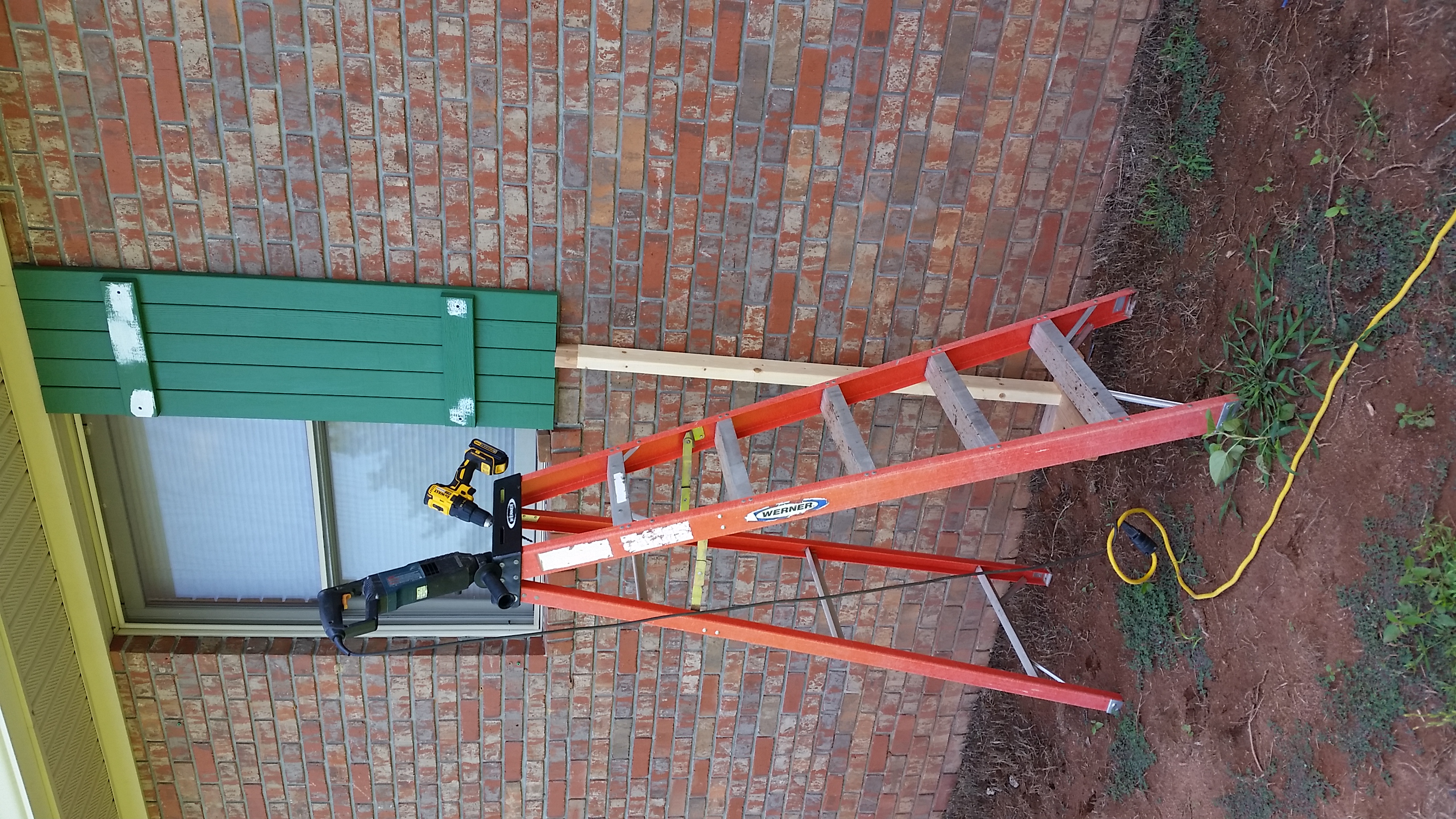

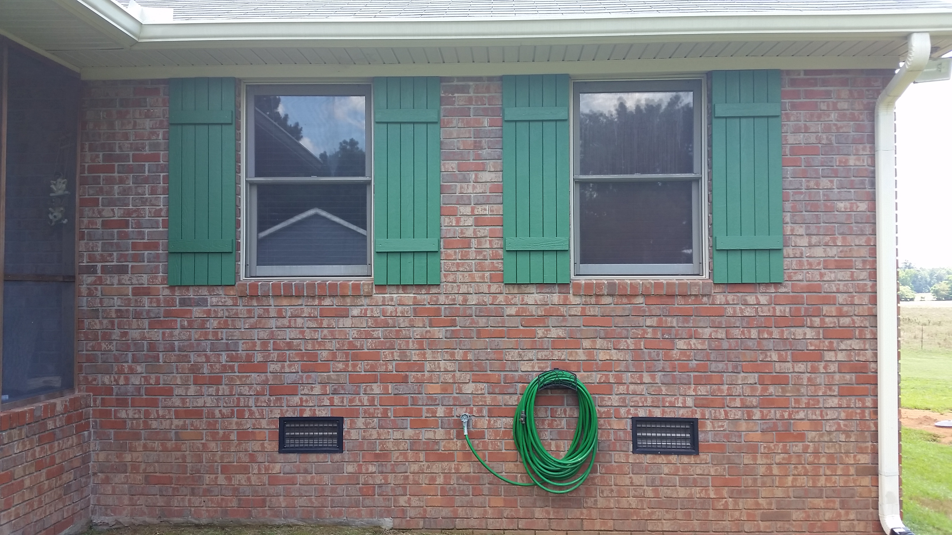

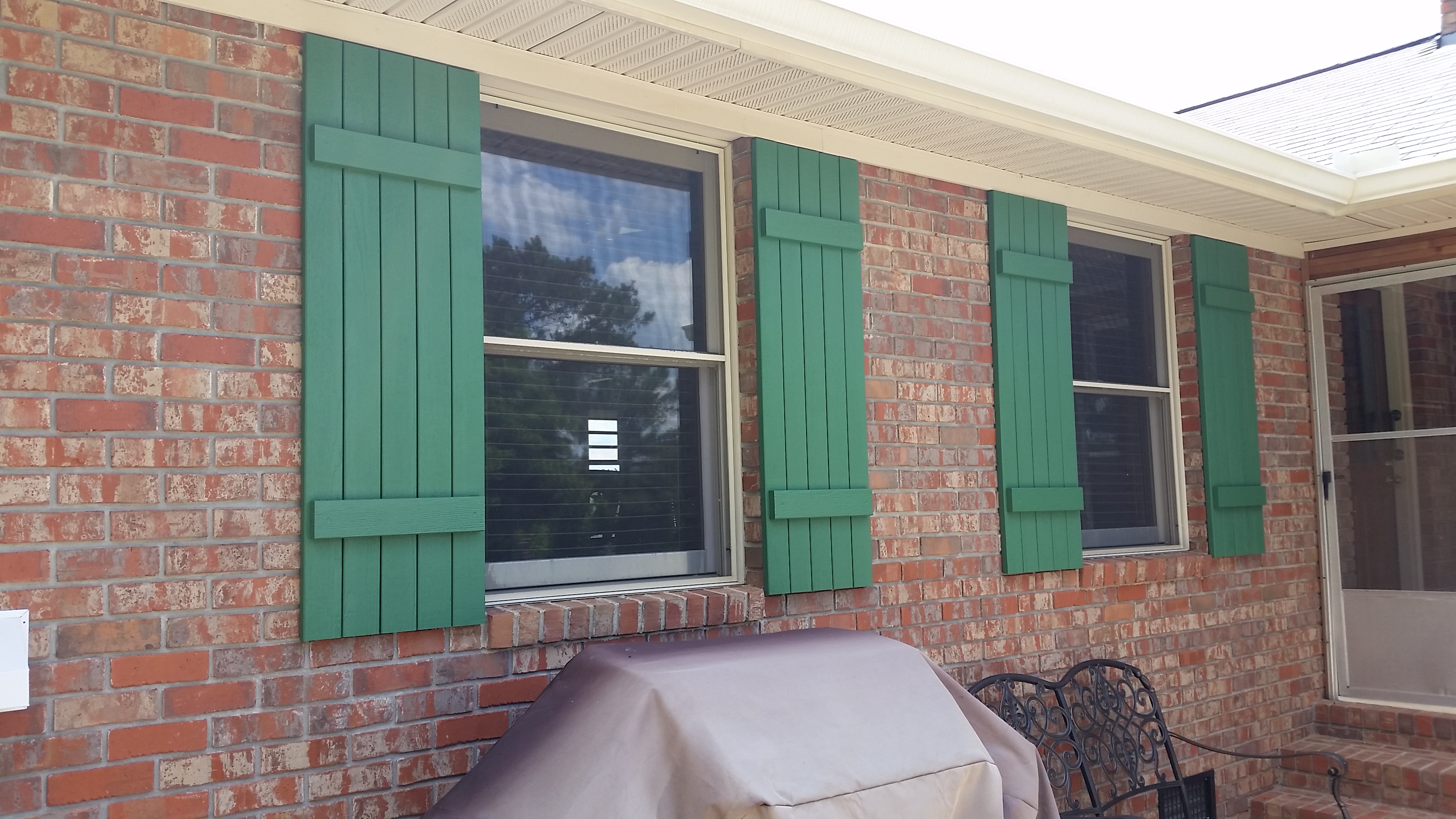

Now I had to figure out how to mount these alone. I used an adjustable support made with 2x4 and my trusty torx screws. Having 2 2x4's for the vertical arm made it easy to adjust for each shutter. To mount to the brick I used 3/16' x 3-1/4" Tapcon concrete screws. I drilled the brick with my hammer drill and attached it with a cordless drill.

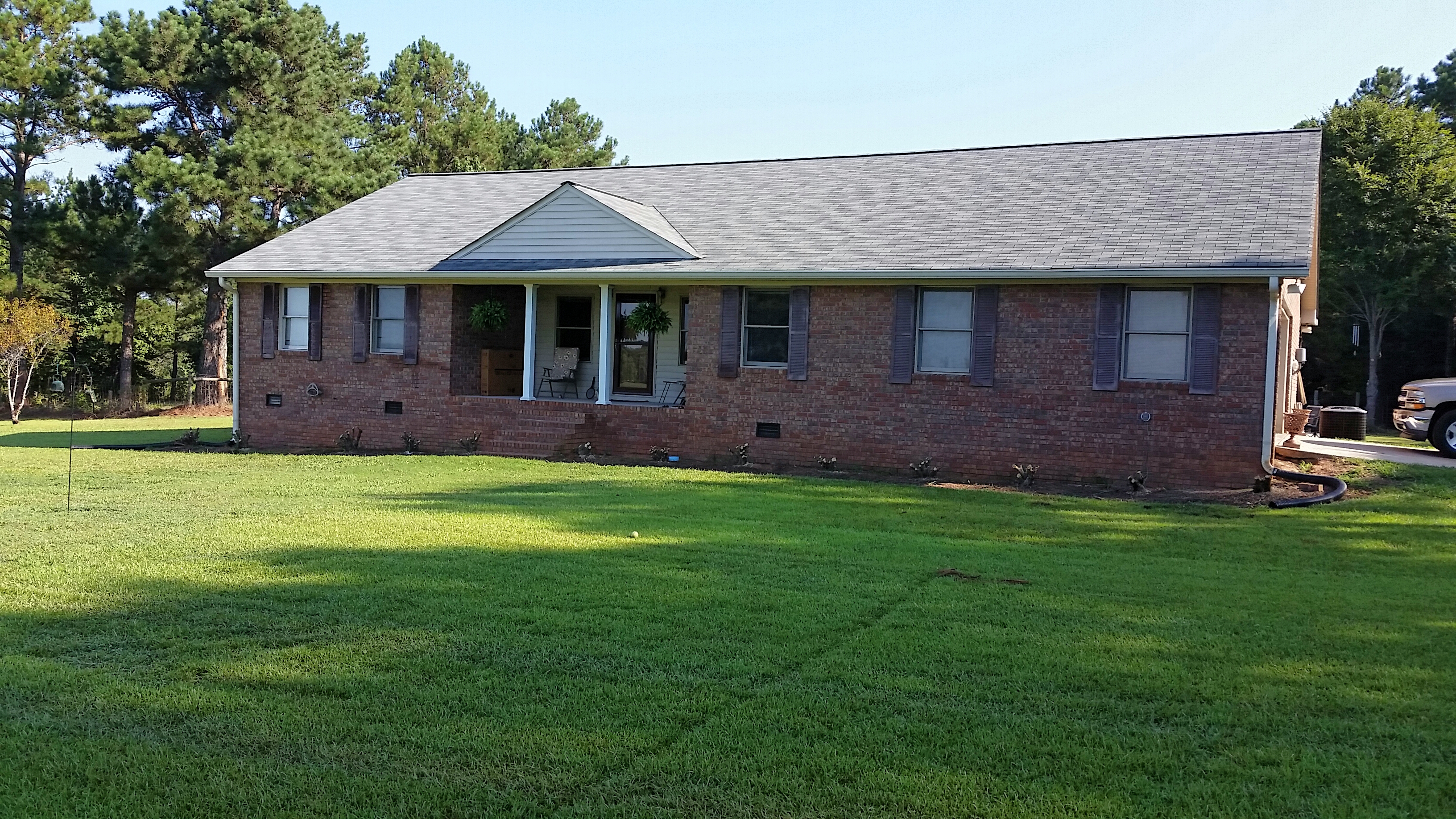

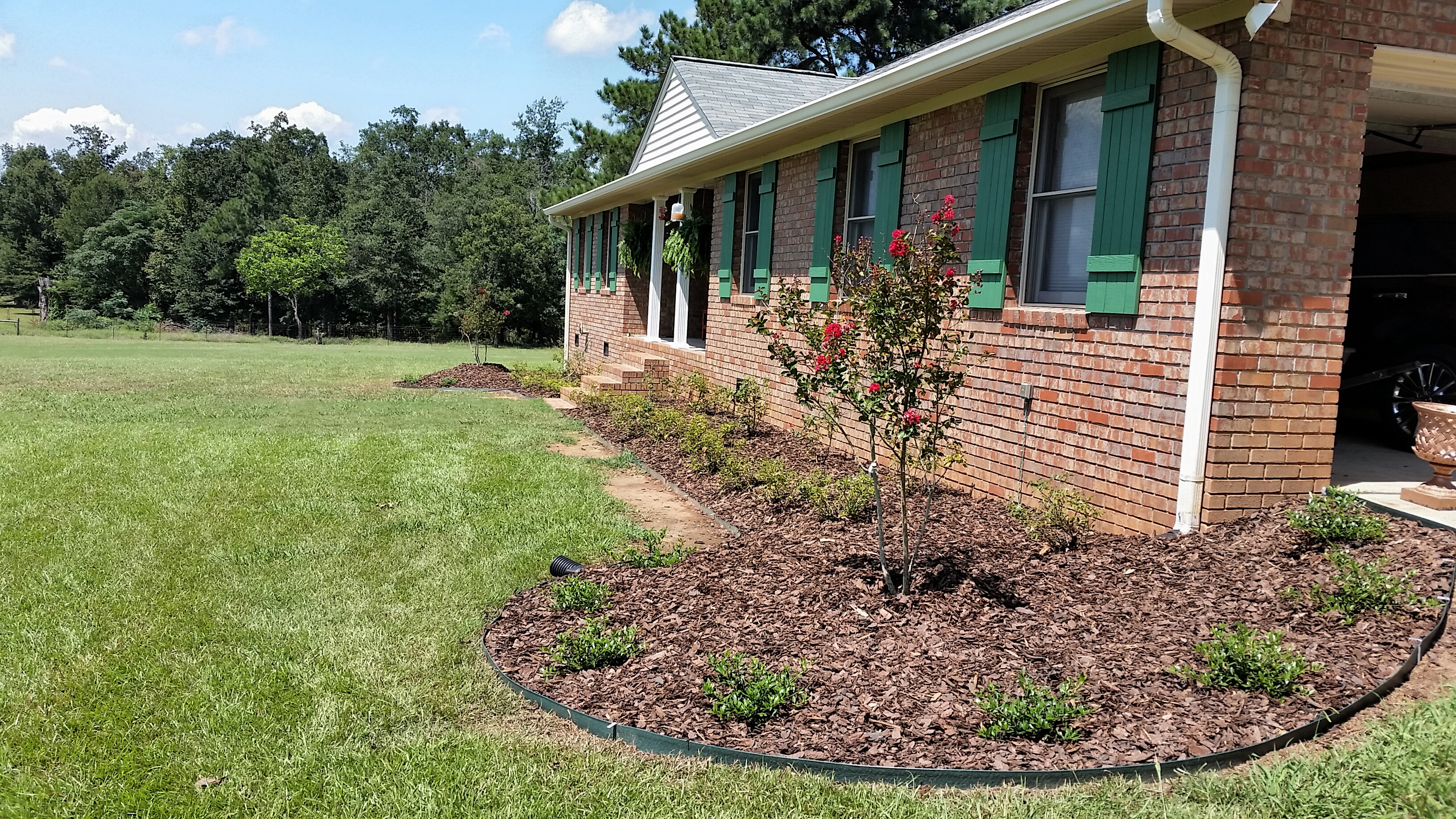

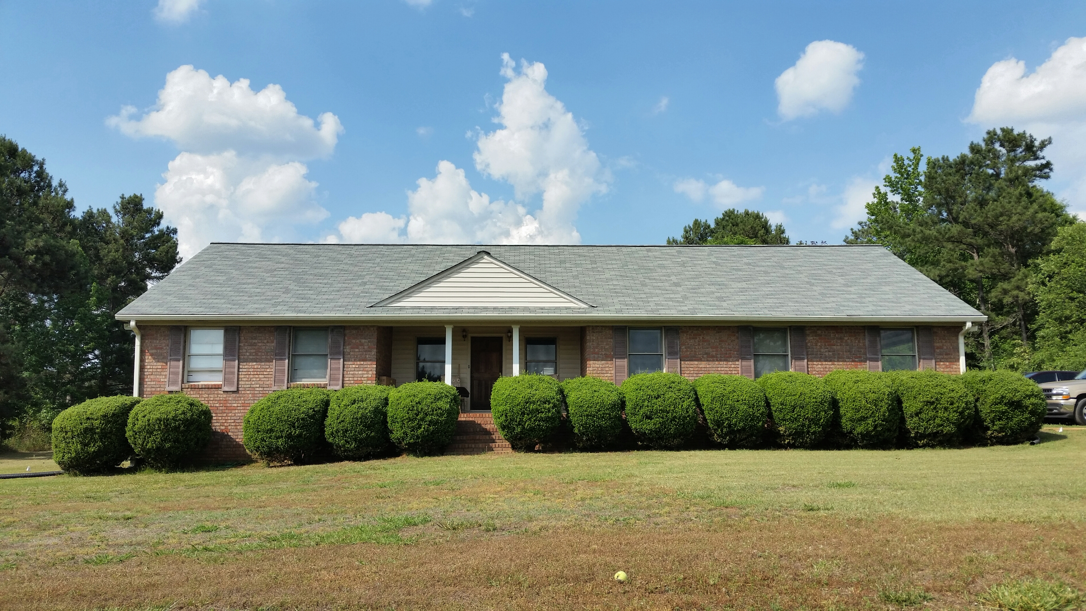

This is the before and after pictures. I had to throw in the picture of the boxwoods I removed, they were huge!

I'm surprised at how nice they turned out. Congratulations on a job well done!!!!

You're Welcome. The shutters came out really nice. I like the green color!!
On your picture of your beds, it looks like the mulch is touching your bricks. Do you have termites in your area? They love lots of mulch up against a house, it makes it easy for them to get in and impossible for anybody to see their tunnels that they build out of the ground.
   / DIY Exterior Shutters (picture heavy thread)
You're Welcome. The shutters came out really nice. I like the green color!! On your picture of your beds, it looks like the mulch is touching your bricks. Do you have termites in your area? They love lots of mulch up against a house, it makes it easy for them to get in and impossible for anybody to see their tunnels that they build out of the ground.
Ouch! Yeah, we had a small amount of termites in the barn as per the inspection for the purchase contract. That is taken care of. How far would I need to pull back the pine nuggets to be Safe? Those pests can get past the brick to the 2x4s? Thanks again!
