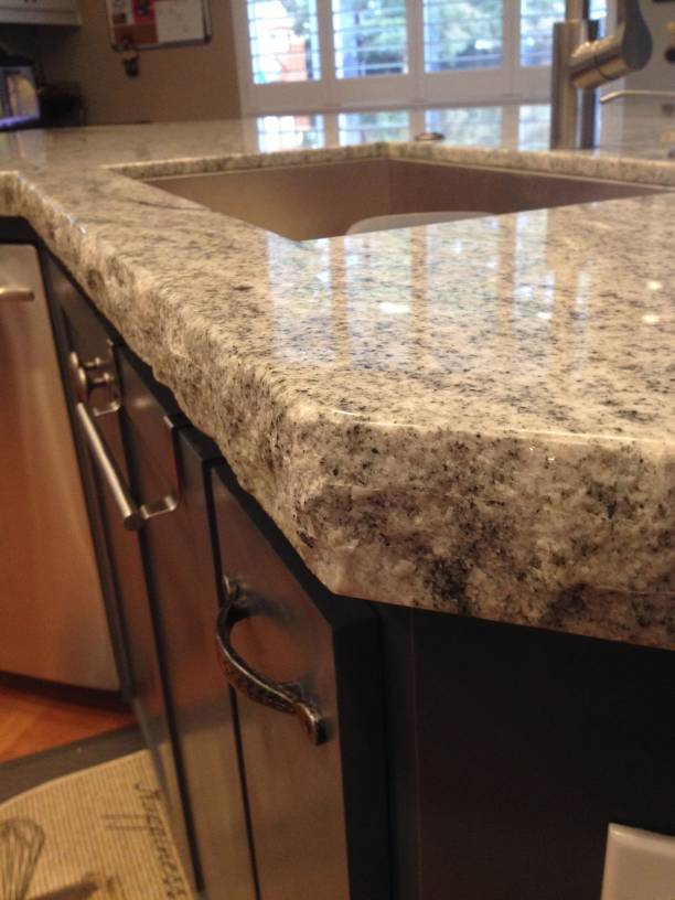

A "live edge" would eliminate some polishing. 93727c2a81b80370f9398fc944194b18.jpeg

I have some friends whom just built a $400K home with the live edge counter tops.
The live edge seems like a cleaning nightmare and even worse for sanitation.
/ DIY Granite countertop? #20
I don't care for that look in a finished house. Maybe a rustic cabin-type home, though. :thumbsup:
