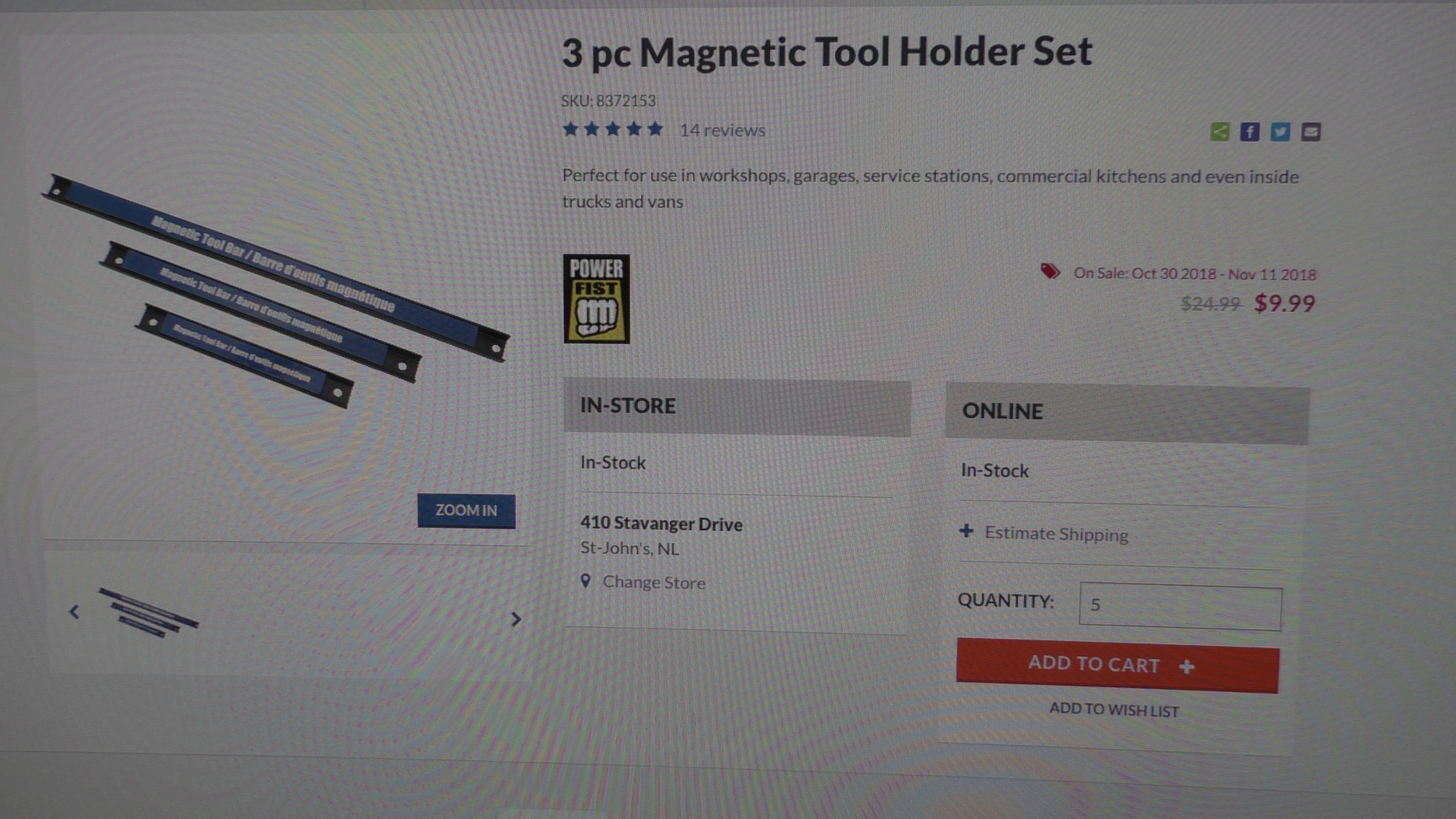

Princess Auto had the tool holding magnets on sale when I was working on the project so was fairly cheap for me.
