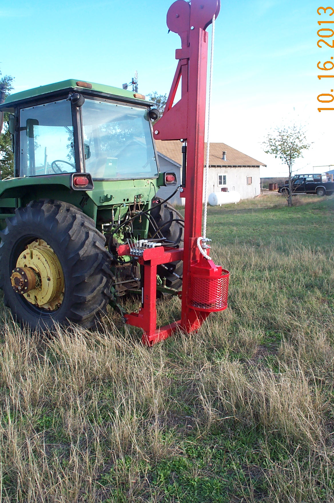

Hey if you've made you own Post Driver can you post pictures of it? I am thinking of making one (project after next) and want to get some ideas.
I'm going to make it cheap so if you have one with gold plated bits and pieces then still post it so I can rip off the clever ideas.
Cheers...

No I'm thinking of a really heavy weight that whacks posts into the ground driven by a tractor.
Something like this one but simpler and less costly.

A lot of guys around here have tubes built to fit on their backhoes in place of the bucket. set post in 2ft long tube,push down until post stands alone then whack it in the rest of the way. build the tubes out of the thickest steel you can get, buddies is 2" thick and about a 10 or 11" hole.
   / DIY Post driver. #5
I havent seen a home built hydraulic one but I have seen one that was made from a car axle with a pair of master clinders to lock one drum and then one to slow and stop a spool. the input shaf was adapted to take a pto shaft then it hd a verticle mast about 12 feet tall out of 3 inch channel that had a 500 pound wieght slide up an down inside. They used it on a barg to drive 6inch diameter spud poles 10 feet into the hard chert river bottoms. My friend has it apart now they took it off the barge but hes now readapted it to go back on his tractor. William likes it better than a post digger as they is no hole to backfill and its ability to hoist the taller posts and other items . Hes even used it to break concrete foundations 6 inches thick.

Taylor,
I don't quite follow your description but it reminds me of a home made well driver I saw about 25 yrs ago. I think it may be a less sophisticated version of your description.
He took an old rear axle/differential assembly with an empty rim still attached to one drum. For Stephan's use it would be mounted behind the tractor, parallel to the tractor's rear axle, with the drive shaft connected to the PTO.
He mounted a tall mast with a sliding weight to the old axle .
A heavy rope was tied to the weight, routed up over the top of the mast, down to the rim, and wrapped around the rim once or twice. The rope wrapped around the rim served as the clutch.
In use, the PTO ran continuously, and therefore, so did the rim. When the rope wraps were loose, the lift mechanism was in neutral. When you pulled on the loose end of the rope, the wraps tightened on the rim, causing the rotating rim to wind up rope and raise the weight. When the weight was high enough, you let go of the rope, the rope loses it grip on the rim, and the weight drops.
I didn't get to see this actually run. It was sitting in my neighbor's yard one night and I surmised how it worked. But as I type this, I'm wondering if you lifted the weight high and there were many wraps, if the "clutch" would release reliably. If not, your only choice would be to run like hell. He may have used a heavy weight and low lift height to minimize the number of wraps. Or maybe used some lubricant on the rope.
I don't know who came up with this concept but it supports my belief that some of the best engineers never set foot in a college classroom. Lets see.... "Design and build a machine to vertically transfer 500 ft-lb of energy 6 times/minute. Don't spend more than $50 and, oh, have it by Thursday."

When I first read this thread my thoughts went back to pictures of pier (pile) drivers of the nineteenth century. Weight was lifted up and then dropped.
It could be something as simple as a hydraulic cylinder that lifts a rod. The rod has a catch that picks up the weight. When the cylinder hits maximum a lever engages and releases the weight. Cylinder is brought back to the bottom where it catches the weight and we start all over again.
The capstan (rope and wheel) system could be used too. Anything that will engage, and then disengage, and let gravity do the dirty work.

Thats the same ype of set up my friend uses but instead of the capstan style he uses one side of the differential to act like a friction clutch on a crane. when the brake is locked on the side without the drum it causes the drum to wind up. when the brake is released the weight slides back down to hold the weight the brakes on the drum side are locked. once the post is set in the frame plumb you can run it from the seat of the tractor. In clay it takes about 10 strikes to drive a six inch pipe a foot. We are now thinking of taking an old transmisson and some industrial planer blades and making a post sharpener for the tractor to do some fencing.
   / DIY Post driver. #9
I too am considering building a driver. I need to drive some piling for footings. Here in Alaska you have to put them in the ground a ways so the freeze doesn't lift them. I was thinking of a folding unit so I could lay it down with a pivot so it would be able to move. Stand it up and pin it. Use a belt system and an idler pulley to tighten to lift and release to drop. with a small pulley on the driveshaft and a larger one connected to a cable drum with a locking lug to hold it while putting a post in. With this I hope to be able to drive longer pipe.
