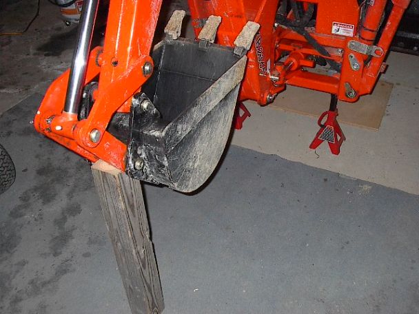

<font color="blue"> Should you not put blocks under the bh to keep it up to make re-attachment easier? </font>
I use a hydraulic car jack to relieve pressure on the pins and then separate the BH from the tractor. Then I use jack stands and a piece of 4x4 to rest it on after separation. (See attachment.)

   / DK 35 Backhoe removal #9
How about the stability of the parked BH unit. I've got little ones that, like their mom, seem to get into everything. Will they knock it over? I need to have the BH secure to prevent an injury.
   / DK 35 Backhoe removal #10
It's pretty stable. I wouldn't leave the little ones unattended around it though as there is always the possibility of something happening.
