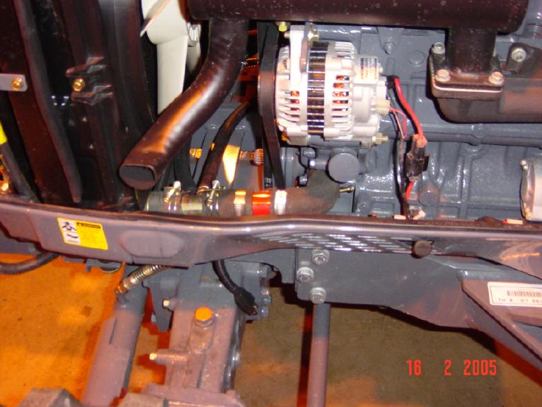

I have a DK35 and need a block heater. One of the other posts said that Daedong reads these posts....... if so please tell us where to get one. I don't mind if I need to get it from Kioti or not. Yes I keep seeing "put in a lower radiator hose heater." They just are not the same.

My 35 has a "lower hose heater" aand I have used it twice in 2 years at -20F in an open shed in NY with no hassle. bcs
   / DK 35 Block Heater #3
Where did you buy it and how is it installed? Gerard

I know you don't want to hear about radiator hose heaters, but, I have to tell you that I put one in my LK2554 and in a matter of about an hour @0deg F. It will warm up the radiator and engine block so that they are warm to the touch and it will hold them there for as long as you want.
   / DK 35 Block Heater #7
</font><font color="blue" class="small">( Where did you buy it and how is it installed? Gerard )</font>
here's a pic
it's the red thing that's inline in the lower radiator hose

Thanks for the photo. Makes it a whole lot easier to see the application. Gerard
   / DK 35 Block Heater #9
You are correct....they aren't the same. A lower rad hose heater will heat everything much more evenly, alot larger area and they don't take that long to install. /forums/images/graemlins/grin.gif
