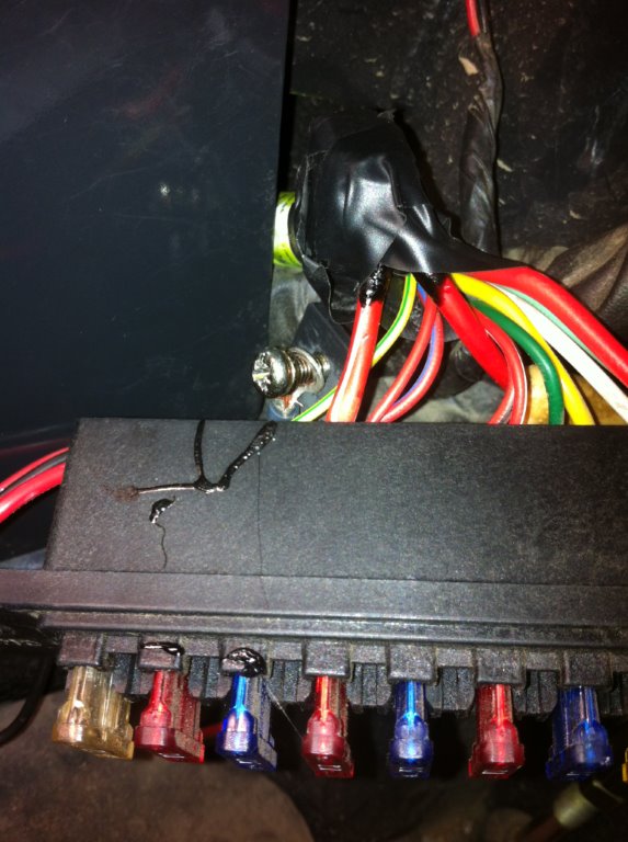

Here are a few of the install of the auxiliary terminal block, how it's tapped into the existing fuse-box and the location of the wire passing power from the factory fuse-box to the aux terminal block, located just below the passenger side hinge for the below hood gray side panel.
The above pic shows the factory fuse block with a 10ga red wire 'tapped', (by Scotch Lock) onto the factory red'feed' wire, which is HOT when the ignition is ON.
(The factory hot feed goes to the fourth from the bottom fuse terminal on the back of that fuse location).

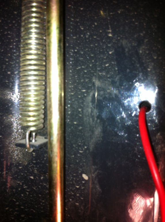

This new 10ga wire then passes through the firewall panels into the engine compartment in the second pic below.

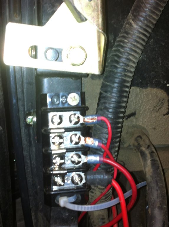

Above the new wire which feeds from the factory fuse-box passes into the engine compartment and then attaches to the aux terminal block.
This above pic shows where the aux terminal block attaches at top, just below the bolt which holds the brass colored side panel hinge, and at the bottom via a cable tie. Be careful to route the new hot feed to the block away from any place the wire might chafe or bind. If necessary use a sheath to keep the wire from damage.
Note: the aux terminal block is ALL HOT. Each screw has a jumper on the left side connecting it to the screw below, thus energizing the entire block via any screw post on the right side. My hot 'in' is the wire covered in black shrink wrap, the largest wire shown.

Get a grommet on that wire going thru the sheet metal asap.
Did you fuse your new fuse panel ?
Thanks. Job is not complete, yet. New terminal block is fused in each downstream wiring harness for the lights. AND the factory hot feed wire has an inline fuse holder at the scotch lock with a 30 amp fuse to protect the downstream wiring and lights.
