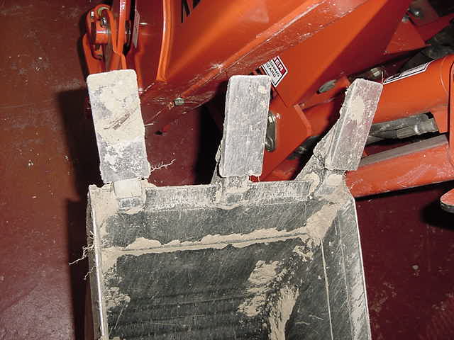

It all depends on how well you can operate the sticks. I think the 3054 can dig real well, It also depends on which hoe, bucket size for what dirt,and even to what hydro fluid & speed your digging at.
Alot of the Kioti hoes are shipped with 10-30 motor oil in them, you'll gain speed & power with sudt. Was the machine weighted. I really like the DK35s.
But it all goes back to. Ground type ,bucket size and the weight of the machine. Don't think you'll keep pulling full buckets up & out like a Ind Hoe.
Danny
