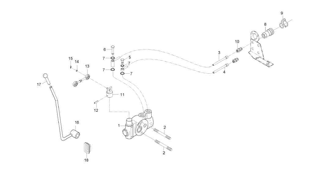

The Kioti carton included everything except for instructions. I believe I can figure out how to install the valve, but a little guidance goes a long way. I assume the right rear tire has to come off to get to the small access panel in the fender?
Maybe Mr. Wallace can shed some light on this or possibly even e-mail or post the instructions?
Thanks, BigGuy
   / DK 45 remote hydraulics kit #7
Hi
Whenever we add rear remotes we just remove the seatand the plate it is mounted on. This gives a wide open (top view) of your valve assembly. The work involved varies from tractor to tractor, but it is not too complicated. Your dealer should be able to get you a diagram. If not, let one of the dealersknow and we will get one to you.
KiotiDave
   / DK 45 remote hydraulics kit #8
Let me know if you need more than this?

Hi Dave and Rick,
thanks for the replies. I printed the diagram, that should be all I need. Good tip with removing the seat, I need to work on that anyway (guess they are not made for big guys).
I'll let you know how I made out when I am done.
BigGuy
Hello,
Well, I've managed to install the valve kit over the weekend. Not too difficult, however getting the threaded stems out was a project. Removing the access panel on the inside of the right rear fender helped to get a socket onto the nuts, but these stems were pretty tight. (I put two nuts on the stems and looked them togheter, this allowed me to back the stems out.)
Everything seems tight and works fine, thanks again for the help.
