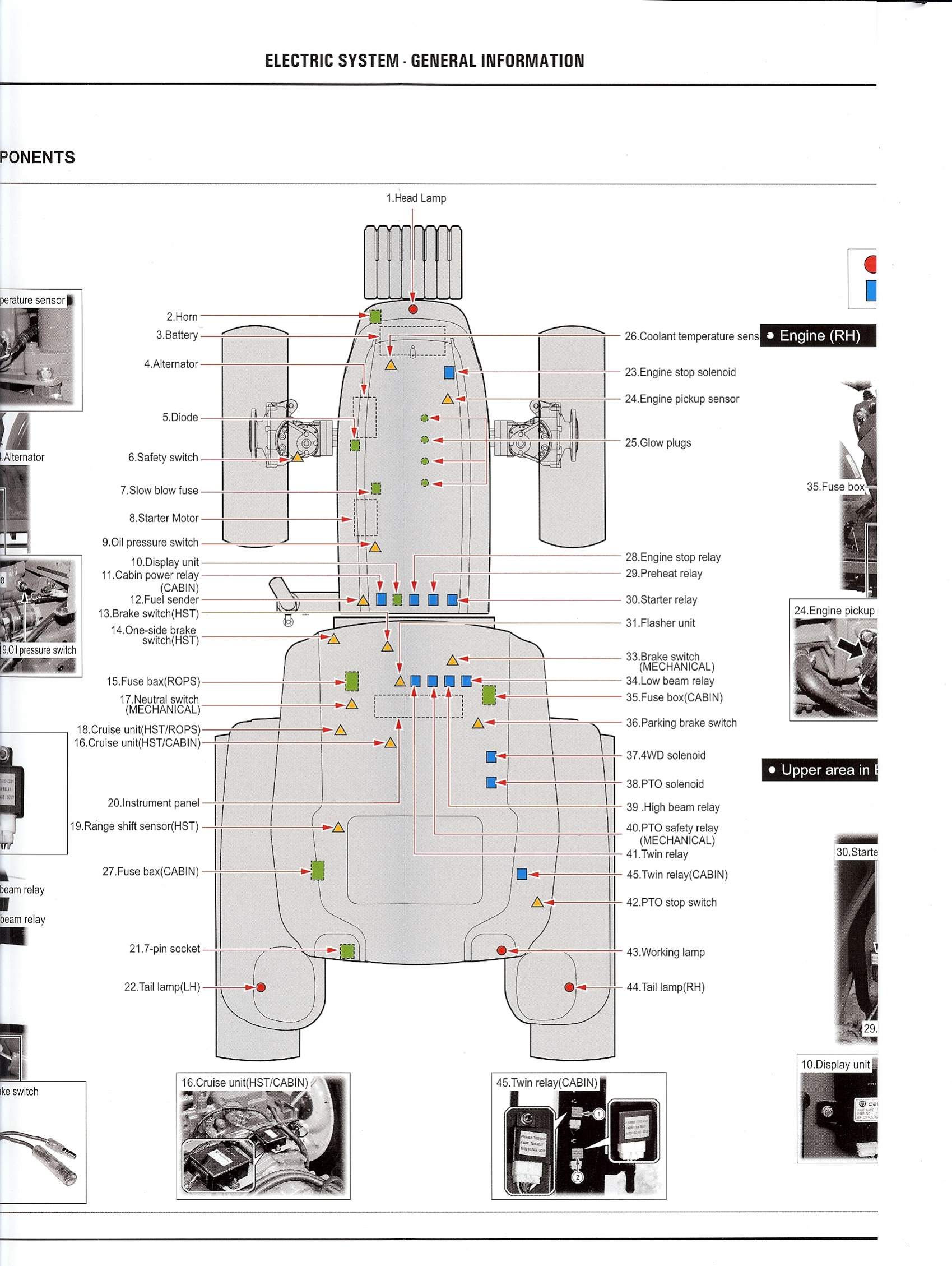

Sounds like a loose connection either at sending unit or gauge connection, I would check sending unit first, remoce wire and reinstall, if that don't do it check under dash where it connects to back of gauge.
Enclosed layout of sensors attached, #26 is where your sending unit is located.
Good Luck

HMMM. and what would safety switch # 6 be?
