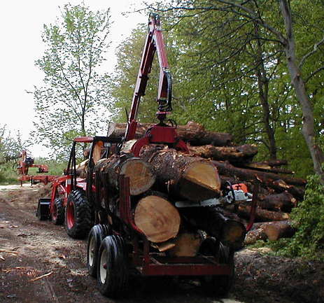

here is a load of pine that the kioti and the stihl had no problem with.
