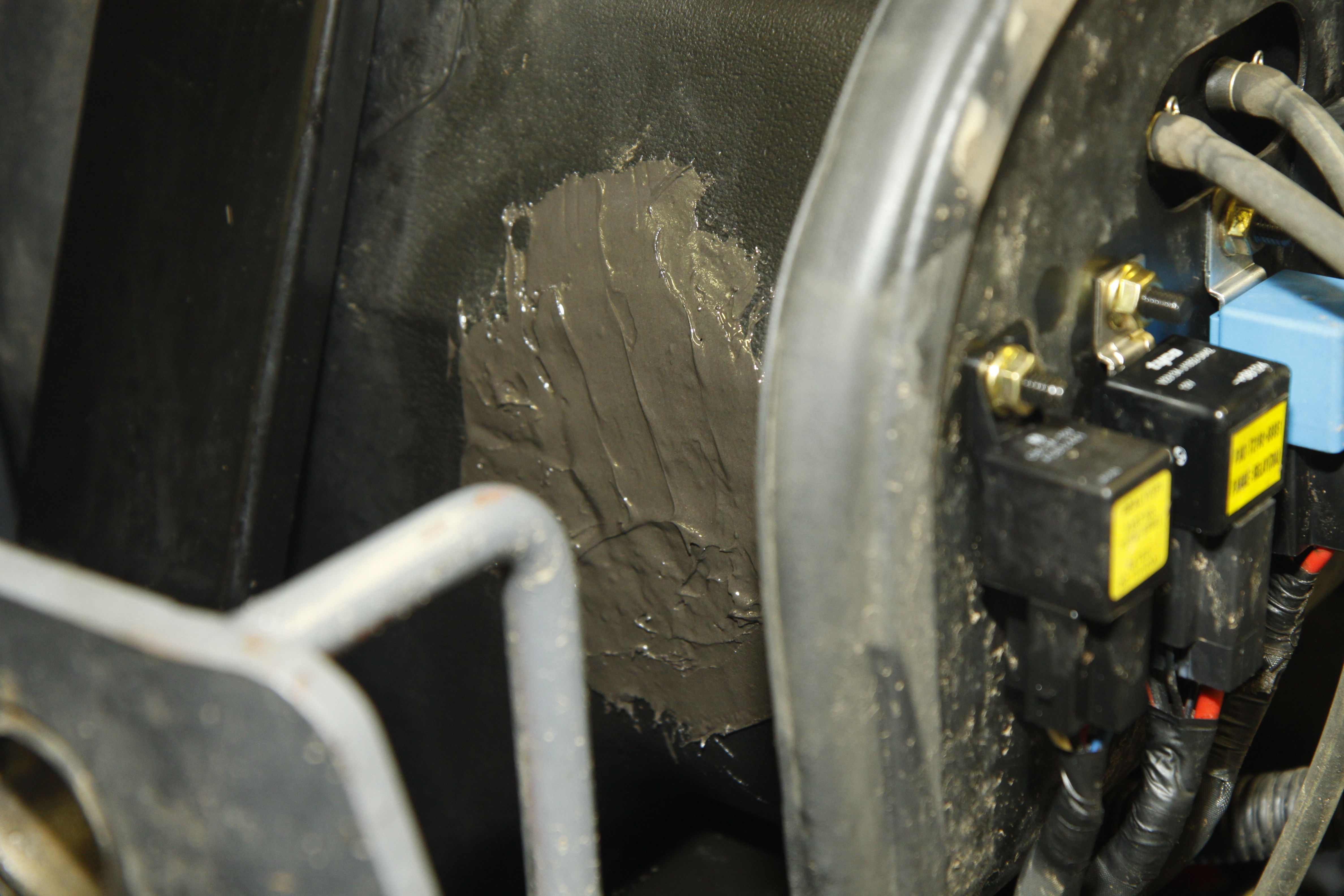

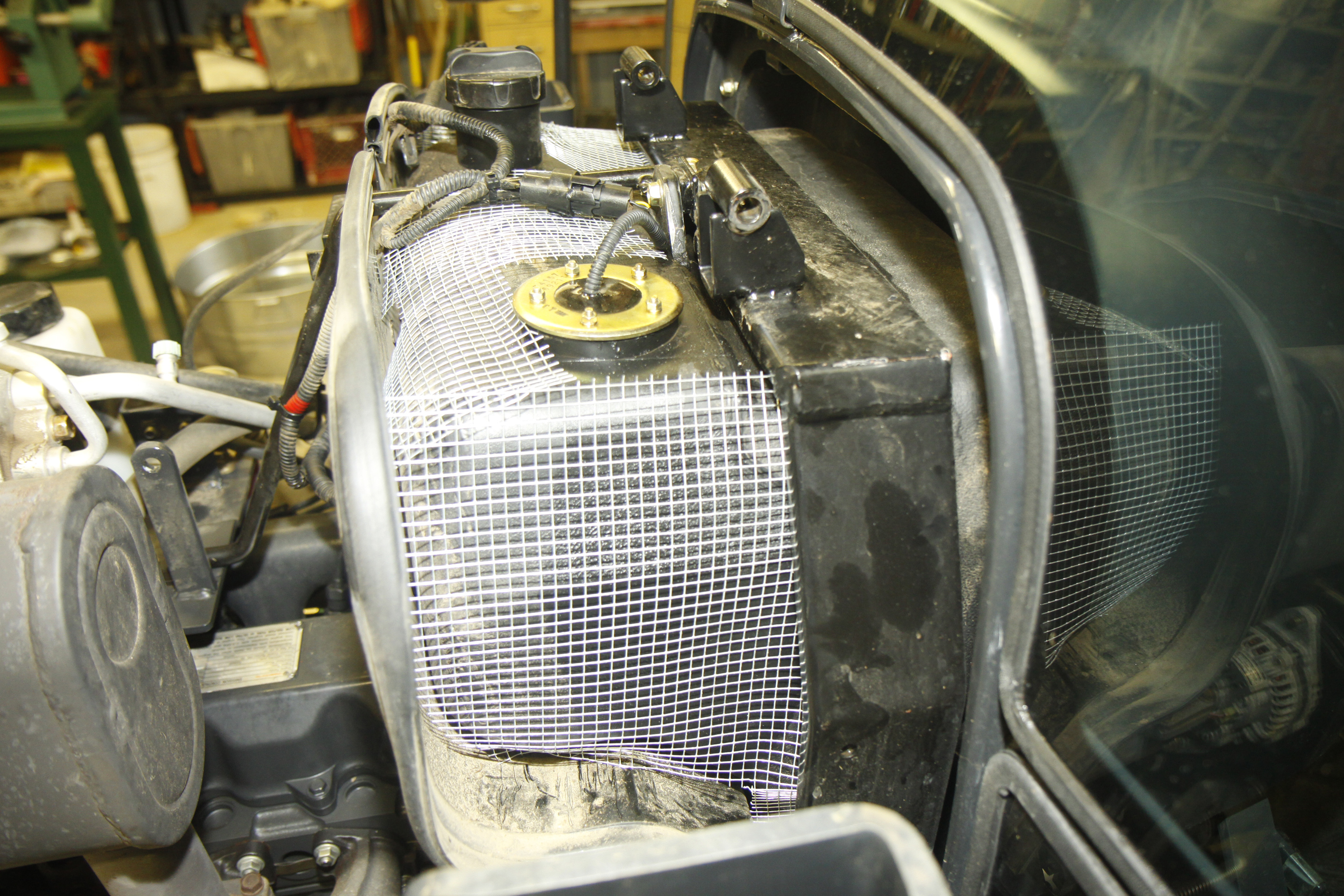

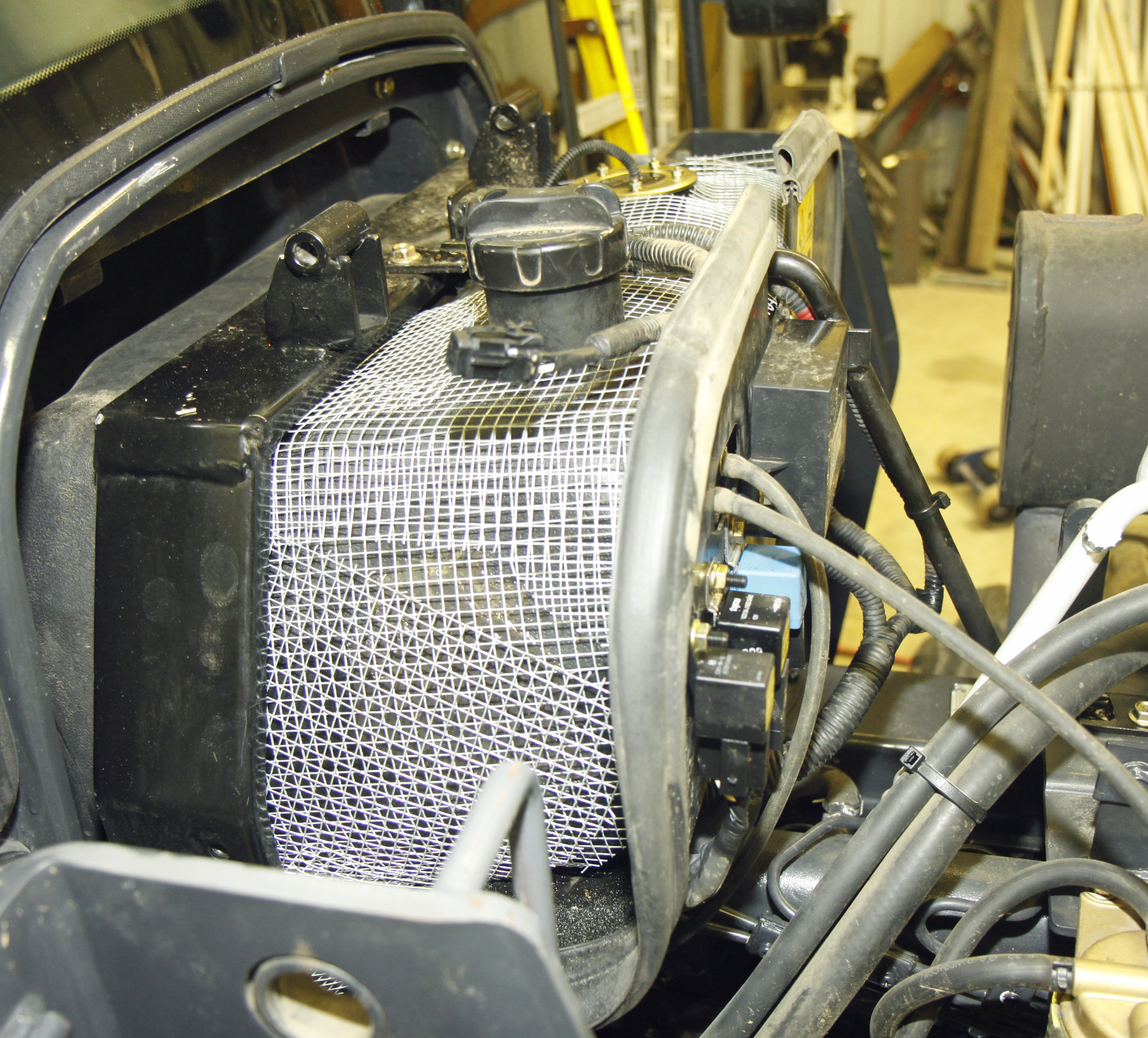

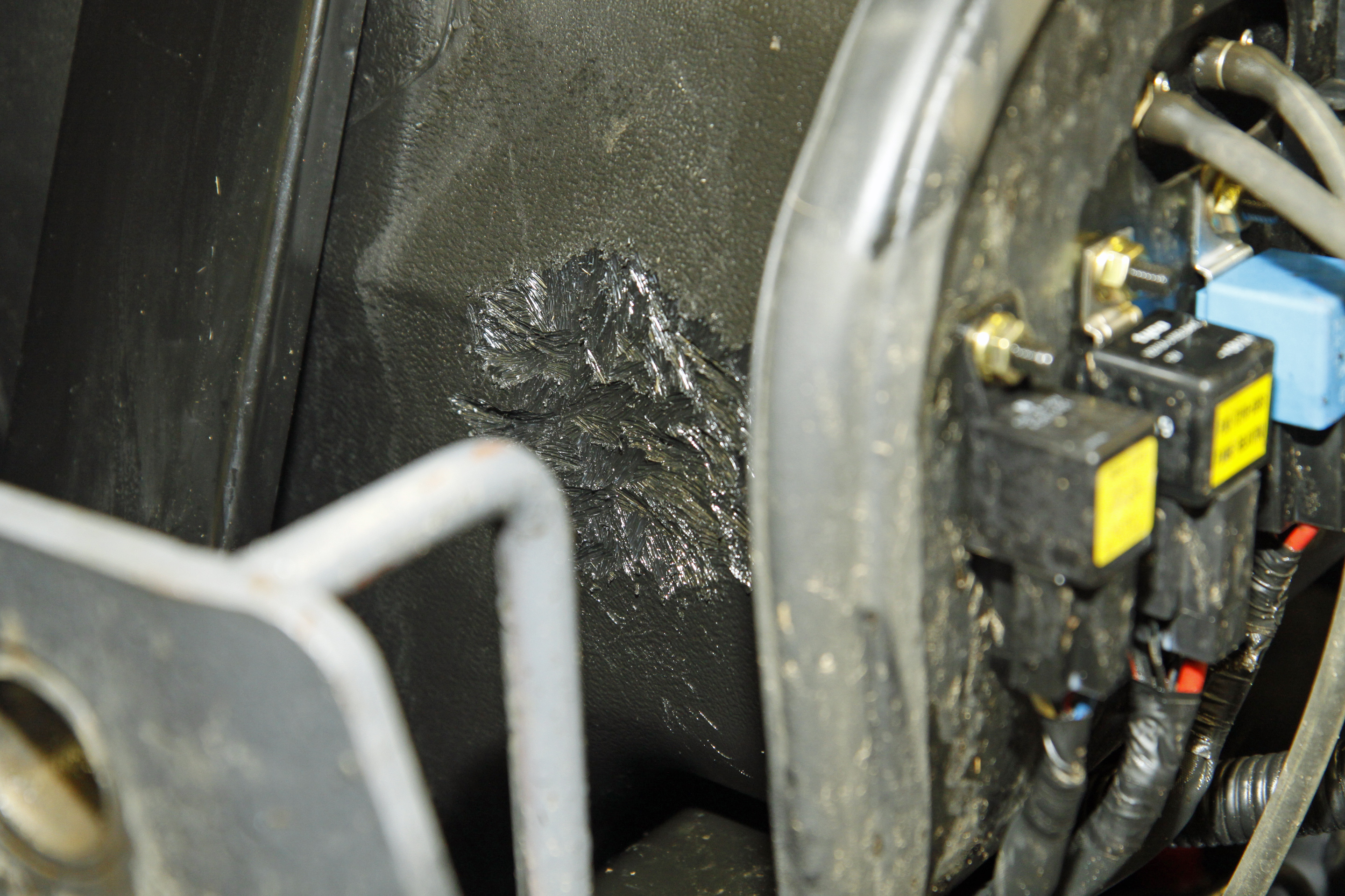

I had a leak in my dk45 fuel tank about 9 years ago. Turns out some kind of rodent chewed a nasty hole in tank. You could see the teeth marks. I ordered a new tank, but while waiting for it to arrive i repaired hole with JB Weld. Then i relined the entire fuel tank with 1/4” mesh wire to protect it. Ended up with new tank still in box on shelf and patch has held for 9 years. No further damage either.

at least mine was pretty obvious what happened. rat chew 2.jpg my 8 year old temporary repair _MG_6568.JPG then the cage mesh 5.jpg. mesh 4.jpg after looking at pictures, i noticed that this happened in 2012.
