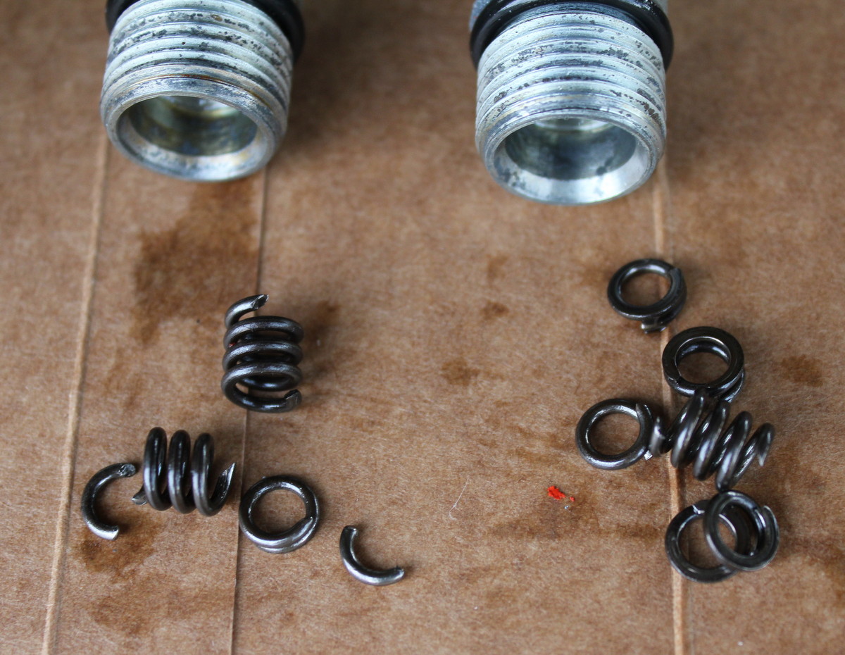

2008 DK 55 with 389hrs.
While brush hogging yesterday (old field) without warning the tractor just shut down with no warning whatsoever. I had been having trouble starting the tractor for the last month or so after I replaced an injector with a broken spring. I attributed it to a small leak somewhere allowing air into the fuel lines. It would be fine for 7 days or so but if I left it any longer It would take a long time to fire up. After it started it ran great. I immediately went after the injectors thinking I had another broken spring, not the case.

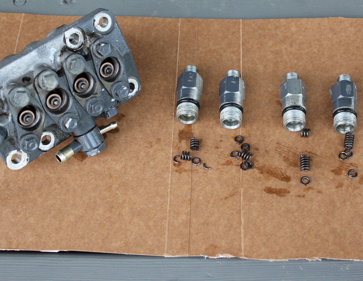

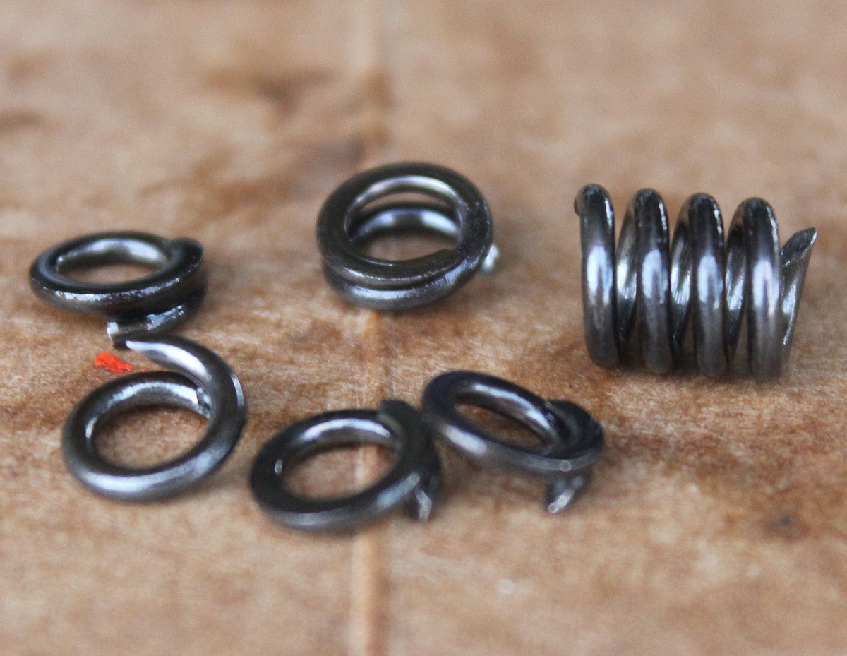

Reading through posts here I found the one with the injector gear failure so I disassembled the IP and the gears were all fine :confused2:. After removing the tops all I found were piles of broken springs??? Has anyone had this happen ever? 1 broken spring I could see but all 4???

Amazing. All four! IMO this smacks of defective parts.
Those are the delivery valve springs. Their main function is to act as a check valve for the pump but also to suck a little fuel back into the pump to depressurize the line to the injector. This reduces the chance of the injector dripping between squirts.

Just to update this thread, Injector pumps/Fuel System are not covered under warranty so I have shelled out $1490 For a new pump. I attempted to have the pump rebuilt and the unit was returned with a note."No service available-cannot buy parts/replacement parts at this time. Manufacturer holds exclusive rights to this unit" Pump is Zexel. I am angry now and I will wait a few weeks to collect my thoughts but I feel certain that I will send this one down the road and never buy a Kioti again.

I have not worked on a Diesel injection pump before, but I would try to substitute other springs
to fix that unit. Too bad no FI shop wants to fix it.
Since no spares are sold new, your old pump has lots of value for its parts; don't toss it out.

hello sorry about your problems , but when i got the new pump i would take one of the springs out and measure it and check the resistance and then find some new spings even if you have to use shims , or you could just change springs
and the new one back :cool2: but i did not say that
