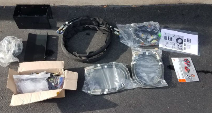

Another thought. When you say "factory third function" I'm assuming you mean the third function kit that Kioti first introduced two or three years ago. I've not seen one on an NX, but if it would install the same way as on the CK and DK models, be aware that you will lose your right-side step! That for me would be a non-starter. There are times when a right-side step is very nice to have. If you do end up having the dealer do the install, be sure to get the step back from them, as it's an expensive part. I paid $105 for one in 2018 to put on my CK3510SE HST, which does not come with one.

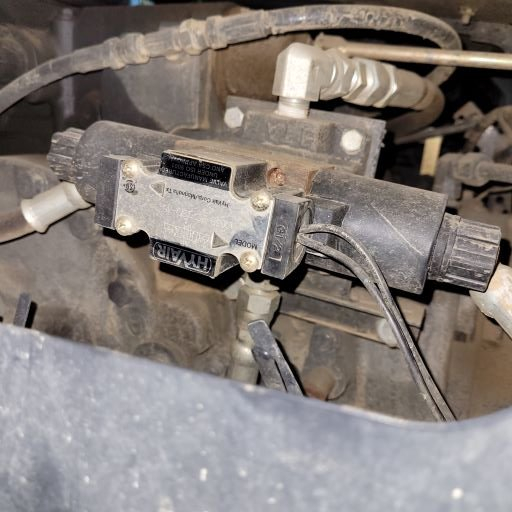

Instead of the Kioti kit, you might want to look into one that mounts the double solenoid valve unit up underneath the tractor, aft of the joystick valve. The one I have on my NX4510HST cab is the HyVair model D03. Installed by my dealer, it tucks up out of the way near the transmission. See attached pic. I've been very happy with it for eight years.
There are a number of other good third function manufacturers. I have the W.R. Long double solenoid kit on my CK, and it mounts to the right-side loader post, so it was still possible to add the right-side step. I don't see any obvious way to mount it that way on the NX series, but you could ask. Also, you might want to call Michigan Iron & Equipment and speak with the owner, Bob Piro, about options. MIE is a very well-regarded Kioti dealer and great resource. In addition to the Kioti kit, they have their own in-house third function kit for the NX series that they've offered for years, before Kioti rolled out its own. I don't know how it mounts, but it's worth at least a call to Bob.

Hi Threepoint, there is an elusive factory 3rd function kit for NX, P/N: NXA127. I only came across it while looking for tractors on Facebook Marketplace. No idea if Kioti rebranded someone else's kit, or made one in house (they do sell NX's globally), but I am hoping it would be well integrated. I will definitely give MIE a call to see if they know anything about this factory kit vs. MIE's.
While I think I am mechanically inclined, the thought of draining Rim Guard then trying to put it back absolutely stomps my brain. That's why I was wondering if I could possibly remove/re-install a ballasted tire/wheel using one of these wheel dolly/jack. Harbor Freight's is rated at 5200 lbs and the rollers would allow wheel to rotate/line up for re-installation.

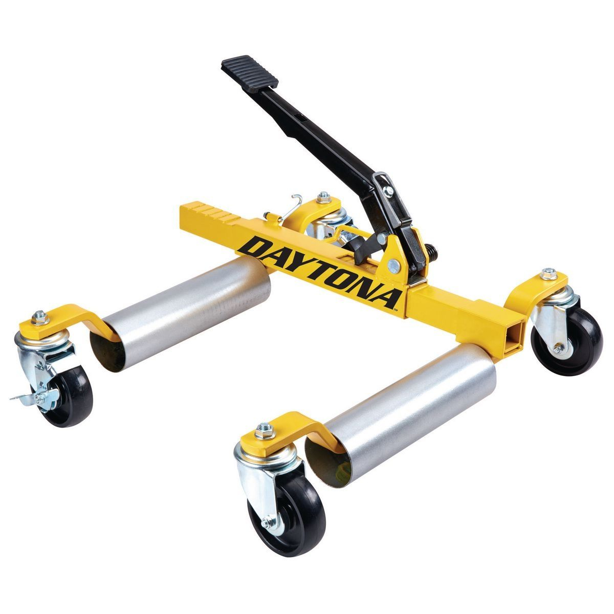

I don't think that HF wheel dolly would handle your R4 rear tires, since its max tire width is 11". Maybe someone with R4s on their NX can post the width. I have R3s on mine, and they are 20", sidewall to sidewall. The R4s are narrower, but I doubt by 9".

And Threepoint after seeing how small HF wheel dolly is, and how big a tractor wheel lift (amazing what's on Youtube) is, I can definitely see a laughable size difference. I guess it's like shooting BB's at a bear, it may get the job done but not before the bear gets me first.
Then of course I gone through TractorByNet forum and checked out various hacks. Most promising one being the use of engine hoist + strap to get the loaded tire in/out. Or a forklift with strap. Not sure if fender removal is needed so when I get my NX home today I will see if there is enough room to stick the boom of an engine hoist (or fork) above the tire/below fender.

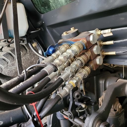

As Midniteoyl says, not cheap. But, even after replacing the door you'll still be within your original budget! And the tractor is quite usable in the meantime. You don't even need to defer your hydraulic pimping. (Hey, I'm looking for the good news here!).
Speaking of hydraulics, one nice feature of the NX series (different from the DK you were first considering), is the ability to have up to three rear factory remotes without having to go to a custom diverter solution. You already have one set of rear remotes, so you have room for two more. Now's the time to do it. That will allow you to use two for a top n' tilt system (hydraulic top and side links). Then you'll have a third set to operate something else, e.g. a wood splitter, etc. I'm using mine at the moment for a hydraulic cylinder on a rear blade to mechanize its offset function. I just replaced the mechanical swing link with a Grizzly cylinder. Very nice to have when you're doing light ditching, or grooming the shoulders of a gravel drive and want to sweep stone back to the center.
When the NX series first rolled out in North America, Kioti listed only two rear remotes as an option. That may have changed by now, but, regardless, a third rear valve body and cable kit is available through your local dealer or MIE. It is actually the same as the No. 2 (second) remote kit, so you would just need to order two No. 2 remote kits. The third valve body bolts right up to the other two, so requires slightly longer, hardened bolts, 8.8 or better (available at Fastenall, etc.) Plus another o-ring, of course. As you've probably already noticed, your NX has a third, empty slot on the right-side console for a third remote lever.
Props to our fellow member Minnesota Eric who first alerted me and others back in 2014 that this is possible, along with how-to instructions! https://www.tractorbynet.com/forums/threads/nx-options-or-lack-thereof.327357/page-3 (see post 23)

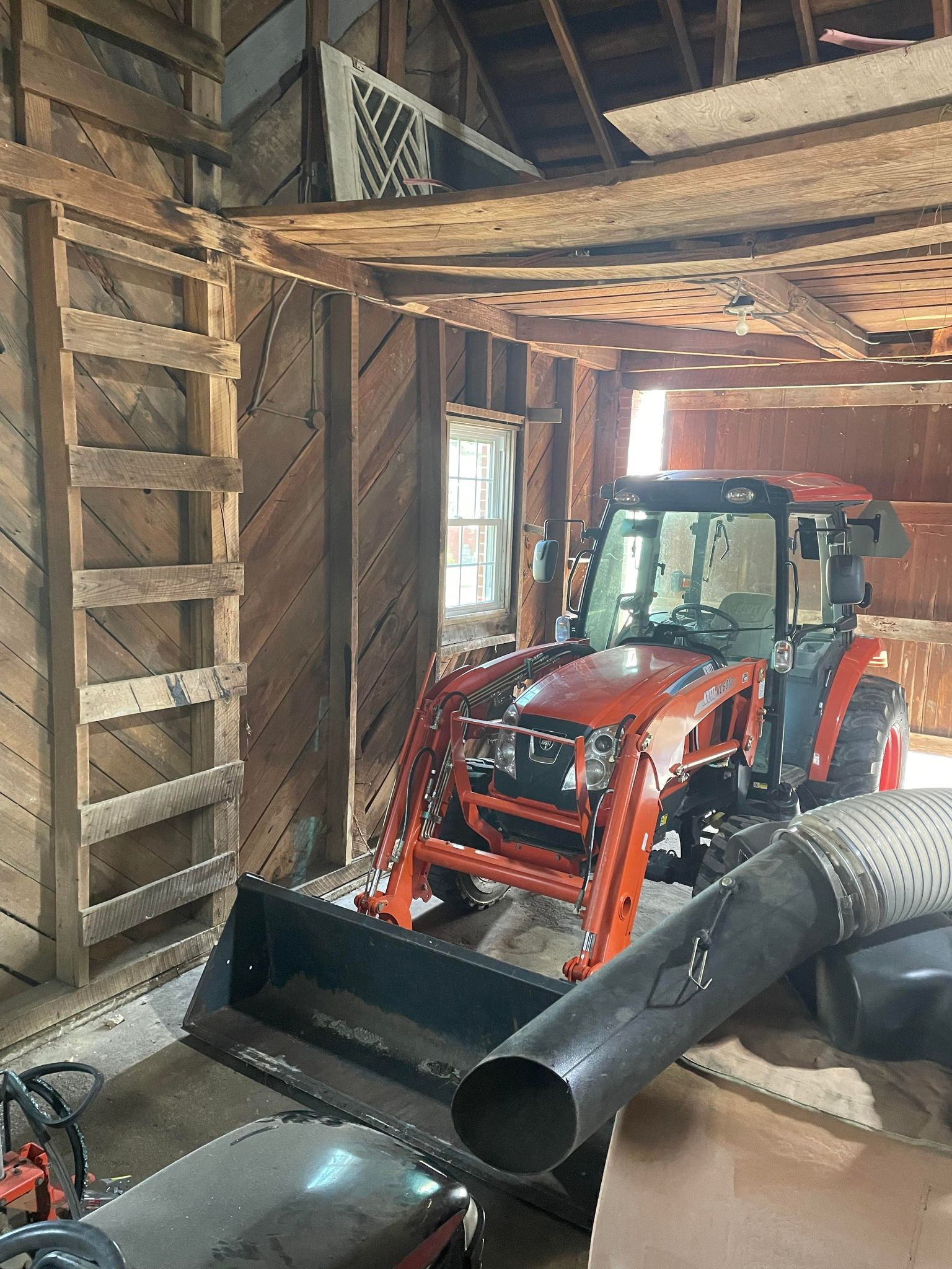

Quick update on door. Just glass is $470, door handle/latch is $250 (blew off with rest of shattered glass), and door assembly $1150 + shipping. Kioti has no lead time on glass or door assembly, door handle is available, and parts lead time still isn't good (according to both dealers I inquired with). There are several online tractor glass sellers but Kioti is not a brand they carry.
The tow shop that transported supposedly have insurance covering damages in transit but I have not heard back from them. And not sure if any of my USAA policies would cover this, but I plan to see if hinges, handles and door closing piston are re-usable, and then fabricate a piece of 3/16 - 1/4" Acrylic or Polycarbonate door glass (using the right side door and gasket from the broken door as template).
Until then, I will park it inside (something about tractor in old barn that just looks good together).
