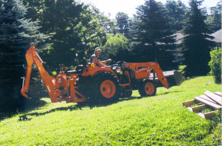

I run a Rhino 85 backhoe(same hoe as the 2085) on my DK 35, but haven't used it many hours yet.
No problems so far.
When I purchased my DK a couple years ago the 2085 was listed as a backhoe option, it has since been changed and the 8 1/2 foot backhoe is no longer listed on the kioti site as and option for the DK 35. Why???

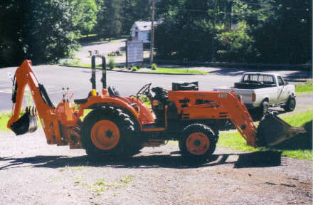

Another photo of the Rhino 85
