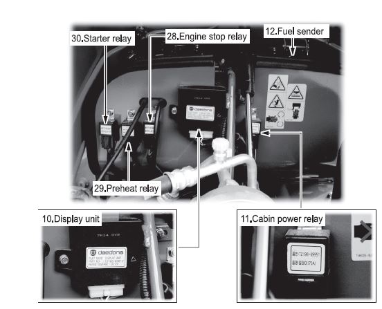

Do you know what the other two that are the left and right of the glow plug relay?

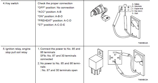

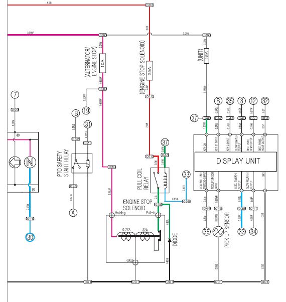

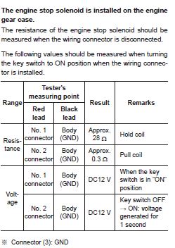

Yep, the one on the left is the starter solenoid relay, and the one on the right is the Fuel shutoff solenoid pull coil relay. The fuel shutoff solenoid ( engine stop solenoid)has 2 coils the pull coil that energizes for 1 second under control of that far right relay, which in turn is controlled by the display unit controller and the hold coil which is energized by the key bus 12 volts. So the 1 second pulse comes out of the display unit, causes the engine stop relay to energize, which in turn energizes the fuel stop solenoid and then the hold coil continues to hold that solenoid energized by the 2nd "hold" coil.
