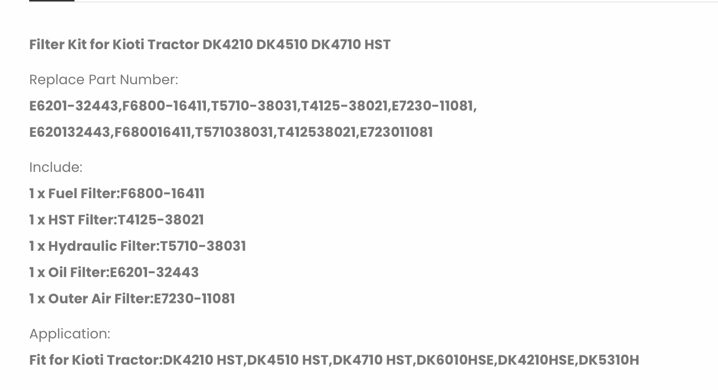

I went to my dealer to get the necessary filters/fluids for the 50 hour service. I left with three filters ... an engine oil filter, an HST filter, and a fuel filter. The maintenance chart in the owner's manual says I need to change the engine, HST, and transmission filter. I changed the engine and HST. I have not changed the fuel filter ... that's not even listed in the maintenance chart. I also don't see a separate transmission filter. Is that for non-hydrostatic transmissions?
It's confusing to say the least, especially considering the dealer told me that Kioti requires changing the hydraulic fluid at 50 hours but that seems to not be accurate any longer.
I plan on changing the fuel filter since I have one and don't see why not unless someone here knows differently.
Is there a separate transmission filter?
Any clarification appreciated.
Thanks.
   / DK4210SE HST 50 hour service filters #2
I know my dk45 has 2 hrdraulic filters. One for basic hydraulic and the other is the hst high pressure filter. Plus oil and fuel.
   / DK4210SE HST 50 hour service filters #3
Funny, i went to michiganiron site, which has great parts diagrams, but your model is not listed. I did find this other info online though. On my unit, the main hydraulic filter is mounted underneath, near rear of tractor . Its a 6” x 10” large black filter. Yours may be in similar area.
