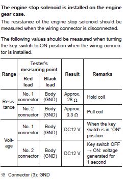

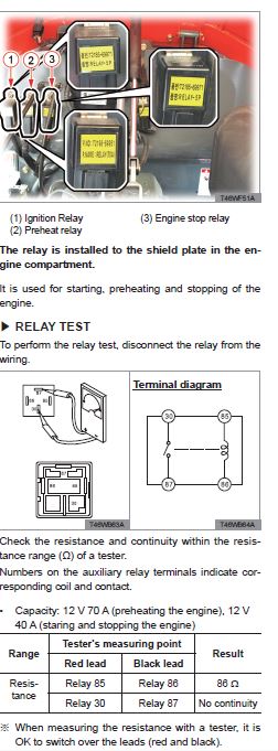

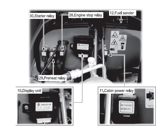

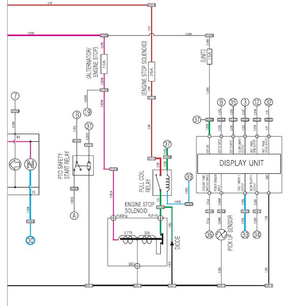

Does the fuel shut off relay that operates the fuel shut off solenoid on the injector pump work. The fuel solenoid has two coils the pull coil that is operated for 1 second by the fuel relay that pulls 28 amps of current, and then the hold coil that is run off of the key buss, that pulls less than an amp of current. These could be the problem. Do you hear the loud clack of the fuel solenoid pulling back when you turn the key on? The fuel relay is driven by a 1 second pulse from the display module. The relays are the most failure prone of all of this fuel chain of events.

Yes, fuel solenoid is working, can hear the loud clack when turning on the key. I'm thinking the issue is air in the lines, going to figure out how to prime/bleed the system and then check the lines to make sure the connections are all tight.
   / DK45 Engine troubleshoot
To my future self and anyone else who is having this issue. After turning the fuel cock to "air", and cranking the engine over for 5-10 seconds she fired up. I must have a small leak in a hose somewhere that is allowing some air into the system after it has been sitting for awhile. Moral of this story is "don't go on vacation" :laughing:
